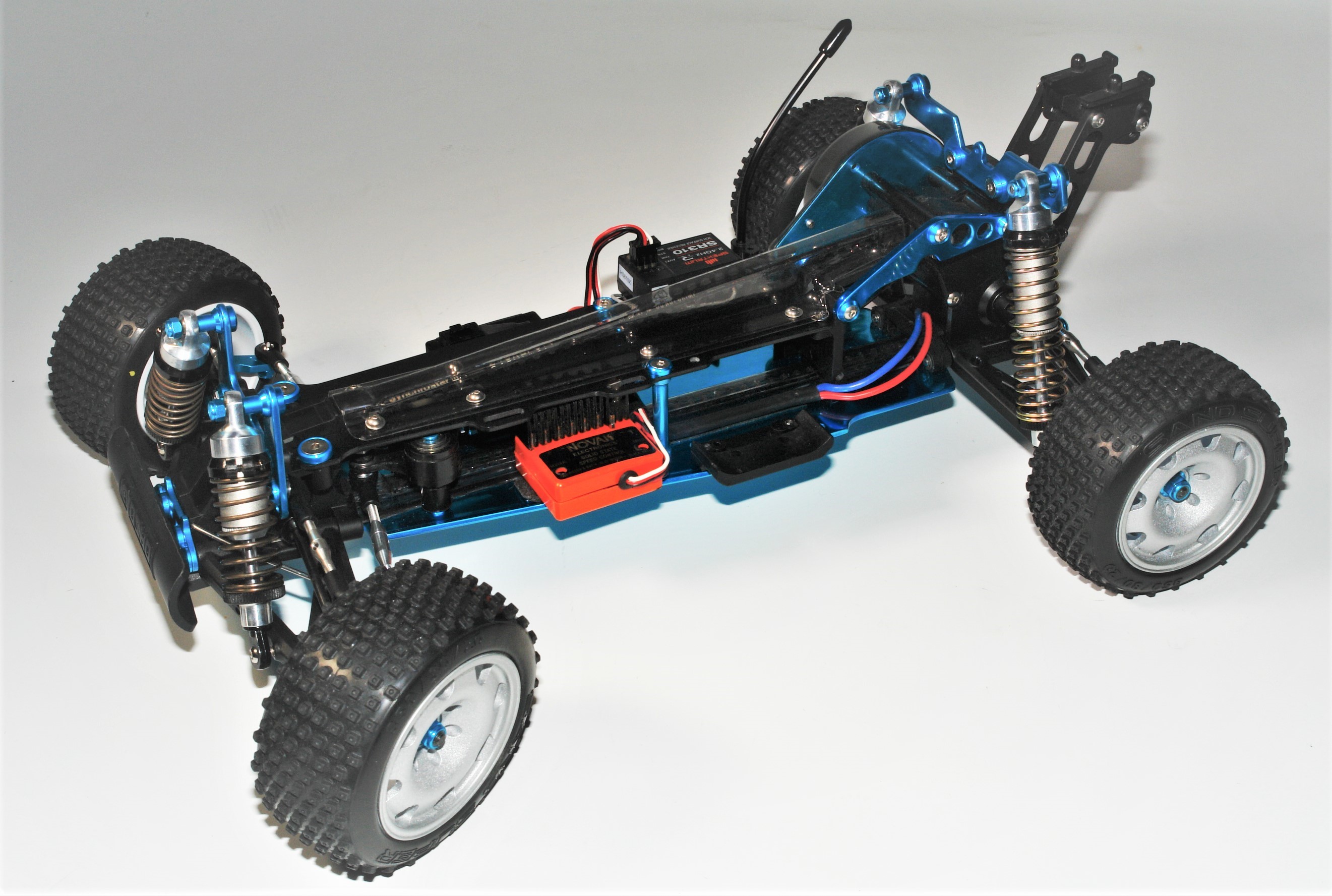

Started to place electronics.
My Novak 1 is pretty close to the correct time period, little older than the car but close enough.
It also fits fairly well and the wiring is basically headed in the correct direction.
I tried several other ESCs that I have but it was this or a Futaba MC230cr. The Futaba is better for size but 15 years newer, so the Novak.
I did opt for a new receiver because size and 2.4ghz.
I tried the Secraft turnbuckles suggested by Mwildmann.
I got both aluminum and stainless. I was half thinking to try and anodize the aluminum ones.
The raw aluminum look better and are slightly beefier in the center than the stainless but they are certainly weaker.
Some wiring to terminate, motor to install etc, etc.
Chuck

Memo to self- Always check your electronics before installing in your car!
After spending a lot of time getting the wiring trimmed, replaced, terminated and routed, I found the Novak1 was dead
So I got to install an esc twice.
I did have a super clean Novak T4 that is a slightly larger than the Novak1.
It just barely fits but you can slide a playing card between the heatsink and the upper deck.
Wire routing was the same so that was good.
Also temporarily installed the Le Mans 240st. Found out, I think, I need some oddball sized pinion. They are available on Ebay though.
Chuck

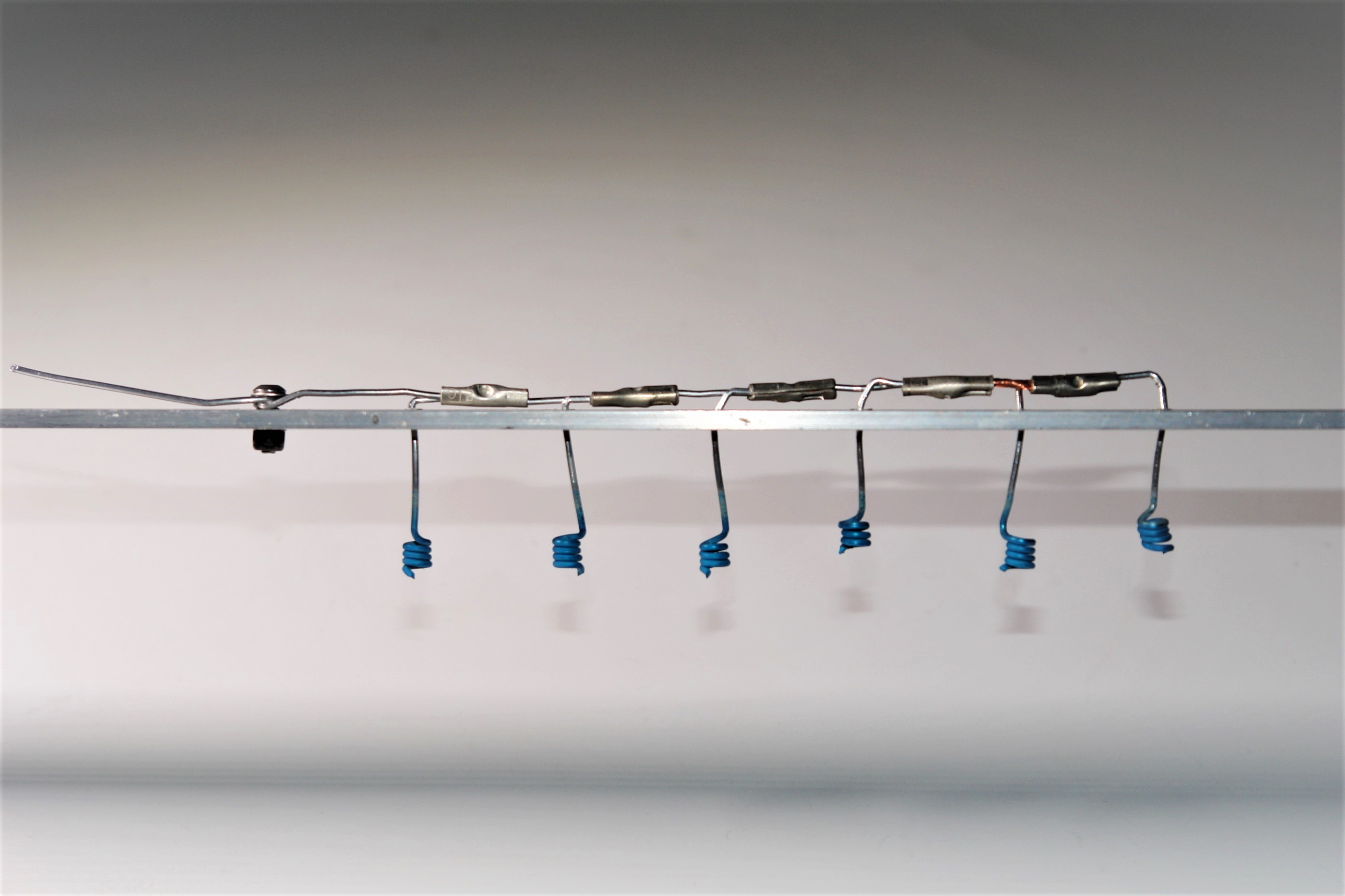

Anodizing failure
After anodizing the chassis with such good luck I thought I'd try the aluminum Secraft turnbuckles.
"I tried the Secraft turnbuckles suggested by Mwildmann.
The raw aluminum looks better and are slightly beefier in the center than the stainless but they are certainly weaker."
The color is way too light and one turnbuckle apparently had a bad connection. The motor spacer plate (on the right) is correct color, for reference.
I actually only had them in the dye for maybe 5 minutes, a short time compared to the rest of the pieces but it looked like it took the dye.
I assumed the turnbuckles were 6061 but now I think more like a 7*** series alloy containing some copper.
Guess I'll strip them and try again.
I did polish the stainless turnbuckles and they clean up very nicely.
Also included a pic of my bussbar anode to show how I attached the turnbuckles to the power supply.
Chuck

Had yet another anodizing failure yesterday. Pretty much the same outcome as the last attempt.
But today I got a little closer to a good outcome. The motor plate is the correct color and shade.
Still need at least one more attempt to get good results.
The picture doesn't really show how much lighter the turnbuckles are.
The color is fine but they are too light.
What I did find, on a European hobby store site, was a better description of the aluminum turnbuckles alloy.
It turns out it is duralumin
I hate this aluminum alloy for anodizing. It isn't even anodizing like Kyosho's interpretation of the alloy.
I did order a set of Brass knuckle bushings. They are supposed to fit better.
On my "C" hubs the bushing isn't even close to the correct size, it is too small OD.
Causes a lot of unnecessary slop in the steering, don't know if this is a common problem with the new re-re Optoma mids or not.
The parts I used are the hub carrier from OT204 and OT 212 king pin flange pipe.
Chuck

Was beginning to doubt my anodizing. So many things can go wrong.
So i grabbed a couple wing mounts and nose braces and off to polish/anodizing.
They turned out fine.
So I'm still blaming the duralumin.
Chuck
