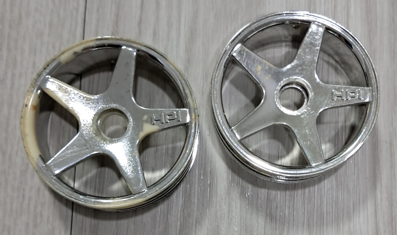

CrazyRC wrote: Tue Sep 21, 2021 11:00 pm These are the wheels. I soaked them in dollar store bleach for a few hours, and gave them a quick wipe down with a rag. No scrubbing involved.
It's an old trick I learned building static model kits.
Yours turned out nice. Soaked mine in the bleach for a few hours, twice. But they're a weird yellowish color and white. And the remaining chrome on the inside of the tire will not come off, only the front wheels. Rear wheels all the chrome came right off. See pics.
-Jerry-

That yellowish stuff is the lacquer paint used before the plating. Weird how more came off on mine than yours. I found that soaking them in full strength Simple Green does a pretty good job of removing it. It will jelly up a bit. I guess the chrome on mine was in worse shape than the chrome on yours. You might have to give them a scrub with an old toothbrush and the Simple Green.

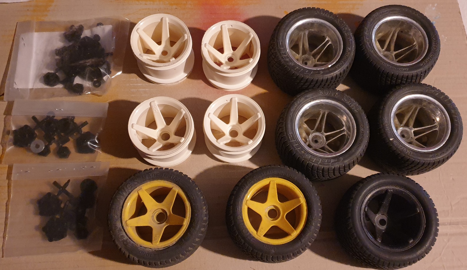

Posts: 3426
Has thanked: 1406 times
Been thanked: 861 times
Re: Dyeing Super Star wheels
All this talk of Super Star wheels, I went and found mine....
Must check my passport to see if "eclectic" is actually my middle name.... or maybe, "piles-o-crap".... :lol: :shock: :oops:

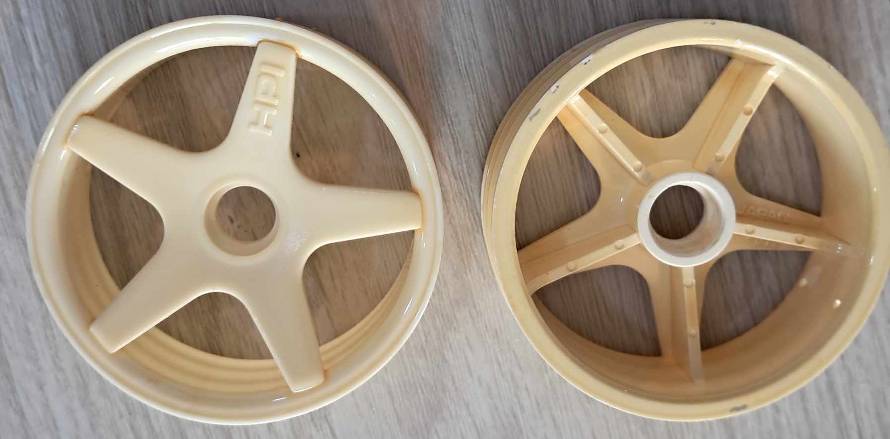

OK, digging one up here...
Bleach, oven cleaner, purple power, etc. (Any alkaline based cleaner it seems) will take the chrome off.
This is before and after a 3hr soak in Kingsford heavy duty grill cleaner (with fresh lemon scent, even).
But now I'm dealing with that ding dang yellowed varnish clear coat. I guess I could try brake fluid but what do you guys think about acetone? I know it's been mentioned in the thread but...
Edit: I have purchased some acetone and will report back.
