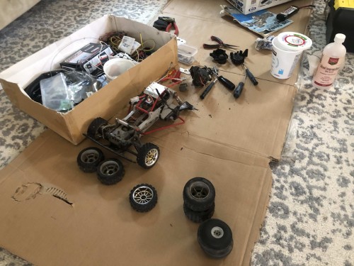

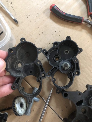

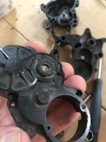

Amazing work on this build! Curious if you have any other comments on the shapeways GB now that you've had some time with it? Was it on par with original, better? I'm now seeking my third Samurai gearbox, the first failed in 1990, the second failed last year! . Failure points are almost identical - the housing that holds chain drive gear, and some of the gear shaft recesses, and multiple bearings worn down.
On the latter point, wondering if you'd recommend a good source for new bearing kit for the car? I see some on ebay but who knows...!
Appreciate any thoughts or suggestions you have. My ride is here:

Im very happy with the printed gearboxes , they are a nylon not abs plastic like the original so less brittle , however they are in form exactly like the original so the bearing that sits behind the rear sprocket is still only in a very narrow sleave of plastic , i think id have added a little thickness there as you know and i can see in your pictures its a weak point but having said all that my printed one is still fine.
I just got one of the bearing kits of ebay , i found that the smaller bearings are slightly wider than the bushings , mostly this makes no difference exept on the diff out drives , the bushings also have a brass thrust washer on the outdives but it cannot be fitted with the bearings , ive not seen any ill effect from this yet as it does not affect the diff mesh but its just something i found .
