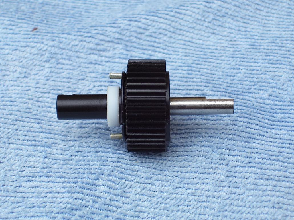

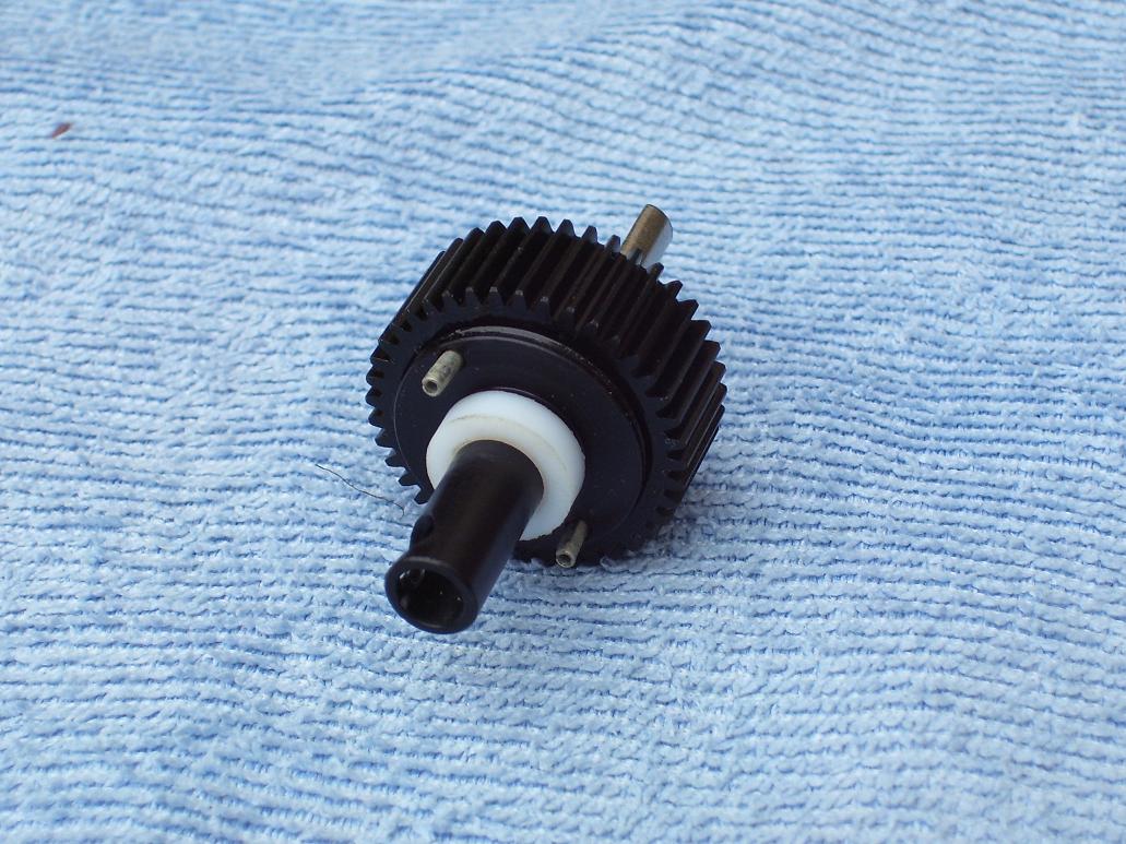

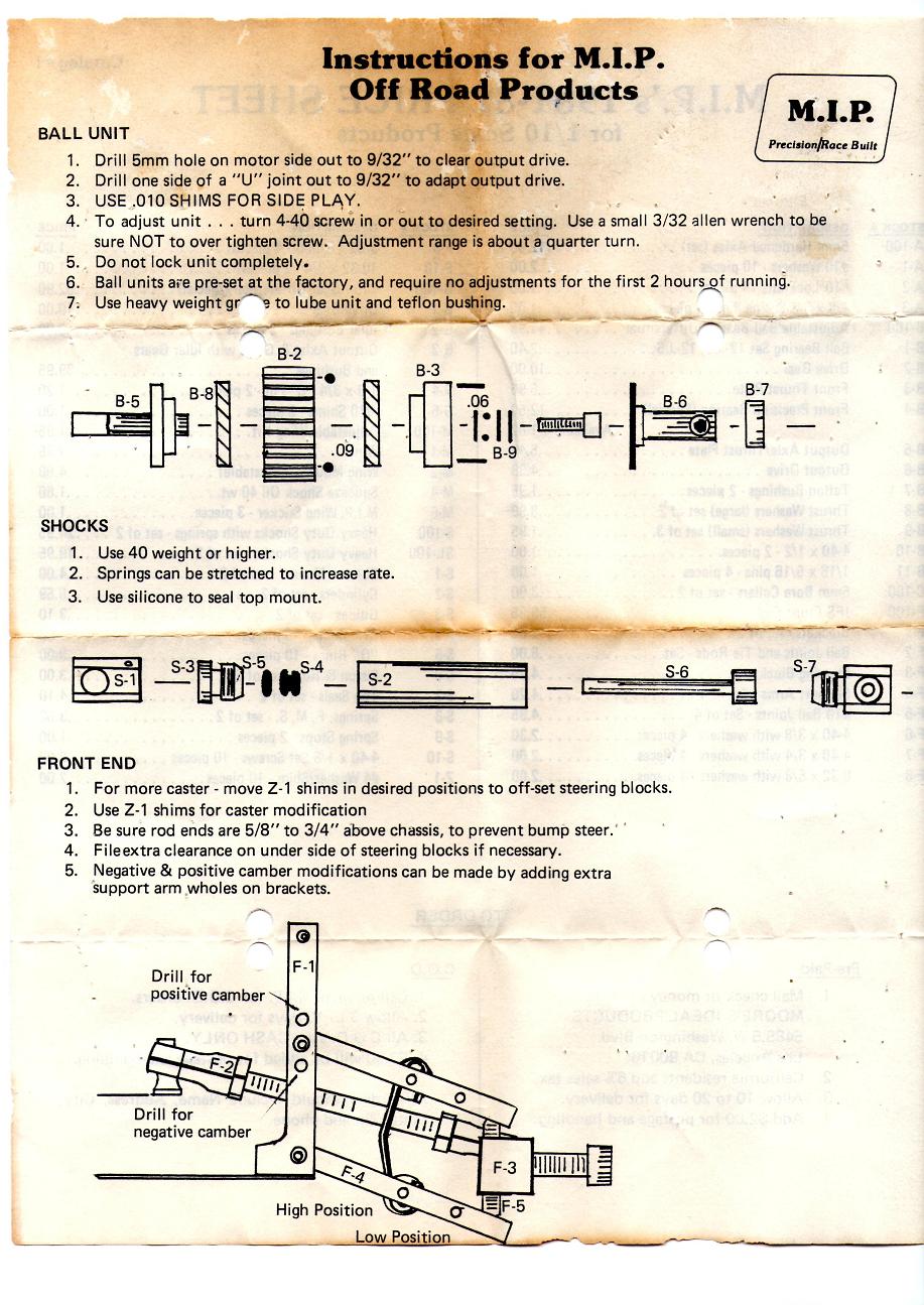

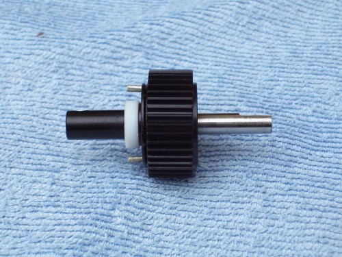

MIP B100 ball diff. I contacted MIP to confirm if this was their first production diff for the SRB. They couldn't confirm if it was. It predates the BN100 and the B200 models. There was also a miter gear diff (G100) available alongside this model.
I've included the diff instructions here. Have a look at the replacement front end at the bottom of the page. A wishbone setup to replace the trailing arms. Woot!
Cool stuff. :D

Interesting to see this. :)
This black diff fits the SRB gearbox??

tiger1 wrote:Interesting to see this. :)
It does. To fit it you have to modify the diff output shaft hole on the left half of an SRB gearbox and the left hand universal as per the instructions. The white teflon bushing is 11mm outer diameter and is the "bearing" for the modified side. A standard 5x11 bearing fits on the right hand side.
