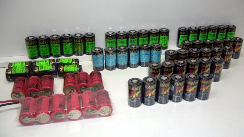

The post man turned up today and with a day off work I decided to tidy these little jems up.
I'm not one for before and after pics but I'm sure Alex will be suprised when he sees how these turned out.
All the heat shrink was removed along with battery bars/straps/wires etc.. then cleaned up with shelite and new heat shrink to finish them off.
Goodness knows how many work but I was suprised at how good the condition of most of these cells were. Alex you have yet again looked after me and I will promise to take good care of them for you.
Cheers-Jason

Great job, mate, those cells look very little like what left my place.....

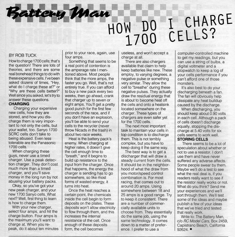

After researching info on the 1700 SCRC batteries it would seem they should be charged in Linear mode at an average of around 4 amps.
Novak recomend anywhere between 3-6 amps. I think the concensus is though that they should be charged according to the kind of use the racer expects wants from them. Lower amp charge rates should result in slightly longer run time while higher amps should give more punch.
Please correct me if I am wrong.

Here are a few more scans focusing on 1700 SCRCs that may be helpful:
RC Model Cars - March 1996
Xtreme R/C Cars - May 1996

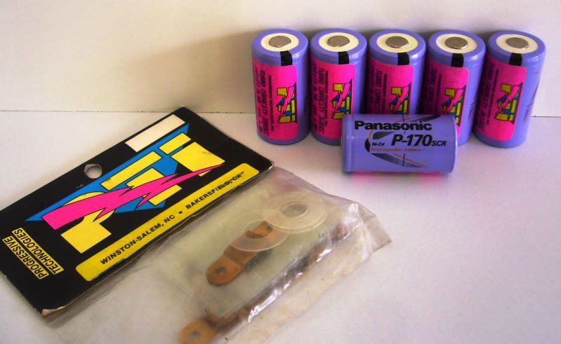

regarding the P-170 scr
i used to run them in mod in sweden 1/12 six cells range of motors where between 13 and 17 winds and they didnt liked to be run for more then 8 minutes and they didnt liked to be stored empty or have resistors on them.
Otherwise they where really good and i still have packs that work i even solder some invidual cells up to an pack for my daughters jeep the kind the children sit in and yes they managed that to.
And yes 1/12 with six cells and 13*4 motors are fast.

Just picked up these little babies recently and am very happy with the condition (NEW )
