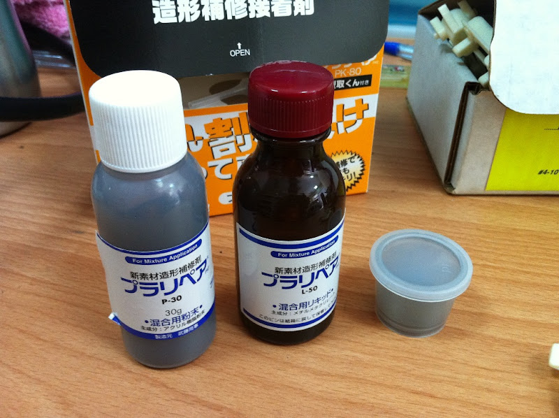

You have to prepare this glue. I'm sorry it was wrote in Japanese. And don't ask me what is it, I don't understand Japanese as well.
The glue contains a bottle powder & a bottle of liquid. If you mix them together, it will be solidify in 5 minutes.
It also contains two pices silicon inside. And we need to create mold by using it.

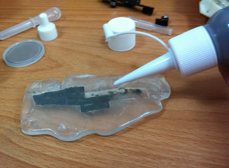

Just put the silicons into 80 degree hot water, it will become very soft. Maybe that is why my wife don't like me to have a bath.
Now, we can make the mold now~
It is time to make the part~
Scatter some powder in, this is very important procedure to prevent bubble.
Add some liquid~
Add some mixed material which catches by the needle. This is very unique method created by the glue maker. I like it!

Done~ It is a little bit ugly. Since I can't take photos & done this well at the same time.
After 5 minutes, the baby is ready to leave mom.
Believe what you see. It looks very beautiful! Even the "MIP" word.
Add some liquid~

AWESOME. Now we just need a Japanese reading member to translate the box, so we can look for a similar product. Mr. ED??

That's moldable thermoplastic and a 2 part resin with color powder
Search for mold making kits

that I can read on the box and bottles is "plastic repair".
and 'black" written in the white oval on the bottom of the box
it's very interesting solution. thanks for sharing this

Here is the Original company who produces the special glue. They even show an example to repro a gear!
I'm not sure if they accept oversea order.
http://www.plarepair.jp/index.html

I found the Plastex repair kits at Eastwood if anyone's interested. They have black, white, clear and a combo kit with all three colors.
http://www.eastwood.com/rigid-plastic-repair-kits.html
