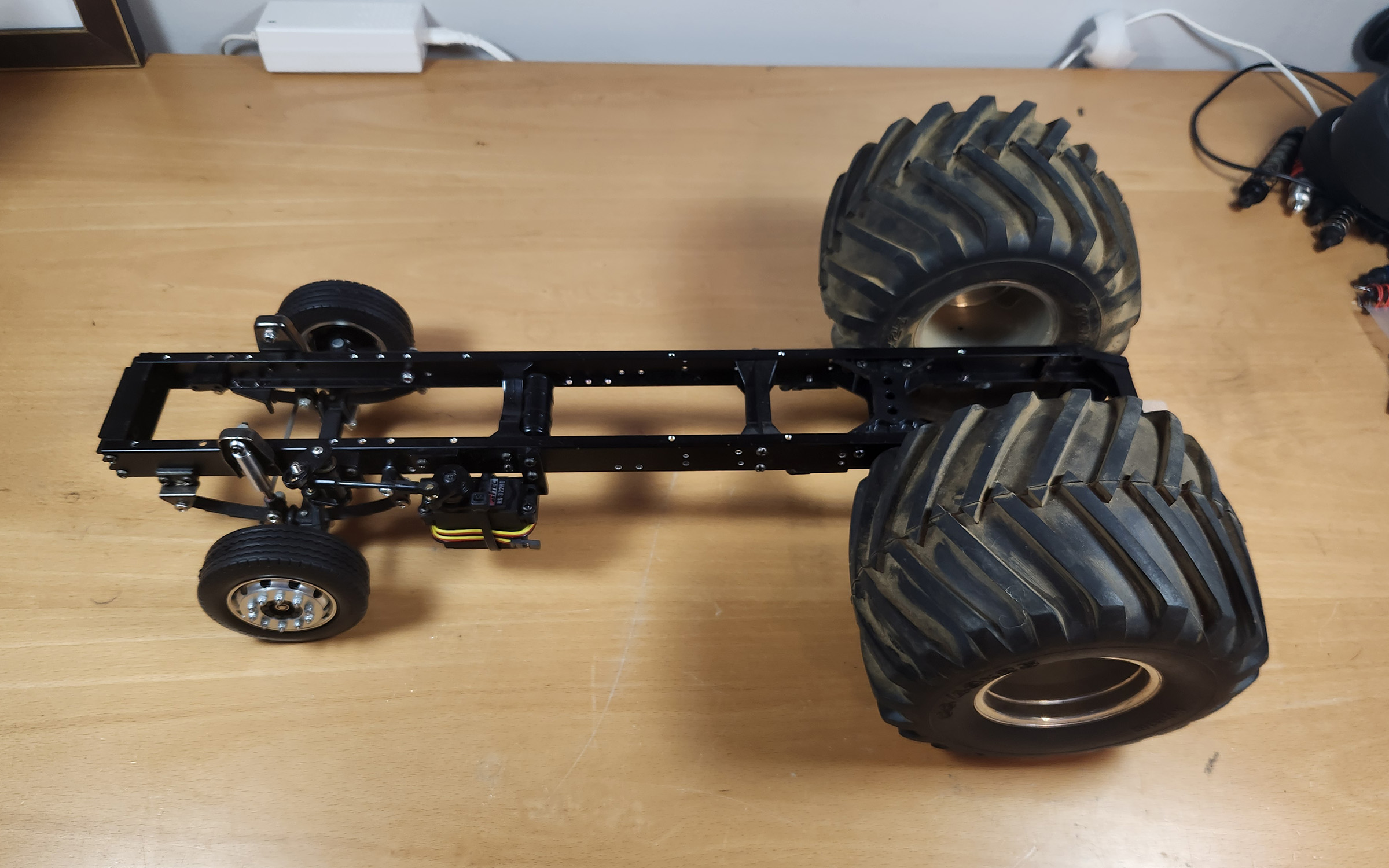

Of course I am going to try to make this as much of a parts bin build as possible, so came up with this out of spare parts. I think the frame will work out well, and was from an extra, unexpected slider that was thrown in on another deal. The front suspension will be greatly reduced or eliminated. Steering completely redone, and I think I can use the original tranny servo mount to help with this. Somewhere in some box I have an aluminum semi front axle. I have a deal worked out for some original white Clod wheels in the next couple of days, so my new purdy chromies can go on this. Also had an oddball, incomplete set of custom aluminum semi wheels that I picked up for near nothing that should work great on the front. I found an old Bolink funny car body that I thought was going to be perfect, but it is a little small for the task.
This is all the easy stuff I think. The rear end is a complete mystery that I haven't even thought about.

So, from the very few pics I am gathering from the interwebs, the FDR I am coming up with 6" Clod tires, is in the ballpark of 20:1. I know nothing about what motors are being run in these scenarios, just that they are running double pinon-spurs, at around 20/90 each.
I decided to take inspiration from my Advanced Engineering dragster, and try to set this up with timing belts. The components are available, and just feel like it will be something a little different than the gear or chain sprocket setups. Obviously will need a thicker / wider belt type, so that will be an experiment. Hopefully I can design and print a "casing" for it all that will last more than a few seconds.
