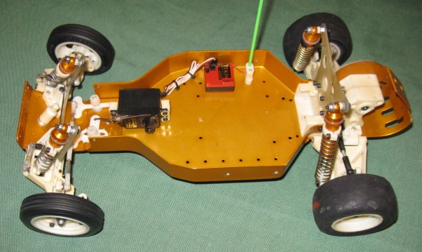

I said what the hell and cleaned,then reinstalled my not-so-perfect rear bulkhead,just 'till my mint new one arrives,so I could at least get the car together.
The Protech body is now fitting real sweet,man I had to trim a lot of lexan to get it fittin' right!
Got me NIP vintage Tekin receiver installed and a steering servo,too.
I won some NIP OE ball cups and a super nice set of turnbuckles...Make a change from using RPM ball cups everywhere!
Period Reedy motor and Tekin ESC comin' right up...I'm sick of seeing Novak electronics in every RC10 I see,so I'm going the Tekin route,just for something different.

You might have to do some more cutting when you've got the nose tubes installed

I checked it with some spare RC10T2 tubes I have and it's cool.
It could sit lower and I probably will trim it some more.
