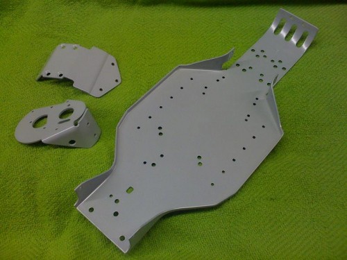

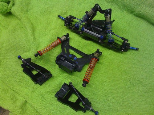

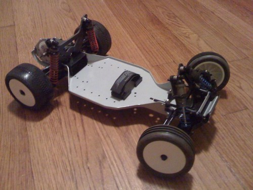

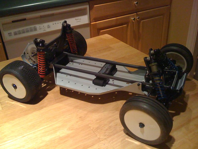

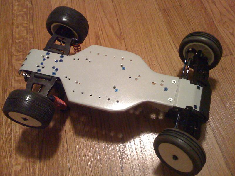

As promised from my other thread. Here are some pics of my other car: Im far from finished. One question I have is the fact of, if I need to make some braces like aeiou did HERE about a quarter of the way down the page. Also when the suspension is streatched out in the back the cva's are touching the a arms, and when compressed they are bottoming out in the outdrives.
Parts Used:
Dynotech arms, dyed black
B44 CVA's
RC10GT Rear hub carriers
RC10GT Nose piece and bumper
RC10 castor Blocks and spindles, with wide GT axles
RC10T shocks and towers
B4 wheels
Let me know what yall think about the car and about fixing the problems.

-i had this ploblem too, so i used a drum sander on my dremel and made the appropriate amount of clearance on the a armschris72983 wrote:Also when the suspension is streatched out in the back the cva's are touching the a arms, and when compressed they are bottoming out in the outdrives.
-as for the out drives/cvas, shim the cvas all the way out, thats all you can do...

you need to get the rpm rear hub carriers. the hinge pin location is lower in relation to the axle, so it will keep the cvd off of the arm. i like using the old losi hubs.

those stock hubs are also creating your issue with the bone in the outdrive.

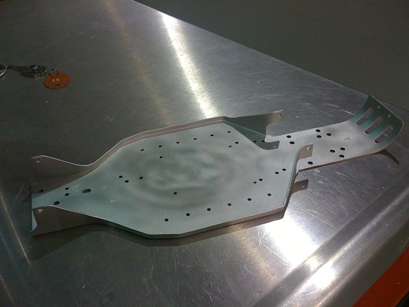

I made and installed these stiffeners. I didnt realize how much they were need after I cut the chassis lip down that much until I installed them.
