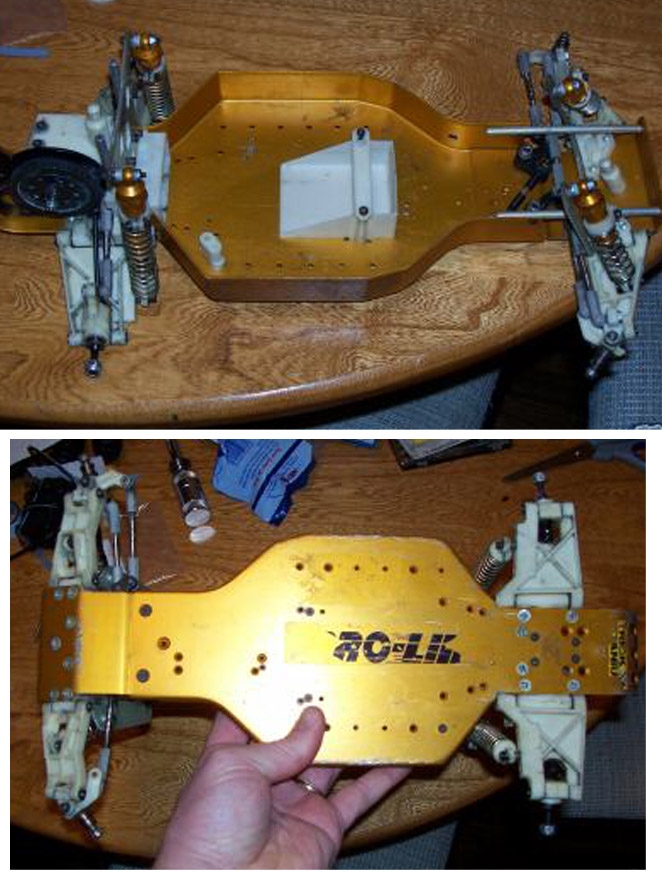

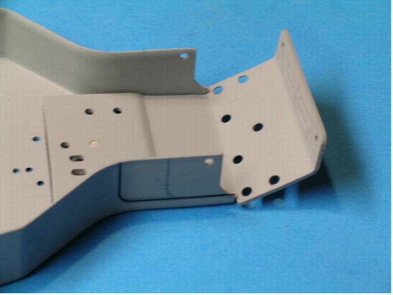

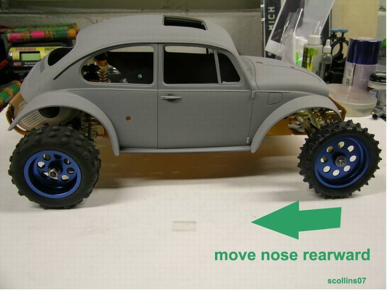

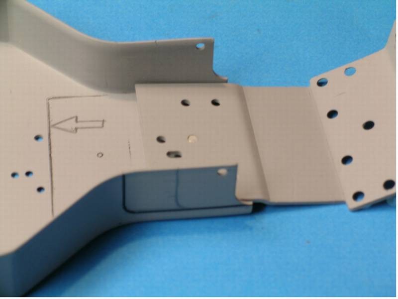

Hi fellas, I recently purchased a lot of good deals on RC10s thru Ebay. I had really good luck finding mint stuff at reasonable prices. In the aftermath of all the extra parts I ended up with plus some extra used chassis I had from my previous experience with Dual Sports I decided to build a Sand Scorcher hybrid- thingie. I am known on TamiyaClub for building one-off cars ocassionally. This will be a Sand Scorcher that actually handles good and is light, unlike the Tamiya version! A leftover RC10 chassis that was all scratched up from years ago is the foundation. I am a Tamiya fan as much as I am an AE fan so that explains why I am even goofing with this. Of course, the wheelbase is much too long so I am going to chop it and slide the nose back into the chassis. Still deciding on the steering setup but I may not have room to do an RC10 style layout. May go with a direct servo mounting right to the tie-rods but I have to check for bump-steer, akerman angle, etc...... If you are wondering I cleaned the tub with wax and grease remover then sanded the chassis tub down with a small orbital sander to scuff it up. After sanding and priming all the big scratches were down to a minimum, BTW this is nice and easy to do for old chassis tubs you have laying around. I will now dry-fit all the front suspension parts and steering stuff to work out the packaging and then paint it later with Epoxy spray paint for durability (low-buck project I am too cheap to get this thing powder coated).. Cheers guys- Anybody else have any "different" RC10 projects we can look at? BTW- the last 3 pics are of a really nice RC10 I scored last week for an unbelievable BIN price. This thing is loaded with mint hop-ups. And yes the vintage Novak reciever and ESC work perfectly , scollins

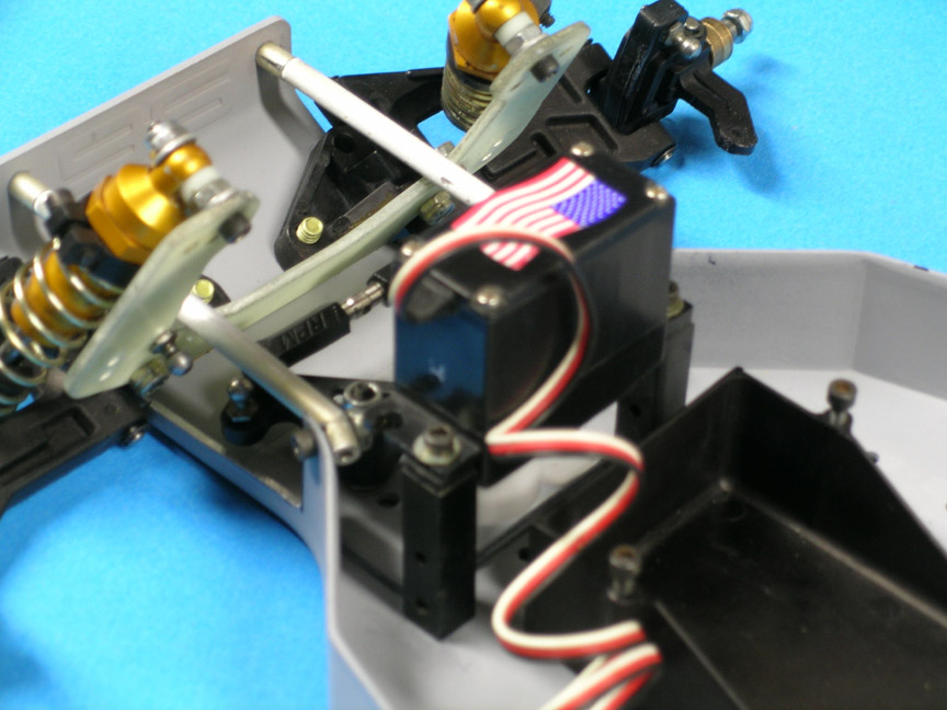

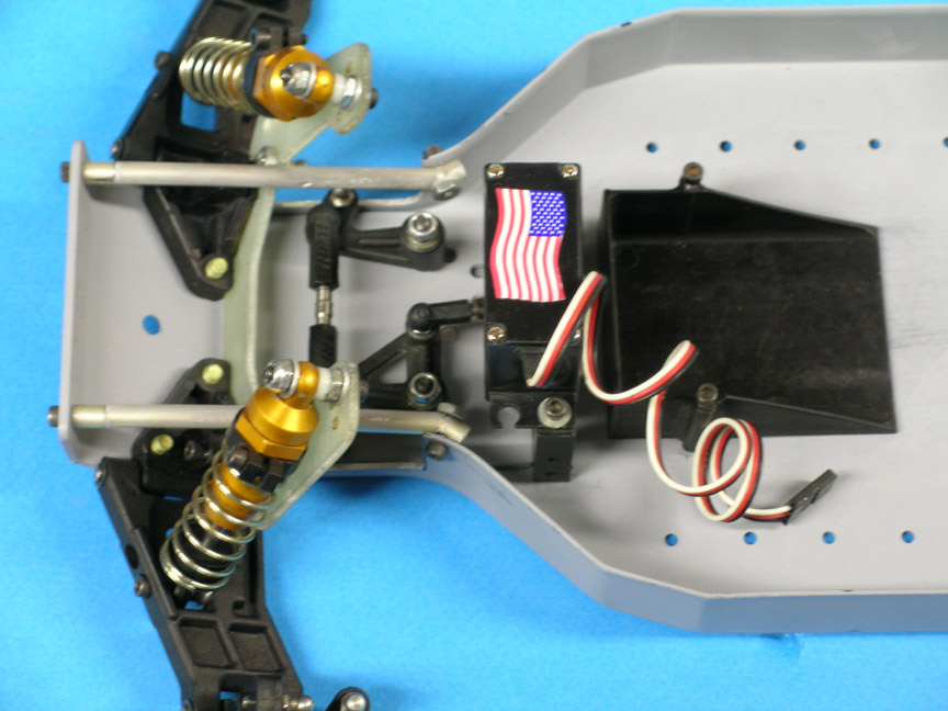

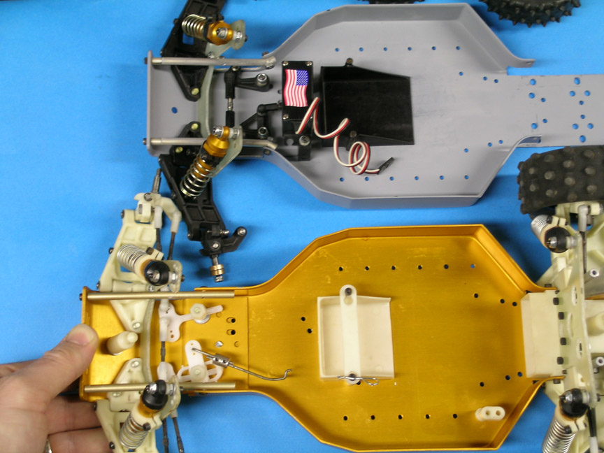

Hi all, this project is coming along smoothly. After much goofing around with the steering I decided on mounting it upside down as the beetle body will cover it fine and it allowed me to use the RPM steering rack, which is what I wanted. The direct mount-steering tie rod idea reminded me of a Grasshopper - it just didn't look right in the RC10 tub frame. I will be getting shorter original style A-arms for the front for a more realistic track width. Pretty soon I can prep and paint the chassis and the nose tubes. Lemme know whatcha think, the wheelbase is now identical to a sand scorcher, Stay tuned!!!!! 8) scollins

very nicely done!

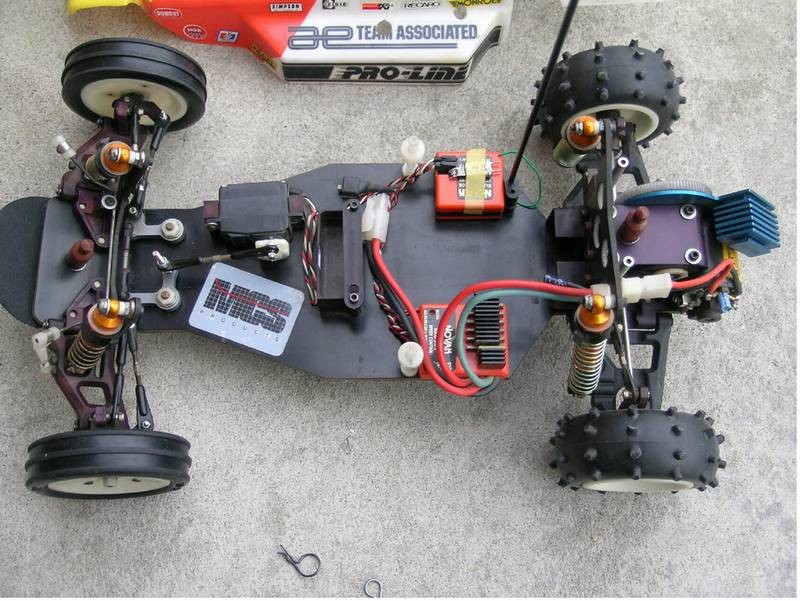

scollins
Posts: 106
Joined: Wed Jan 10, 2007 4:38 pm
Location: Detroit
UPDATES!!!!!!
Post by scollins »
Hi fellas,

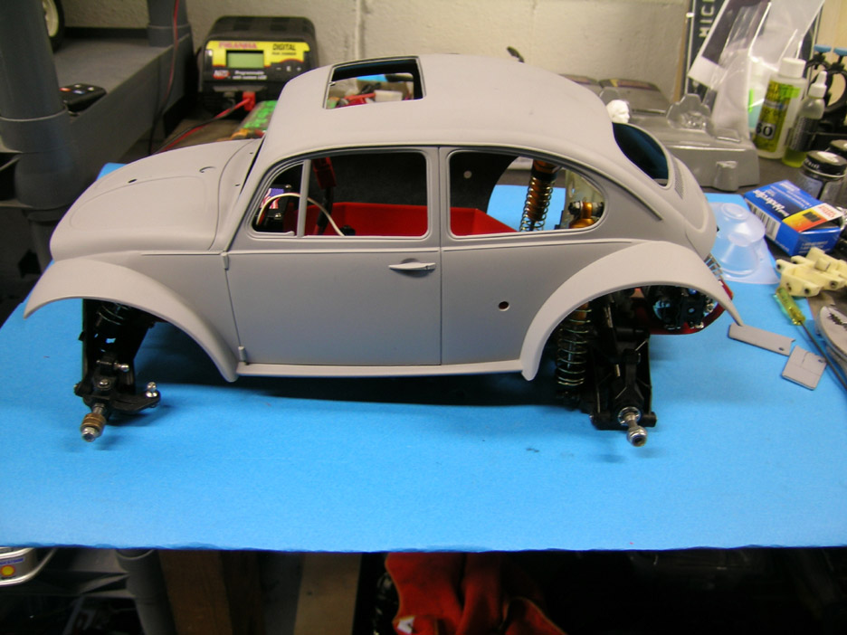

As a reminder, this thing started out as a 45dollar Ebay trash pile.....

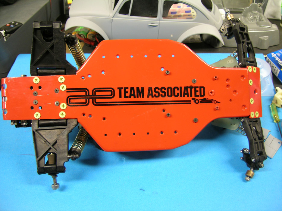

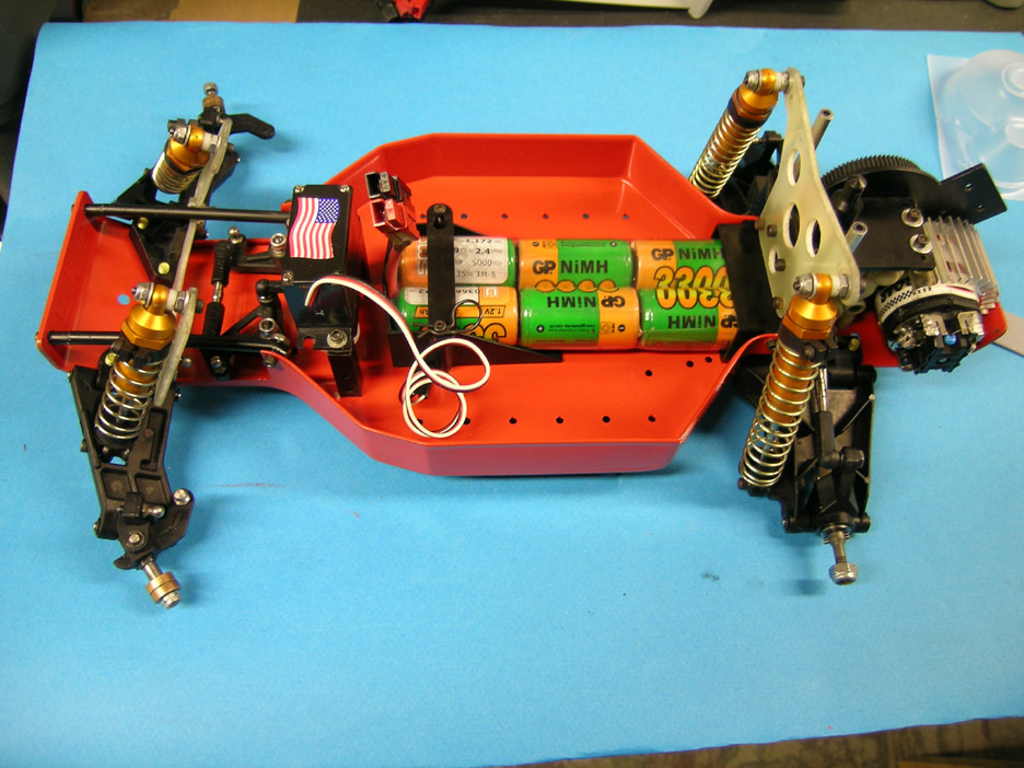

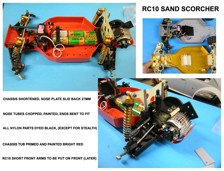

Been working on the RC10 sand scorcher, and its gonna be sweet!! 8) .......Stay tuned, scollins

Posts: 16816
dude, that's lookin' killer. keep it up. :wink:
hey, if you need a pr of short front arms, let me know. i have some nip that were taken out to be dyed black, and put back in the package.

If you ever want to drive it without risking the body...Parma has a beetle shell hidden deep down in its website, pretty nicely detailed for lexan and there's an included spoiler too.
