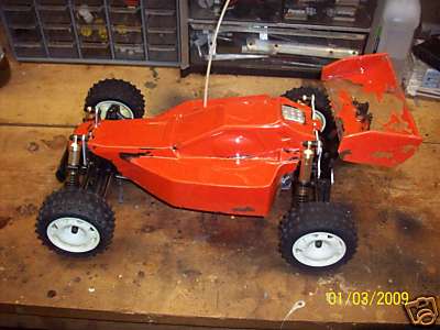

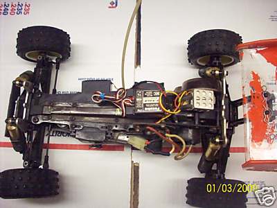

Hi all - I'm new to this forum and just got back into R/C after a 15+ year hiatus with a Traxxas Slash.
I used to own a number of vehicles back in the day - my favorites were the Optima Mid, JR-X2, and YZ-10.
I recently purchased an Optima Mid off Ebay and would like to make it into a runner, as the Optima Mid was my favorite car when I was a kid. I do have a couple questions about the Mid, which is why I put my first post in the Kyosho forum:
1. Which wheels can I use which will work with "modern" tires? I tried to use RB5 wheels, but the hex nut part of the tire didn't seem deep enough for the Mid.
2. Isn't the stock spur gear a metric size, so the standard American pinions won't work? That's what I recall, anyway.
3. Where can I view an Optima (standard, not a Mid) owner's manual? In addition to the Mid, I also purchased a standard Optima with the belt drive. I never owned an Optima, but always wanted one.
4. Are there any preferred ball bearing vendors for the Optima Mid? I do see some on Ebay for roughly $16 shipped, but I wonder about the quality - and they are apparently shipped from Hong Kong.
5. Any websites that have "setup" information for these cars? Shock oil, etc. I realize these cars were less adjustable than the current vehicles, but if there any setup sheets I'd love to take a look.
6. I need a new kingpin for the Mid. Are there any current vehicles/suppliers that would offer this?
Thank you in advance for anyone who can answer some or all of my questions! Attached are the "raw" vehicles I just got off Ebay...both will need some minor restoration.
Kevin

Re: Optima Mid
Welcome to RC10Talk!
You can't go wrong with any of the Optimas. They make great vintage runners!
1. I believe HPI Superstar wheels (like these: http://www3.towerhobbies.com/cgi-bin/wti0001p?&I=LXCEA1) will fit without any modification. They take modern 2.2" tires.
2. Yes, you need metric 32p pinions.
3. http://www.retromodelisme.com/manuels_pages/42/optima-kyosho.html
4. I usually buy from Avid RC; all their bearings are $1 a piece and the quality is great. They don't sell kits for particular cars, but you can just order what you need. Website: http://www.avidrc.com/shop/?action=category&id=1
5. None that I know of. Optima House (http://theoptimahouse.blogspot.com/) is a good resource for all Optimas in general. Perhaps the webmaster can get you started if you contact him.
6. No idea...
