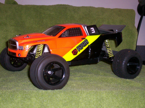

I dont know much about the XXT but the LXT I still race today. well I did, I started racing again this year. Frist time since 1992 and I started racing my LXT again. it was great! I ran a brushless system in it and it was just as fast as the T4's I was racing. I still race my Jrx pro se same as LXT but a buggy, they put me in with the MOD. 4wd cars and it holds its own with a stock 27 turn motor. and I just use another front body mount on the rear tower and run a HPI Dodge Ram body on it. the JrxT ft mount works well for after market bodys. the only reason I gave in and bought a T4 is some of the guys at my track are kind of rough and I wanted to be able to by parts in the shop and they dont carry Losi parts. and I just wanted a NEW truck. Plus someone paid me an obseen amount of money for my LXT and I have another one. keep them both or ship them to me I will!! the Retro fit trans is great never let me down with a brushless. here is my LXT

Thanks for the info there rickster, I'll be putting the RC10t on ebay soon, but i'm gonna rebuild the LXT with a XXT cr body, and some LXT/XXT disk wheels, and then, take it from there, will I keep it, sell it, time will tell
Oh by the way, that LXT looks awesome, scary
