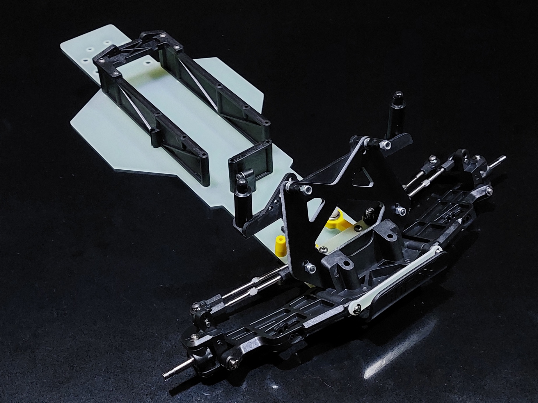

Tonight's progress....
Out of the three of these kits that I built this one is by far my favorite chassis kit. The fiberglass is fairly translucent and has a nice texture to it.

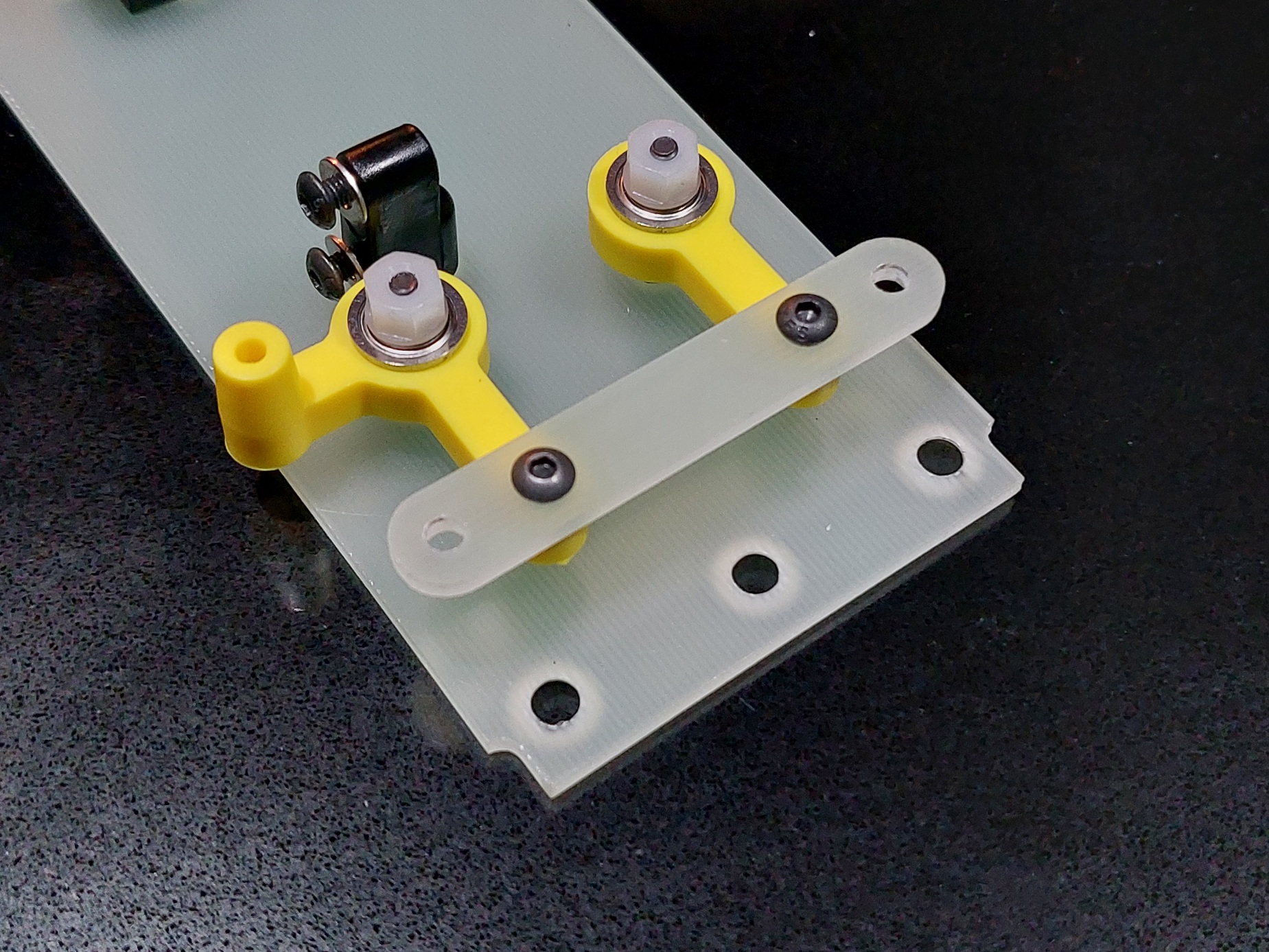

Unfortunately I didn't have the header card for the battery box as I ripped it apart when I pulled it out to dye the nylon black
Steering assembled per SRT instructions, it looks good but I might possibly have to play with the height adjustment slightly for bump steer, we'll see when it's closer to being finished.
Front end pretty much done

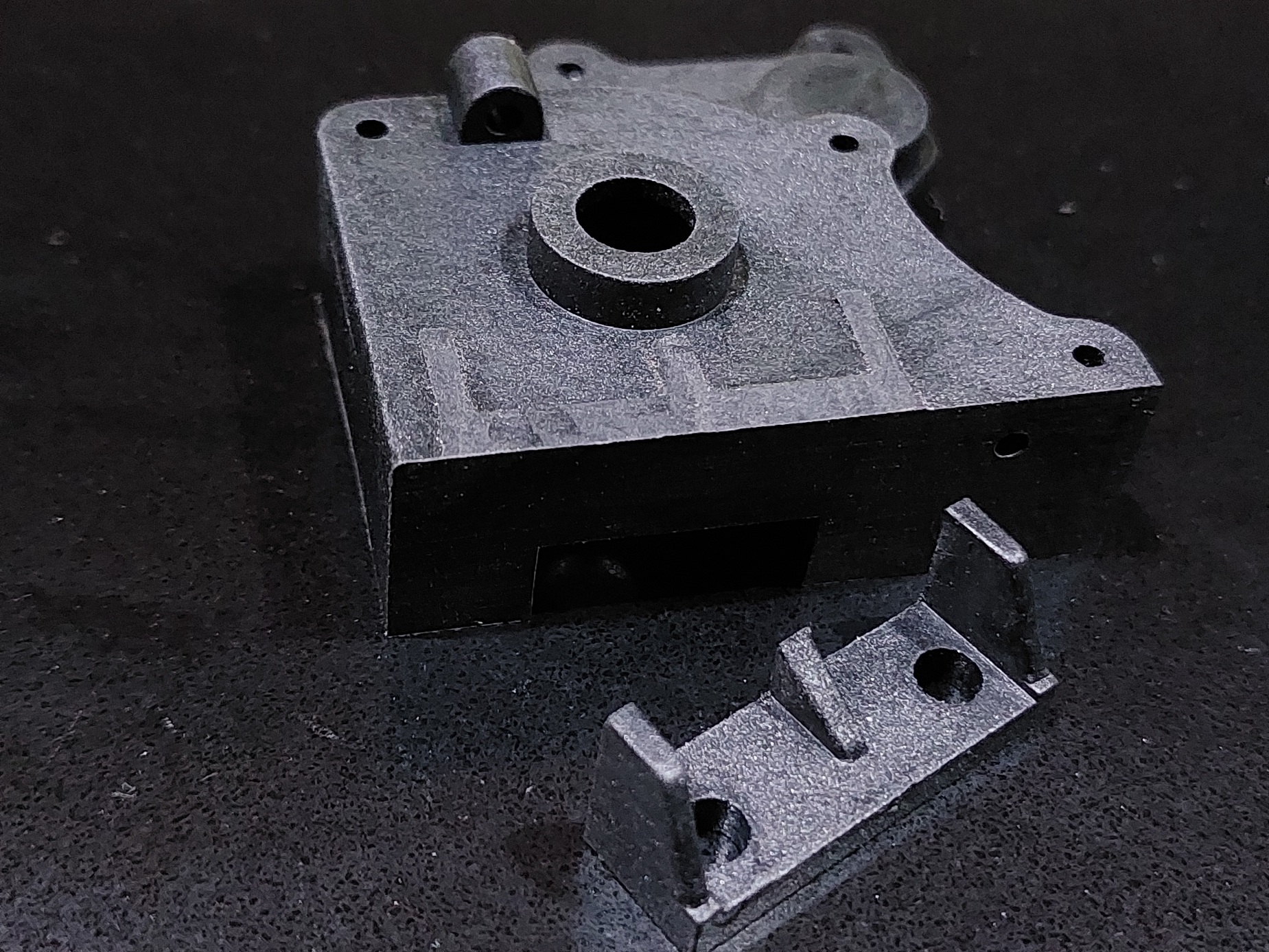

Same as the last three trucks, I cut the ears off the gearbox.
Here's a little racers tip for gearboxes, sand the bottom flat so that when you bolt it down it sits flat/square without binding or warping the case. Most molded gearboxes like these are terrible.

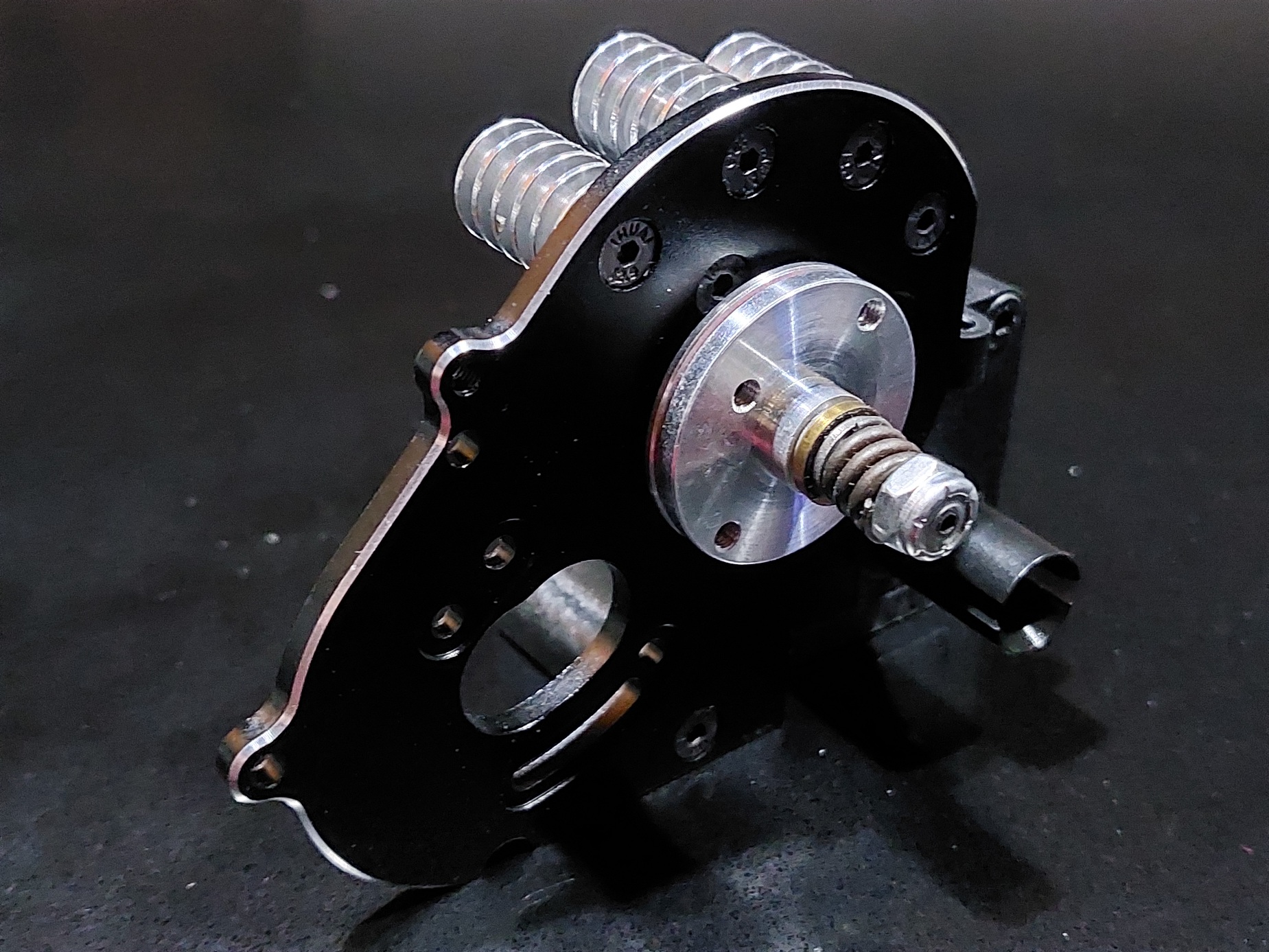

This pro diff is pretty impressive, for a traxxas diff it's pretty good. I went with the alloy idler this time and another home made titanium idler shaft.

Since I originally planned to build this as a "period" racer I bought an A&L/Factory Works Power Clutch to go along with the theme.
I've never had or seen one before so here it is for those interested like myself.
Looks pretty good assembled. It definitely has that engineered feeling to it.

Thanks, just make sure you ask Jeff which version you need. I'm pretty sure these ones are on the Rustler geometry and not the SRT geometry, the SRT uses a wider tiebar from memory.
