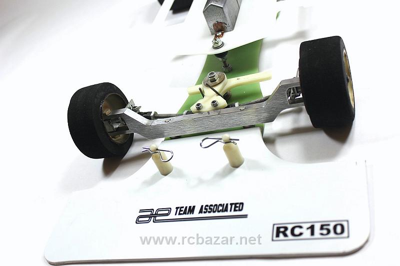

Then, on the radio plates. Some are cut for servos, and some are not (like mine), but I can't find a picture anywhere of a non-servo plate complete vehicle, with servos? Were they just taped? Anyone have a pic of the set up? Thanks

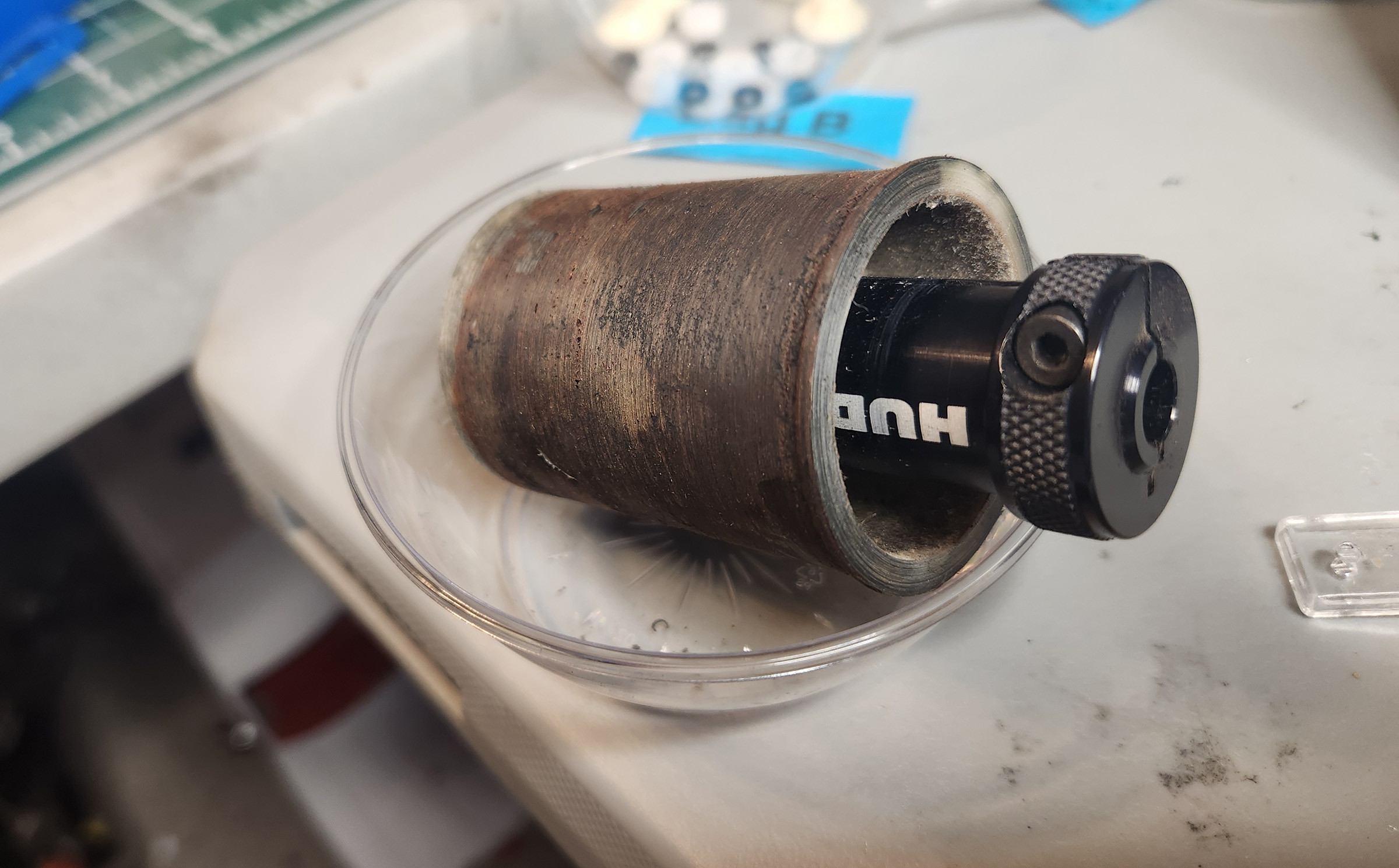

Anyone had any luck removing the black tire glue that AE liked to use BITD? I have always hated the pre-glued tires that came this way from them. I have cut the wheels down as far as I really want to go, but the black is stained into the nylon I believe. Anyone ever had any luck lifting the stain out?

The black tire glue is a pain in the a...
But I think it was the only glue which really fixed the tires to the wheels safely. For that reason very hard to remove.
I removed the same or similar glue from Delta wheels with my Hudy tire truer.
But it still was not easy.
BTW if you try to do the same way, be careful and don´t overload the tire truer with too much pressure.
I killed my Hudy this way, after several sets of wheels.

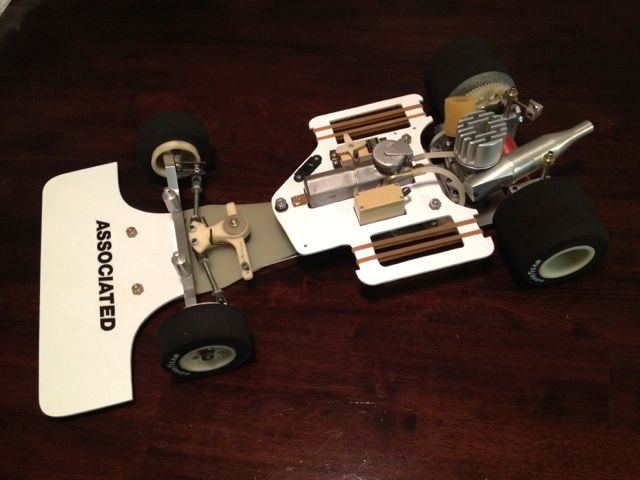

So, I started this off as a questions thread, but then just decided to make it a build thread and I will just ask questions as I go. The plan here is a "driver" restoration of a RC150. I will use original parts as long as they can be brought back to "driver" condition, but if not, new or repop parts will be used. This is not a "bring back to fully original" type of build.
This is how she started. Found this about 3ish hours away from the house, for a stupid low price I thought, so I took a day off and made a road trip. This car came with a K&B Veco 19 engine in it, so it may have been one of the later versions that came with such engines in the box, but I thought those would have come with the "car" version of the Veco, with the longitudinal head, but I am not sure there. This particular car came with the standard head. Car came with a good foundation, but was missing quite a bit.

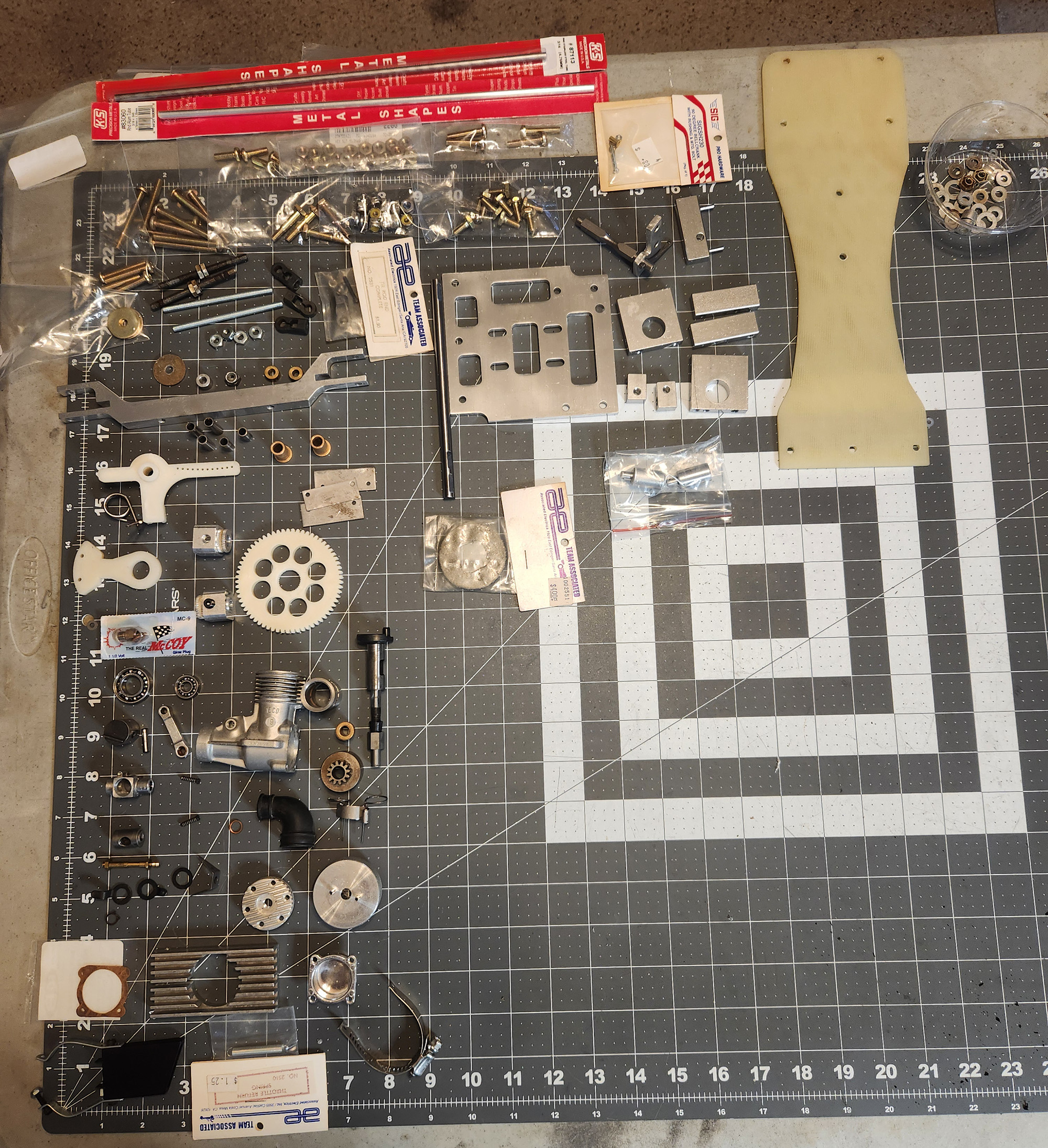

So, from there I just started taking it apart and prepping and cleaning what was there that could be reused. For the hardware, I decided to replace it all with commercially available equivalents, just trying to match the chromate coating of the original. I had a NIP spur gear or order, but UPS lost it, so had to reuse the original. The original main plan was going to be the engine, because well, I have never touched a nitro engine in my life previously. This was a bit of what I was looking at, and this isn't all of it.

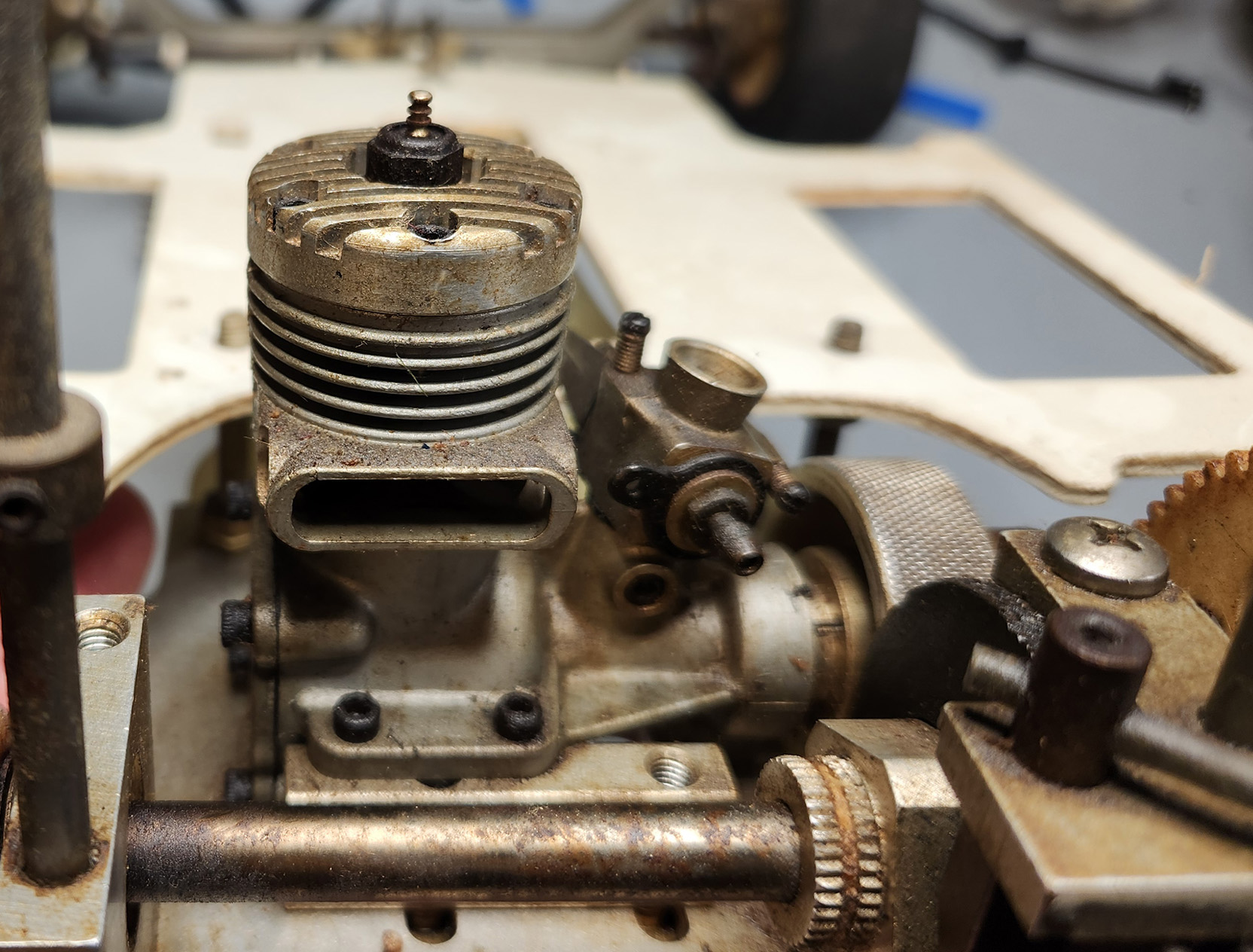

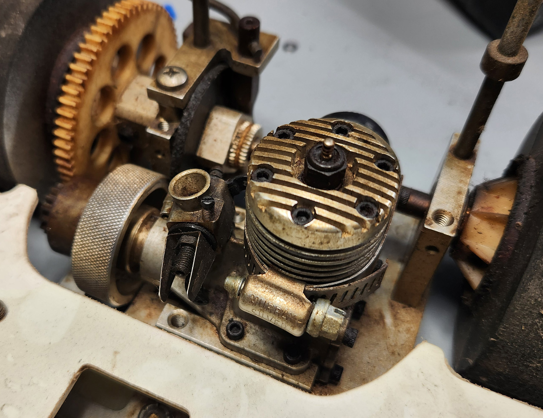

So, yea, the engine. I tore it apart and put it back together, and learned a lot there. I found a $10 engine on ebay that had the head I needed to make it a "car" version, plus a straight pipe/muffler, so score. I thought I had some just engine done pics, but I don't, so just on chassis pics.

morrisey0 wrote: Sat Nov 02, 2024 8:49 am Then, on the radio plates. Some are cut for servos, and some are not (like mine), but I can't find a picture anywhere of a non-servo plate complete vehicle, with servos? Were they just taped? Anyone have a pic of the set up? Thanks
Just found a pic which could help. Cutouts not really well made but show the positions for the servos.
