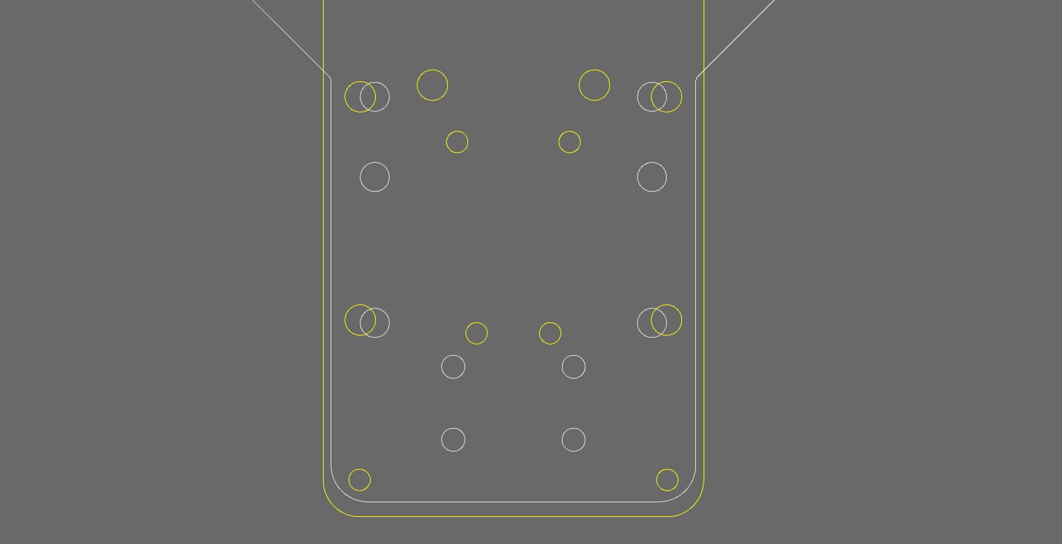

This project will use the Bezerk carbon chassis modified for a "Stealth" transmission. Having recently finished rebuilding a Team Car, I took some measurements and tested a few things to see if it would work. An overlay of the RC10 Graphite chassis was used to check all the hole positions.
The Stealth holes were moved back 4.5mm to get the outdrives inline over the centre of the arm mounts and to not foul the bulkhead. It looks to be in roughly the same position as the pro transmission in terms of weight distribution. On the original tranny, the casing slots into the bulkhead. I'll need a longer trans brace to the bulkhead.
The motor guard holes were also moved back. With the standard bloody gap between the guard and motor plate I thought this wouldn't be necessary. With hindsight...yes.
