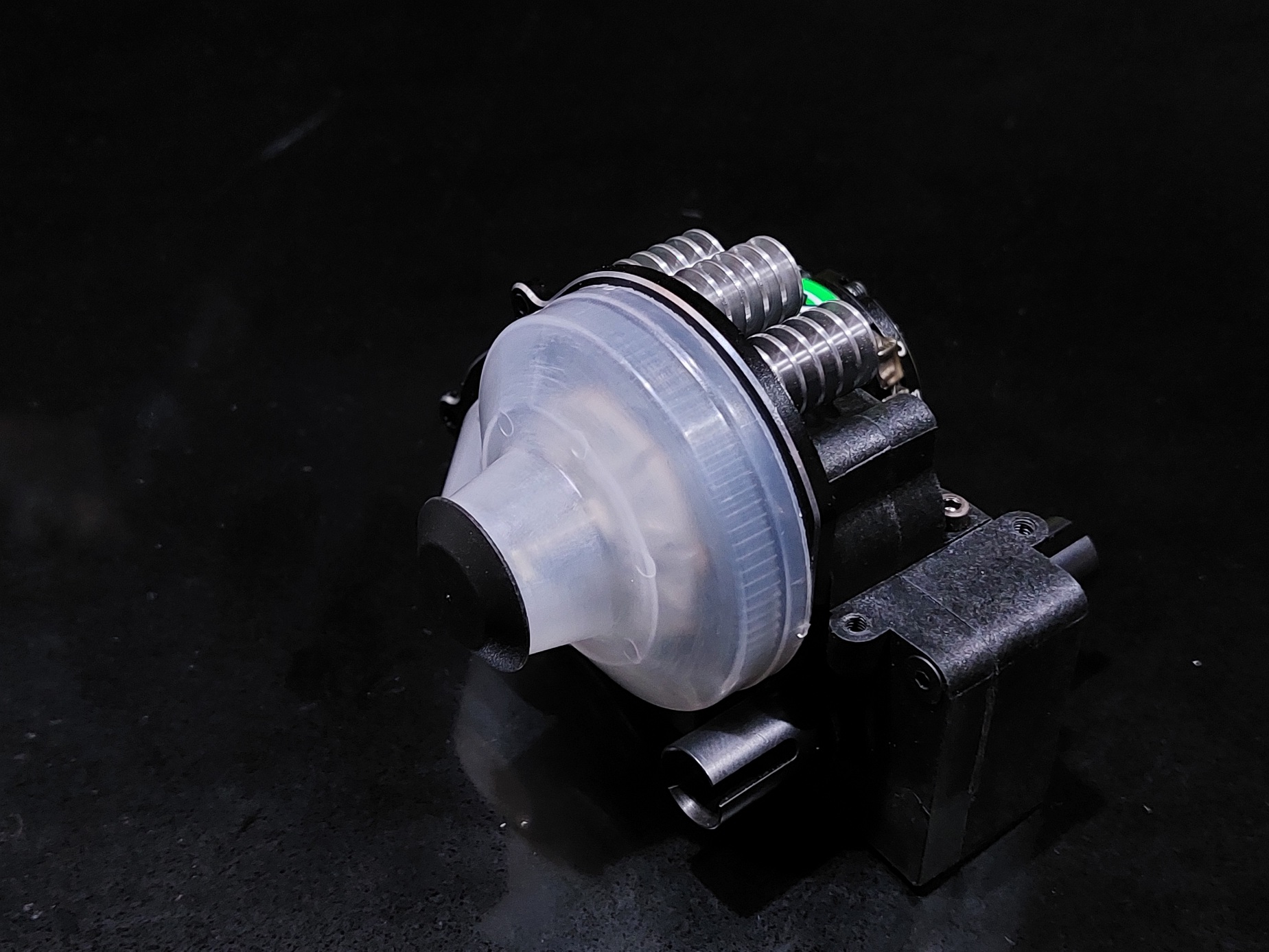

I bought another 4620 diff for this truck and I attempted to drill out the output shafts which I wanted to do with my race SRT. Needless to say it turned out a lot better then I was expecting.
This diff feels better than the other two tra**as diffs that I built, go figure. The only difference is that I forgot to order carbide balls so they are just chrome steel. I'll order a set of carbide or ceramic for the next rebuild.
I've decided to try all nylon gears again, so we'll see how they hold up since this truck will have healthy boost and turbo settings. The top shaft is an Avid AE conversion top shaft, POM gear, Team Brood magnesium slipper plates, and AE slipper pads.

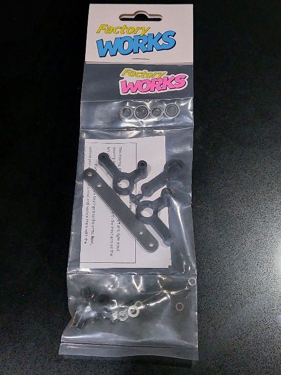

Another piece of the puzzle, incognito black steering set from Factory Works. I'm struggling to find someone who has 2.5mm black G10 here. Ebay has G10 sheets but they are all 300mm and I need 330mm

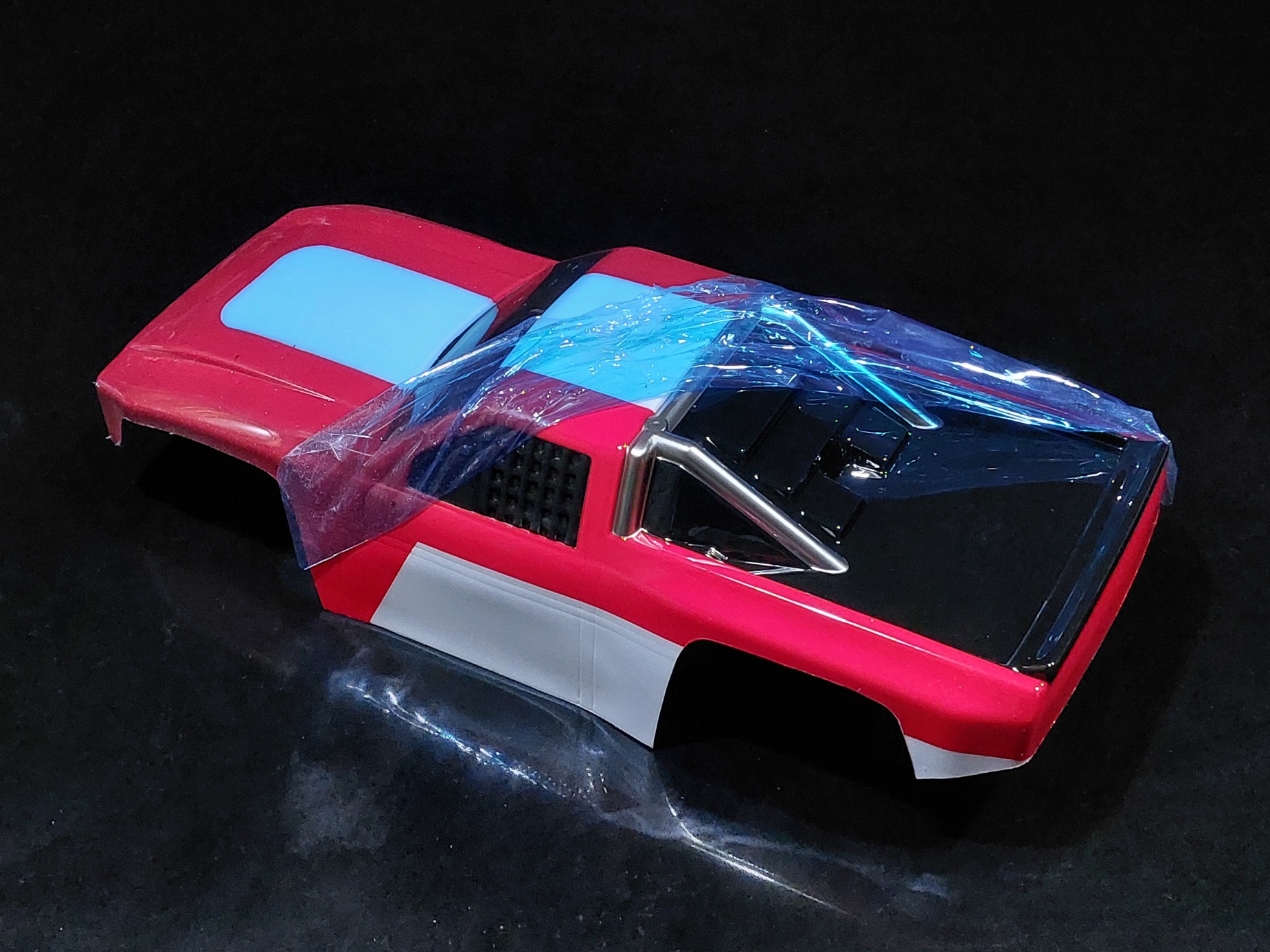

Amongst other progress and going back and forth between shortening a chassis or not I painted a body. I suck at painting but I used a tape that I like better than Tamiya masking tape. It's about as simple as you can get but still 5 colors. My camera makes it look pinkish but it's definitely red.

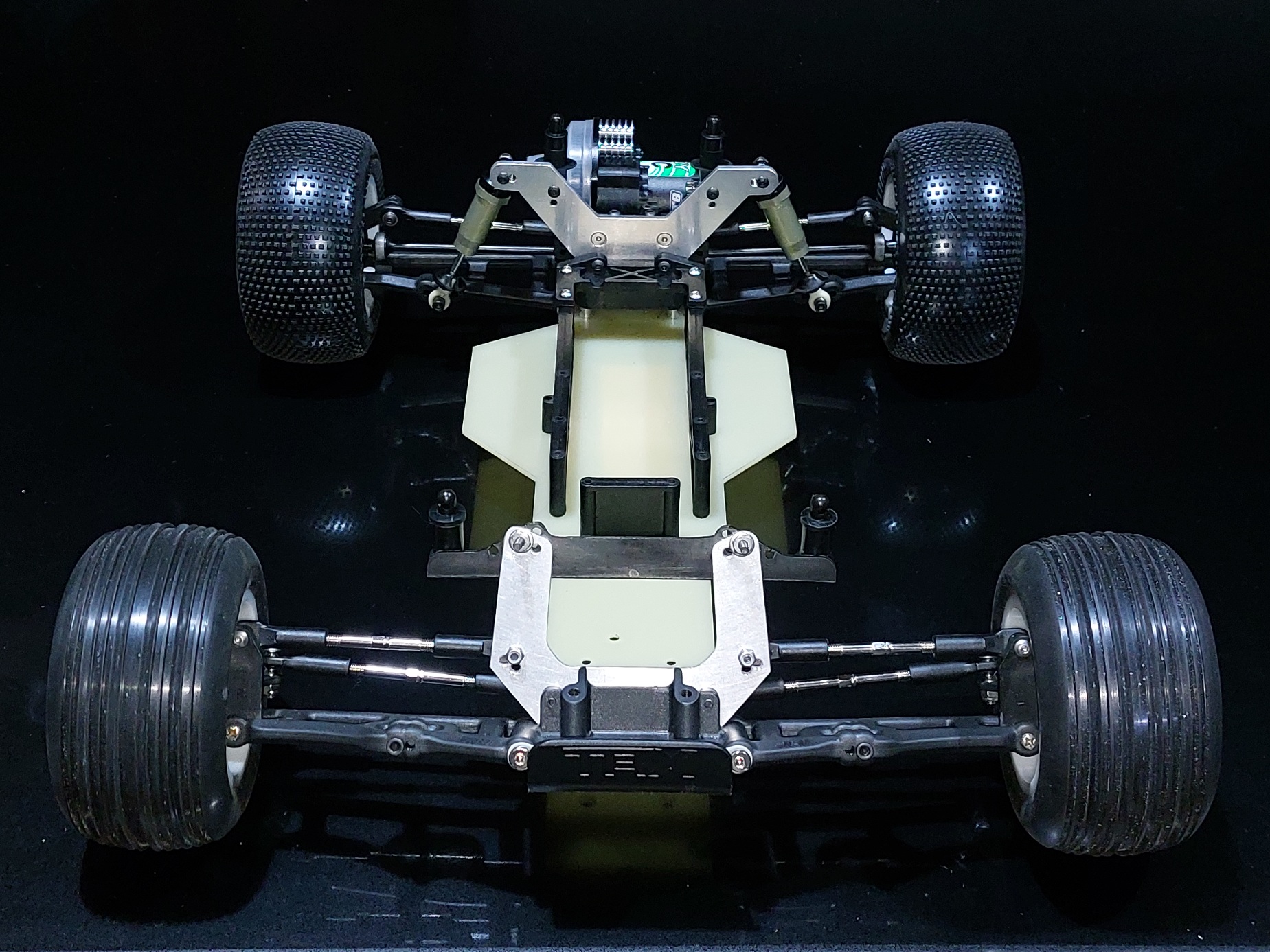

I finally dyed the battery box and made some new low profile shock towers to fit the SRT body, so far so good. The front tower is 10mm shorter and the rear tower 18mm shorter while still retaining the stock shock angles. I just need to make the rear trans brace before I get back onto the chassis which is roughly cut out and half drilled pending my final decision on length.

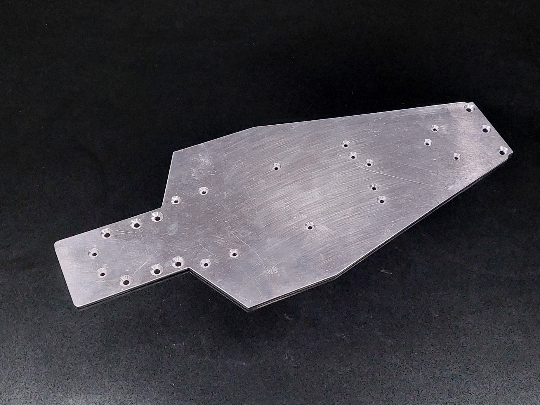

Trimmed the chassis profile and countersunk the holes, for some reason the countersink I was using wasn't playing the game in the drill press so the countersinks aren't as nice as I would have liked. All in all it turned out pretty good at the end of the day.
I could finish the chassis face a bit nicer but it was a pretty beat up offcut to begin with. I would like to get some black holographic mirror vinyl for the bottom chassis protector so when it goes tumbling down the street it puts on an electric light show.
