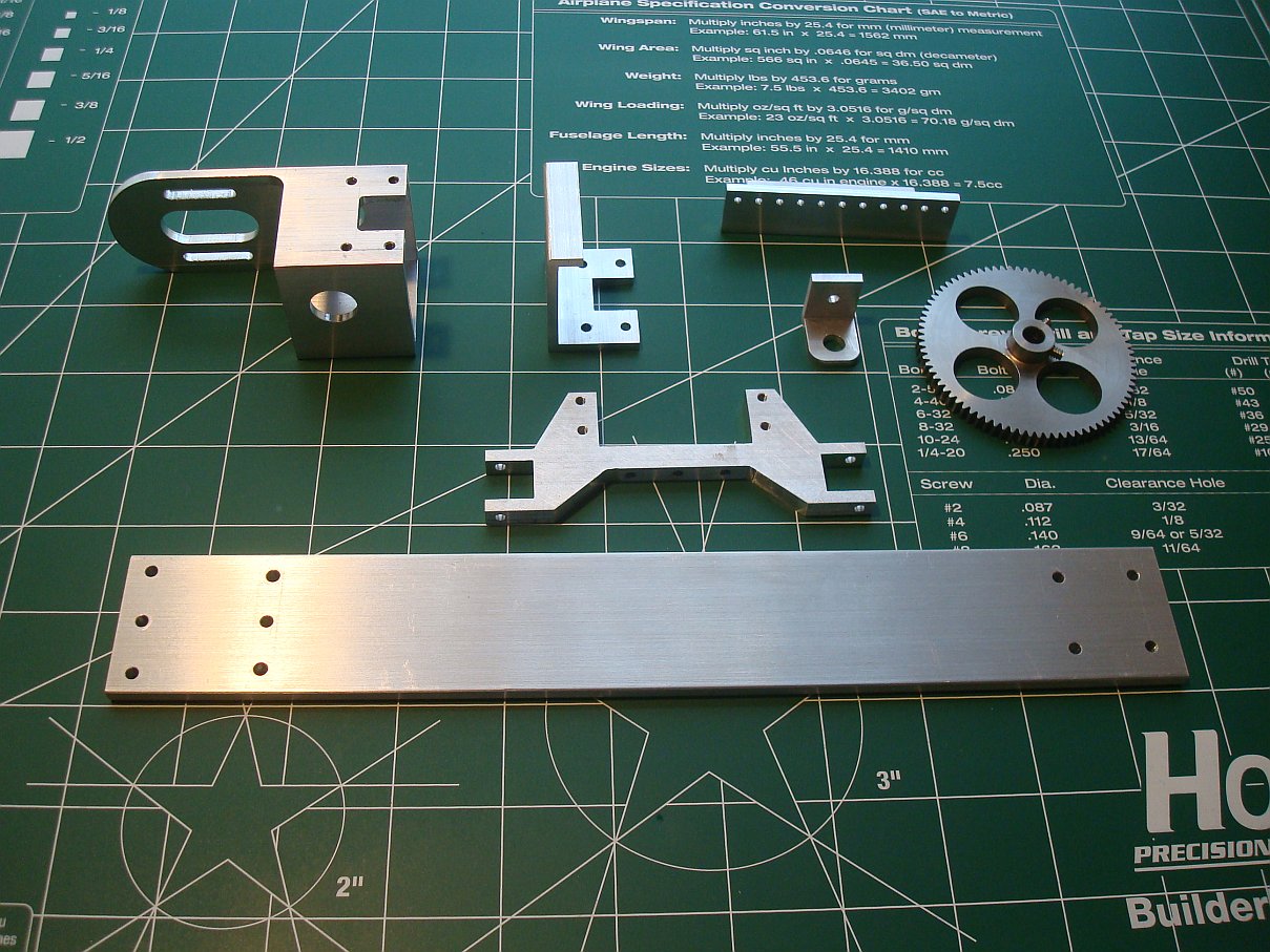

This is where I'm currently at with it. The starting point:
Some of the parts I'll be using:
The first order of business is to refinish the aluminum. I'm after a matte or brushed type one but I don't want it too dull. I've read that a red Scotch-Brite pad and WD-40 is a potential solution. I have a test piece I'll try a few different methods on to see what I like best.
