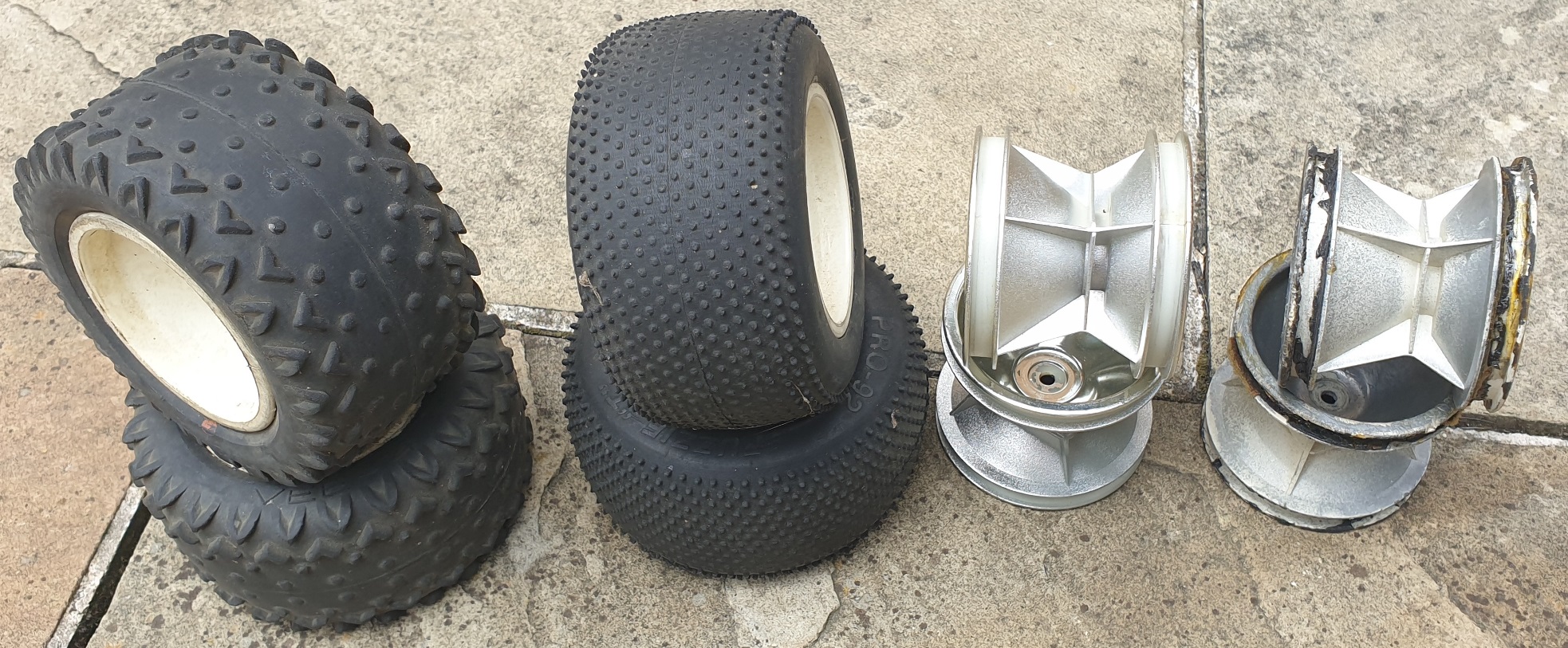

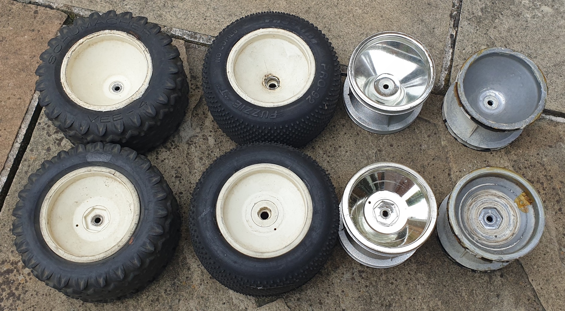

Posted: Fri Jan 27, 2023 10:27 pm
by Incredible_Serious
I looked in the shed.... soooo many rabbits.... but U2 were (as always) wrong - I found what I was looking for :lol:
The wheels with rubberware are, from memory, from a Schumacher Wildcat truck. Sadly, they're glued on,and fairly worn, so would need a dose of acetone vapour.
The third pair are new chrome rears, I think from a Rascal or similar...
The fourth pair are a well used pair of white rears, painted silver.
