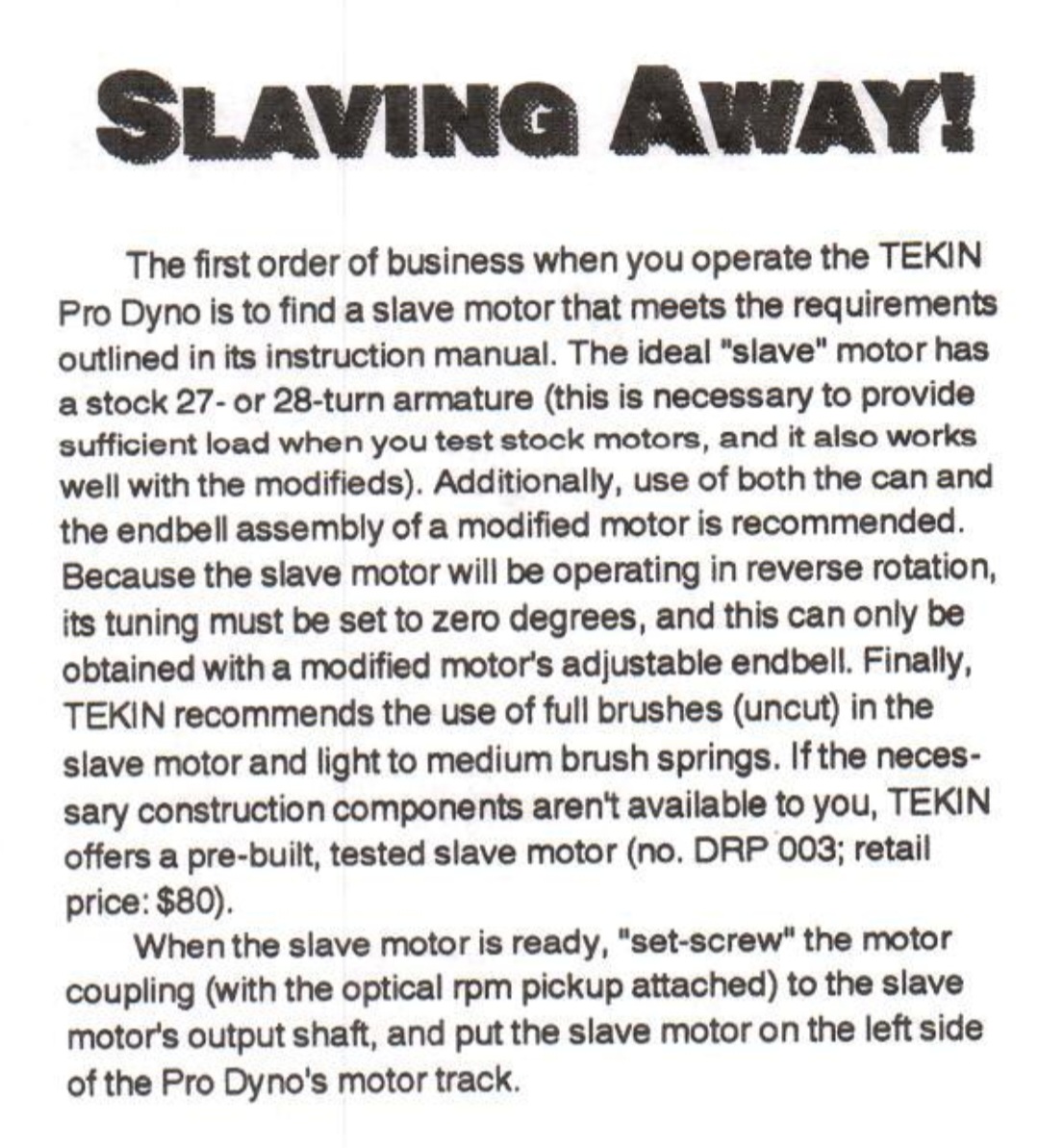

I got the scanner linked up with my tablet and was able to scan the directions.
I also scanned the data sheet. For some reason, the scanner removed the header from the page.
I also borrowed a page from the Tekin dyno manual, about making a dedicated slave motor.

I built the slave motor and decided to try it.
Apparently, the cheap Kobalt DVM that I bought doesn't range very well, so I had to use my Fluke. Or at least, I might need to learn how to use a cheap meter.
I didn't try to get any useabe data, just verifying that it loads up and displays some type of data.
