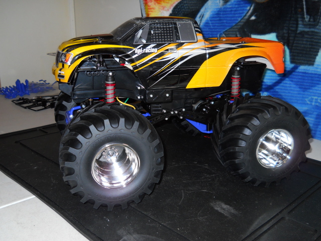

Axles assembled and getting ready to put the suspension on. I decided to run the stock steering for starters. I went with 4 e-maxx shocks with red (soft) springs. Looking back I think I should have put the stock pogo sticks in there, but I had a lot of traxxas shocks sitting in the parts bin. One thing I noticed is that the stock tamiya guide/tool for the pinion alignment is a little off.
I had forgotten just how poor chassis clearance was with the stock steering. I'd have fixed that, but I knew the stock steering was temporary. I just wanted to try going old-school for a few runs, I guess to establish some kind of base-line.

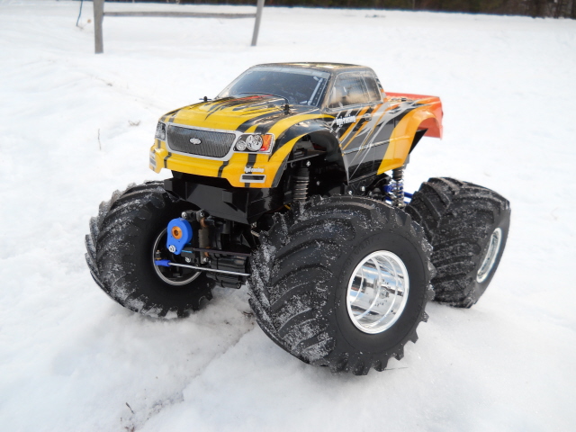

Here it is all together. Sorry, no square-body. Not really a chevy-fan, and my brother-in-law is, so he got the chevy body. It might be beat up, but I think that HPI E-savage body looks really good on there. Kinda' looks like a super-size wheely king.
Doing what clods do best, playing in the snow. This is running the stock esc and a weak 2S lipo. I really do find it amazing how "light" on their feet they are in the snow. Despite how slow this was (by my standards) I was really having a lot of fun with it. I had a brushless e-maxx with oversize tires at the same time, and this truck out-did it in the snow fields around here. (meaning it got stuck a lot less)

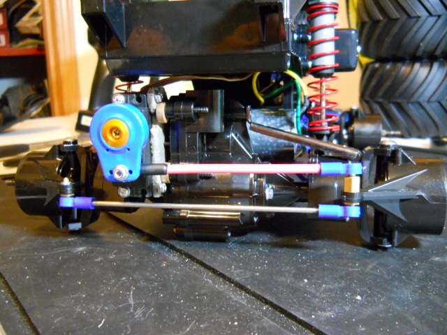

Steering set up was changed after a few runs. I'm an R/C pack-rat of sorts and I keep broken stuff for scrap material. The vertical servo mount was made from a broken piece of e-maxx skid plate. The short tie rod is threaded rod (covered in shrink wrap) with a dubro rod end and an ofna servo saver. The spacers between the mount and the gearcase are 5x11 bronze bushings.
The rear-steer lock-out is broken bits of old (stock) steering bell crank put in the hole upside down and using the same screw and brass spacer. I put one of the pivot balls from a broken dubro rod end into the clod rod end, and then ran the screw though the hole in the pivot ball. Very low-dollar, but very effective. I've got more clearance and suspension travel now, but I still need to cut a relief in the front chassis corner for the servo. It doesn't hit right now, but once I add softer springs and start jumping it more, I know it will hit. I may ditch the rear bumper as well, as that hits too.
The steering is better now. It's not that much (if any?) tighter, but the axle I want to do the steering.....is now doing the steering. It's still like an ocean liner turning under throttle......but if I let off or "jog" the throttle, I can turn fairly tightly....well for a stock clod anyways. It also appears that there is a small amount of throw to be gained from doing the steering stop mod. I'll just have to watch my EPA's, so I'm not hitting the ladder bars.

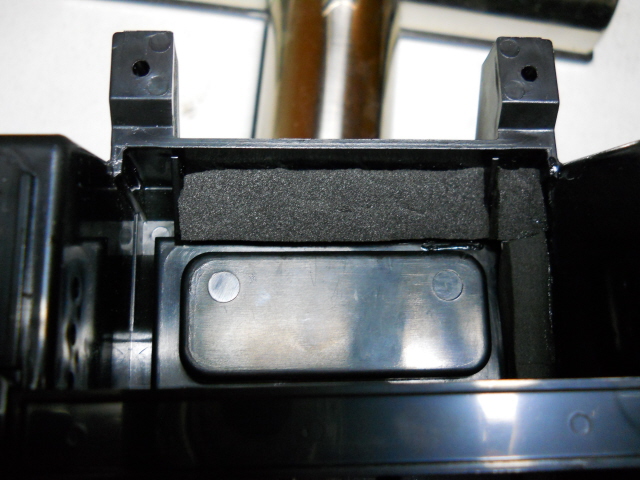

First mods to the chassis. I had held off doing any dremel work to the chassis during the initial kit build as I was not 100% sure what I was going to do. Now that I had picked a direction, it was time to get some clearance for the axle-mounted front servo.
Some black foam filled in the holes nicely.
Much better clearance.

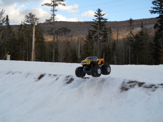

If you've watched any of my video's, you can see that I like to jump my trucks a lot. What was happening was that if the truck came down hard and the front end slapped the axle into the chassis, the plastic had enough flex to transfer the shock load to the steel axles, which don't like to flex......
So between that, and wanting a break from burning out motors, I switched to a single 3S lipo. The ones I had were a wider softcase, but they fit fine in the new front tray I had made. I had to add a 2nd strap, and all was good. The drop off in speed wasn't all that bad and the reduced weight lessened the chance of chassis-slap on the front axle.
