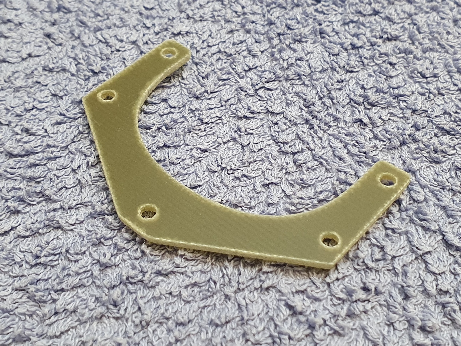

The 1983 Fantom had late versions that came with a separate FRP bracket to support the servo saver shaft from below. This was needed for the Tech chassis. At the rear of the Tech chassis, designed cuts allow for some flex and articulation of the motor pod.

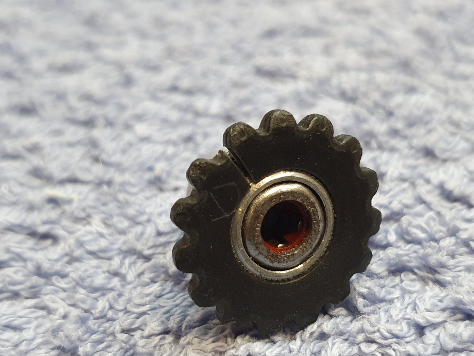

At this point I finally figured out why my chain drive wasn't spinning freely. The plastic front one way sprocket had cracked with age. Rather then press-fitting a replacement vintage sprocket and have that crack in a few years, I decided to use the alloy version of the re-released Fantom's.
