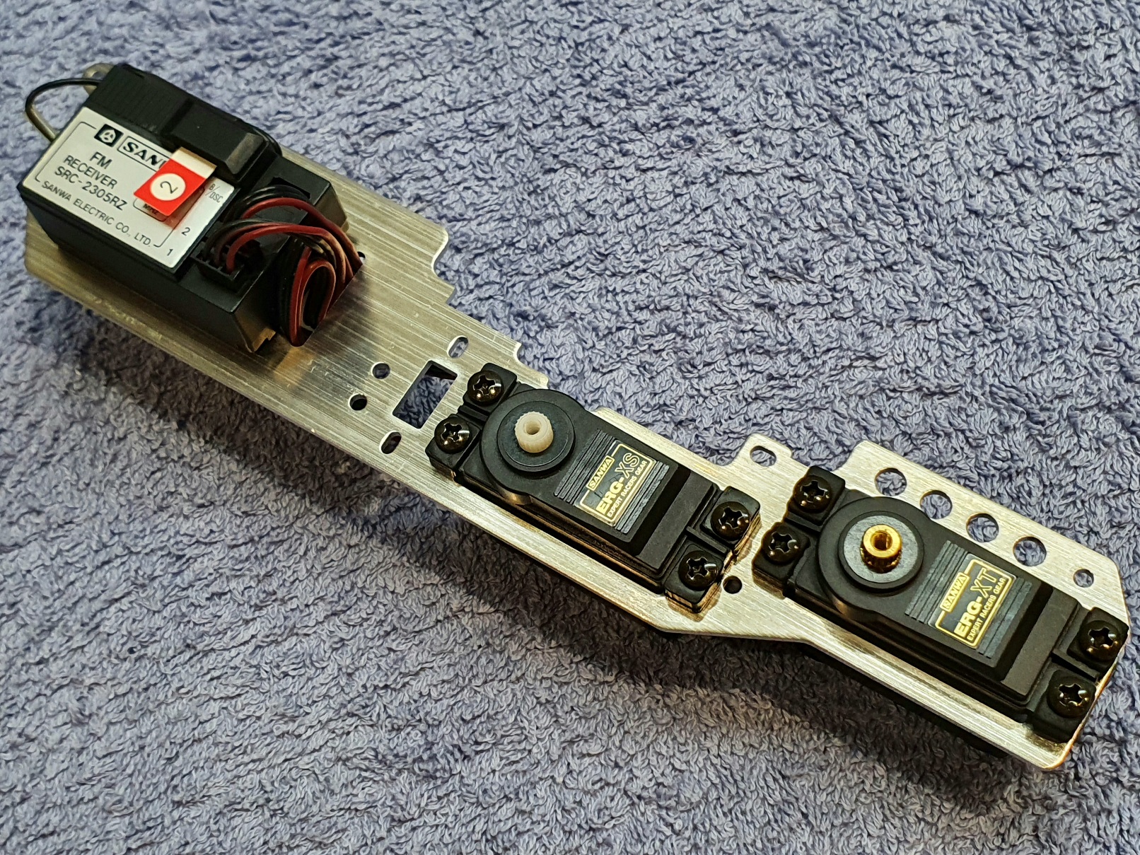

I've found my perfect radio gear for this build, a Sanwa Mzechs system with ERG-XT servo for steering and ERG-XS for throttle. This appears to be what was used by Kokushi Toge in his World's winning Inferno.
Took a little extra care to get all the throttle and brake linkages to all come together.
Job done, and now moving on to getting the body shell painted.
