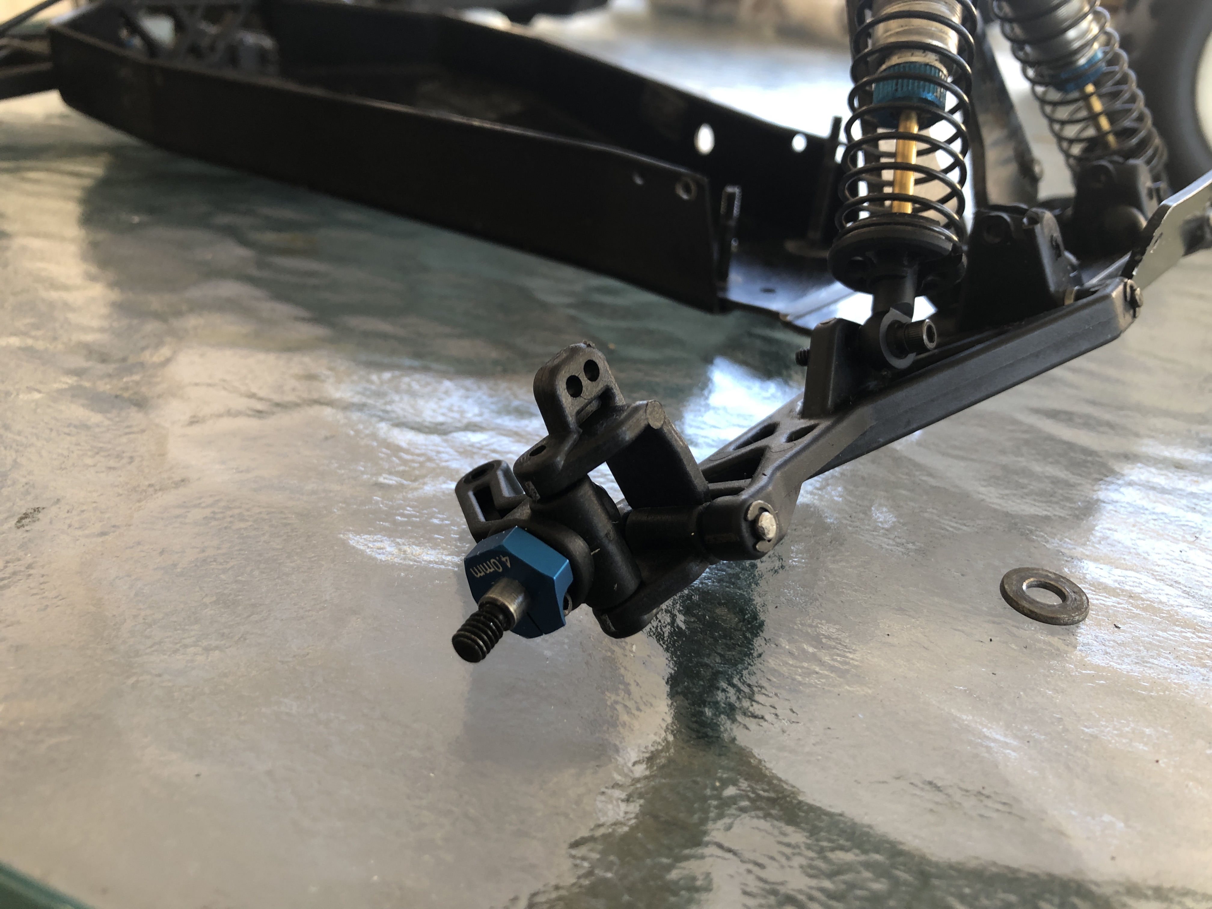

I am not sure why but I was compelled to get an rc10t2. I managed to be offered one at a darn reasonable price so I picked it up.
I spent the afternoon fitting it up.
So far I have 12mm front hexes on the b4 25degree caster blocks and some t5m big bores I got for a song.
Here it is so far.
The 4-40 nylon nuts are just right for spacing the big bores from the shock towers.
