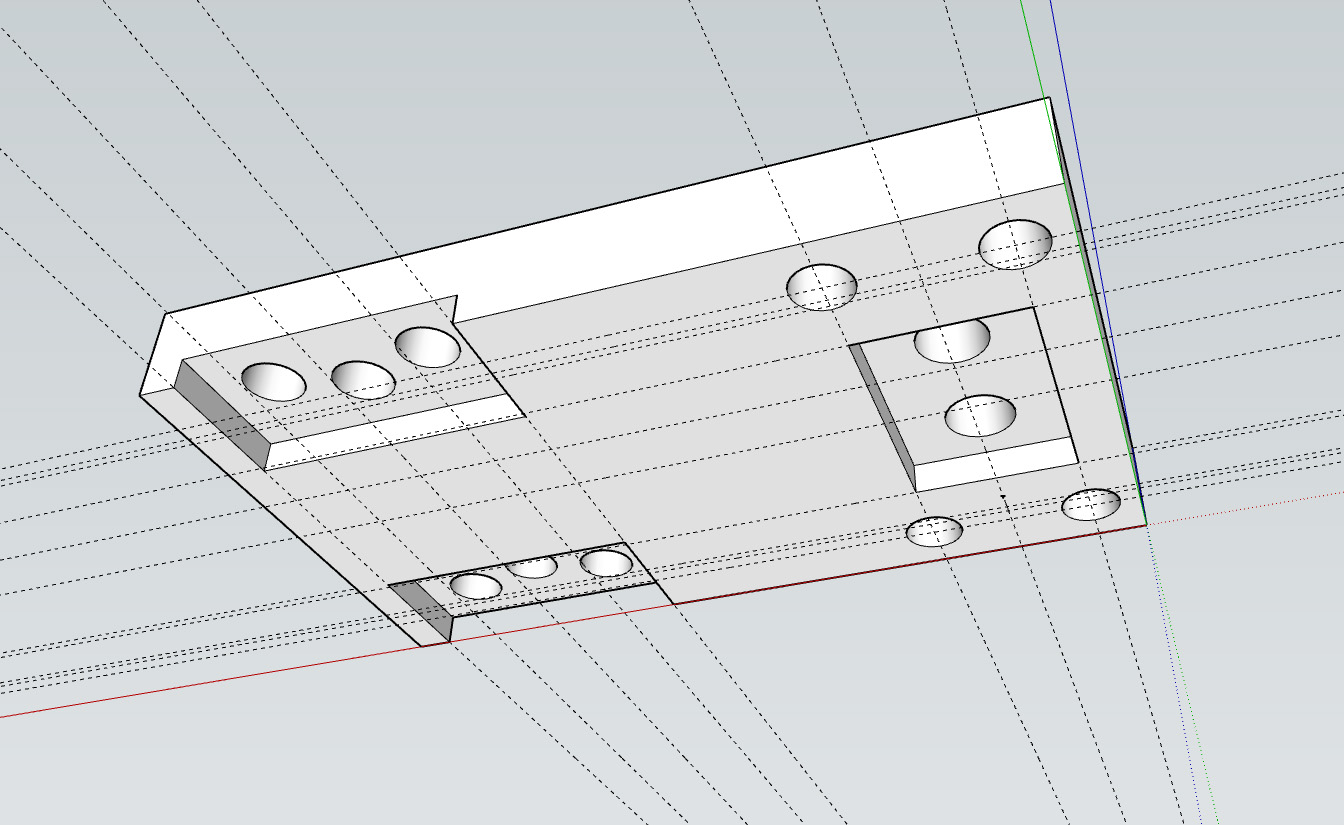

The rear mid-engine adapter was not an issue; I got it about right on my 1st, 2nd, maybe 3rd, okay it was my 5th attempt! The problem with trans plates and 6-gears trans is not the lack of holes to worth with, but the fact that the holes are so close together! Only those that have looked at it will get this, but once you flip the trans, you want your four trans mounting holes to line up equal-distant around the holes that used to hold the bulkhead. But one you start creating six holes that close together, and then trying to incorporate screw heads, it becomes a PITA. The same pops up in the back when you want to mount your bulkhead around the holes that used to be for the trans.
This is where my adapter sits at this point. I may very well wake up tomorrow thinking, "geez Robb you are an idiot! Why not do it this way?!?" And I will come up with a much better idea.
BTW: the driveline angle is no where near as bad as it looks in this last pic. That is just camera angle.
