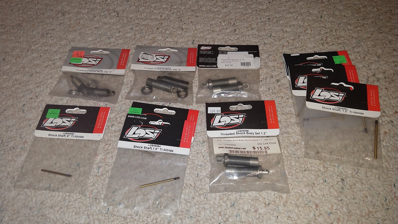

I'll add pictures of that later, but in my searching I noticed that losi threaded shock bodies are fairly available and would love to put a set on.
Does anyone know if the threaded shock bodies for the XX and XXX can be put directly on the Pro SE shocks? If so, do I need a set of 0.9in for the front and 1.2in for the rear?

All the info you need about running these is here. Use modern losa5015 cartridges and swap over your shafts and spring cups. Problem is even these are getting hard to find these days and subject to the high vintage markup as a result. You could probably adapt some takeoff 22 shocks easier.
https://www.rc10talk.com/viewtopic.php?f=27&t=19073

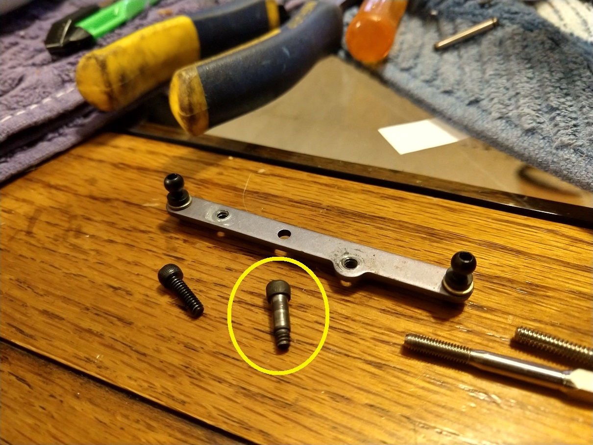

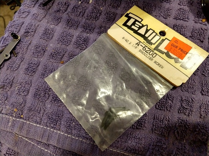

First, I got lucky and found an NOS pack of shoulder bolts, enough to redo my LXT as well, when that comes.

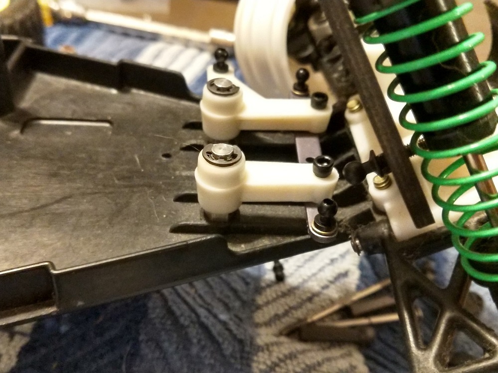

That let me pop on the NOS MIP Steering bellcranks with the bearings

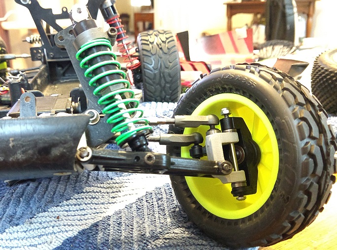

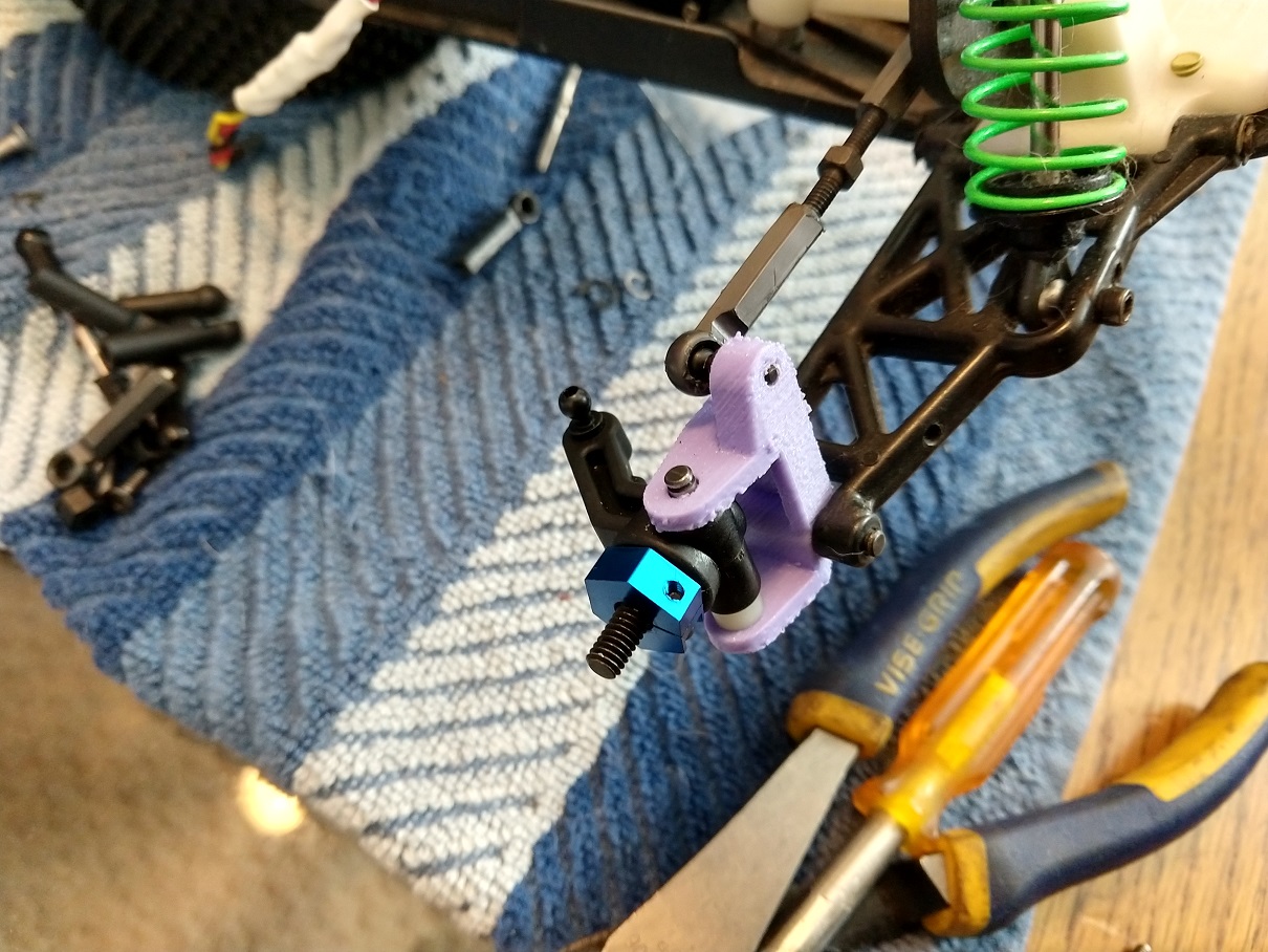

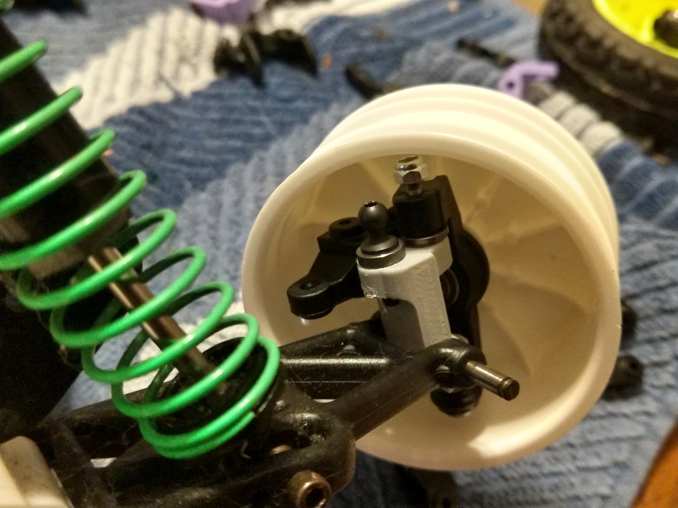

Then I modeled and printed a set of caster blocks to carry the TLR 22 Knuckles. It was interesting to see how much beefier modern parts are compared to the originals.
Currently they have Lazer ZX6 wheels mounted, but ordered some TLR 22 wheels. The current width seems pretty close to the rear spaced out with the B4 wheels, but I'm imagining I'll have to make another iteration to bring them in a little. There's not much room to do so, though. I'm also probably going to have to play around with location of the stud for the upper link to preserve the Pro SE's suspension geometry (actually, that of the Jammin Jay Steering Enhancement Kit), and I'm curious how wonky the steering geometry will be.

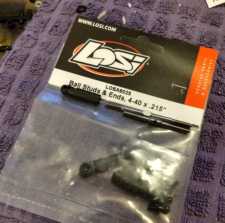

I decided to also try and convert the ball studs to newer losi 4.8 mm's so I can refresh all of them, since the 3 mm thread just fits through the 4-40 holes. Meanwhile, looking at parts diagrams I found the 4-40 studs are used on the center steering link of the TLR 22, which seemed odd since the stud diameters are the same as the smaller vintage ones, but I'll carry that over so I don't have to re-drill the sector arm (hopefully).
I also found that Losi converted to larger 3.5mm turnbuckles some time during the XXX's run, so I'm going to try and convert to that as well.

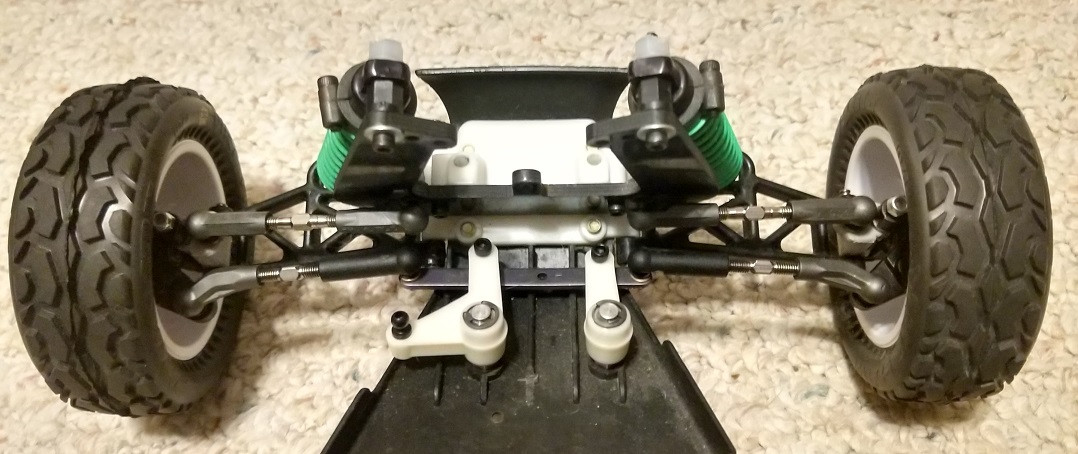

I made a lot of progress this weekend, but am going to have to really think about wheels. I'll post the bulk later, but here's what the front end links look like right now. I think I have B4 hex conversion front wheels on there right now, which I needed to match the current width of the rear, but the hexes are too deep for the new front axles.

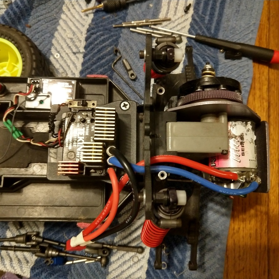

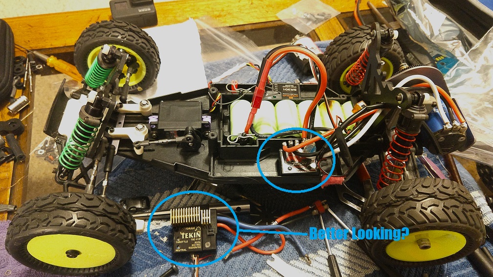

I stopped for a moment to get a (lousy) image of the last electronics setup. Originally I had a Tekin 411P cable tied to the rear shock tower, but some years ago I popped a component on the board and found this 411-G2. Also I found a couple of the RPM speed controller mounts to try and get a cleaner and more secure chassis. But this time around I want to go brushless. Ideally I'd find a good reversible ESC that can fit in the side tub. Then I'll let my old brushed stuff go on to someone else.

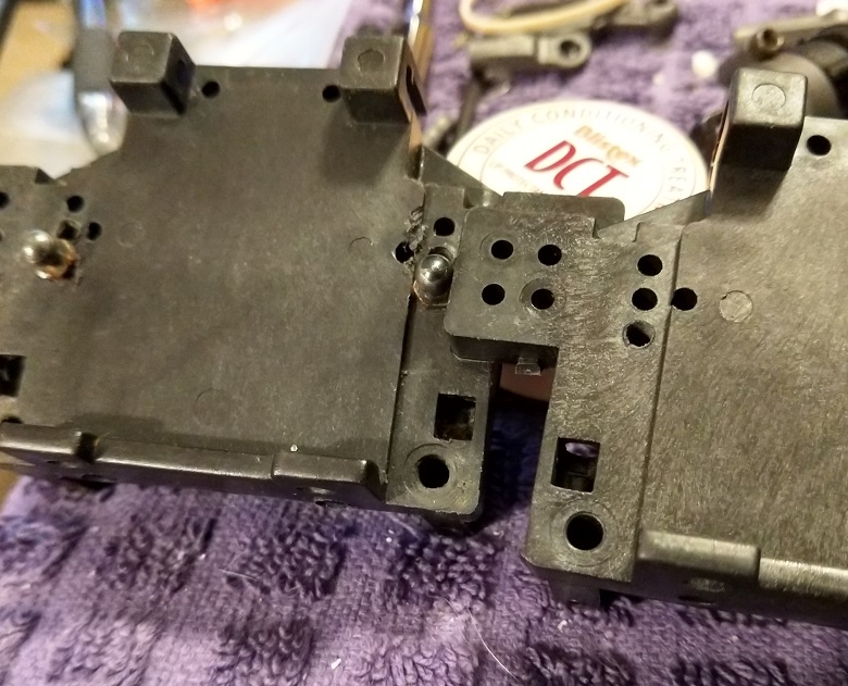

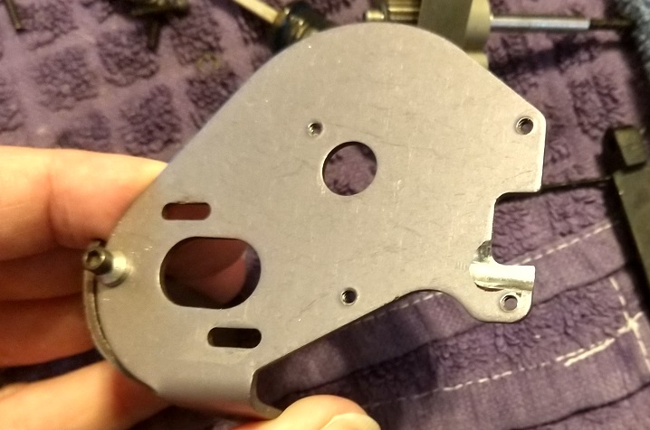

While it was out I tapped the bulkhead and rear uprights for the new TLR22 ball studs and ran into an interference issue. The motor plate wouldn't let the larger tie rod end fit, so I had to break out the dremel and create a little clearance. Fortunately it didn't take much. I don't have an image, but I used a longer than normal ball stud on the bilk head with TLR22 spacers to try and get the rear camber links to be more parallel with the H-arms. This also meant had to do a small counter-boring on the bulkhead to let the TLR22 ball studs fully seat, as there's a small step that would interfere with the spacers.
I put all the suspension back together with the TLR22 and XXX ball studs and tie rod ends and did a rough setup. Eventually I'll need to get proper length 3.5 mm tie rods. But also I want to look into better tie rod ends. The TLR22 rod ends are much sloppier than I had hoped they would be, and steering slop is what prompted me to do this in the first place. I think I was using TLR22 3.0 or 4.0 tie rod ends. Are the 5.0 tighter? Or should I look at an aftermarket set?

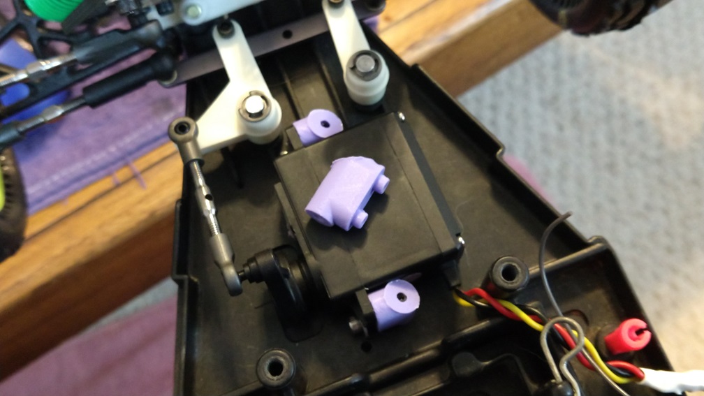

I put the slop aside for now and went to work on re-mounting the servo. Especially on my LXT, I always hated how I had mounted it and wished to square it up. I did a better job on this buggy than I had done on the LXT, but I had used a small pan car servo saver and still mounted the servo skewed. I had to do buy a few servo savers to find one that fit the way I wanted, settling on a Axial part. I also modeled and printed new servo mounts that would hold the servo as close to the chassis plate as possible. I drilled a new set of holes, but still ended up not getting a perfect fit and alignment, but with a spacer under the ball stud I think it'll work. I'll re-evaluate when I get power to it. Might take a little strategic filing. If all else fails, Axial included a shorter servo horn.
So now I'm shopping for an ESC and motor. Here my choices aren't going to make the most sense as I'll be favoring style over substance.
I wanted to get a visually appealing motor, since that's what I remember about RC motors from the early 90's: brightly colored labels/cans hanging out of the back of the cars. Looks like, today, they're mostly black, I guess because they're hidden under the body when running. I also wanted a Trinity because Losi was teamed with Trinity , and Trinity was a pretty ubiquitous brand back then, even though I think a lot of others were better. I also wanted a little bit of heat, and I eventually found Trinity's D4 had a nice gunmetal can with an purple endbell, and came in a 13.5. Unfortunately I missed an auction for one, and another I was interested in was buried in a lot of motors that the seller wouldn't separate. So the search continues.
For an ESC I want two things: reverse and to be able to mount it on the chassis plate instead of the shock tower. The latter is a tough requirement: the pocket on the side of the chassis is less than 30 mm, and even the Kyosho Le Mans controller is just a couple mm larger than that. Looking around I found that current Tekin ESC's are available with reverse, and have widths available under 30mm. For the added nostalgia, I ran both my vehicles with Tekin controllers ever since I started racing, so that's appealing as well. Unfortunately, those controllers aren't cheap. So I'll look for a used on on eBay for a little bit before I look to buy one of those.

Got a Tekin RS in the mail, today! Threw it right in just to get power to the car for the first time, so wiring is a mess. It's dark, cold, and rainy right now so just aligned the steering and scooted around the carpet a bit. Quite exciting! Has a really tight turn radius. But don't really have a feel for handling.
Need to tune and teak a bunch of things. The Tekin, unfortunately, while it is close, is just a hare too big to fully sit down in the side pocket of the chassis, thanks to the draft on the chassis ribs. I think I'll model and print a holder to sit it at an angle, though it's so small I might consider up around the rear shock tower, again.
I'm already missing the black/gold the vintage Tekin had so, I was wondering: did I see that someone here makes vintage labels for modern electronics? If so, that might have to happen once I get it positioned
