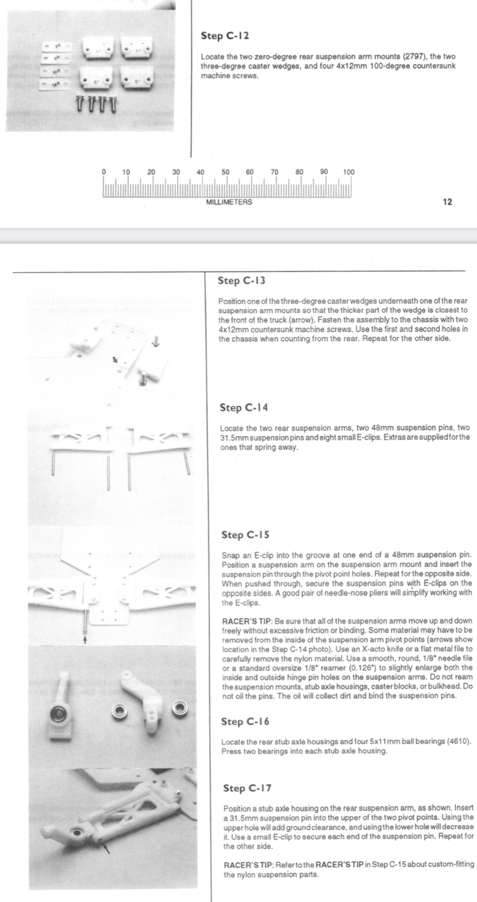

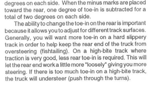

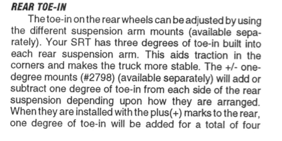

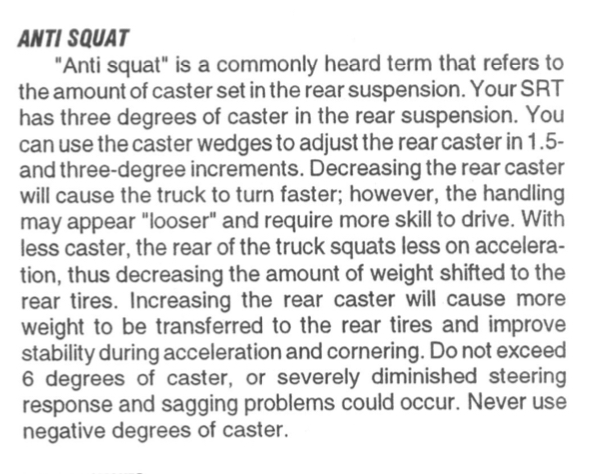

The rustler is a close relative of the SRT (electric) and uses pretty much the same rear suspension. Here are some clippings from the manual that may help.

Thanks! That is really some great info. I have the wedge pieces and the mount for the swing arm on mine has a "A" and a 1 below it. It looks like those are still available so will look into that. This is why I joined. Just good info and no saying " this has been written about a million times...", its still relevant to guys like me who are just trying to get their old stuff back up and running.

I did as suggested and got the toe almost to 0 degrees. I really don't need it neutral but thats how it came out by switching the rear swing arms. I did order some degree blocks and the 1.5 hub carrier to get the toe closer to my SRT electric truck. I am also refreshing the engine, fuel line, glow plugs, front carb seal and an air cleaner. Will post some pics someday for the the hell of it. Will be a backyard or vacant parking lot runner for now.
