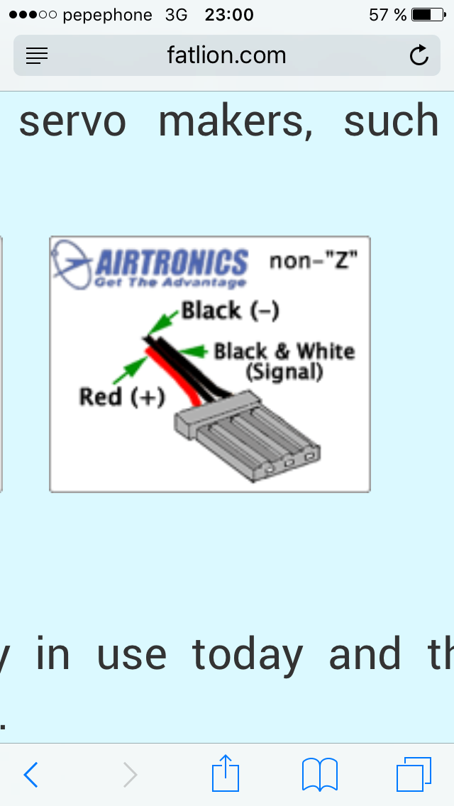

Does anyone know which wires are signal/+/- on the receiver plug? Mine are red/black/black, not white/red/black like most of the photos I've seen.

The red black black receiver wire is very probably airtronics. I have a tekin with an airtronics pigtail.
I don't know the pinout by heart but red is power, one black is signal and the other is gnd. Lots of servo pinouts found online between all the brands.

On the old Airtronics the pin out is: Red 6v; Black(middle) Gnd; Black (outside) Signal.
