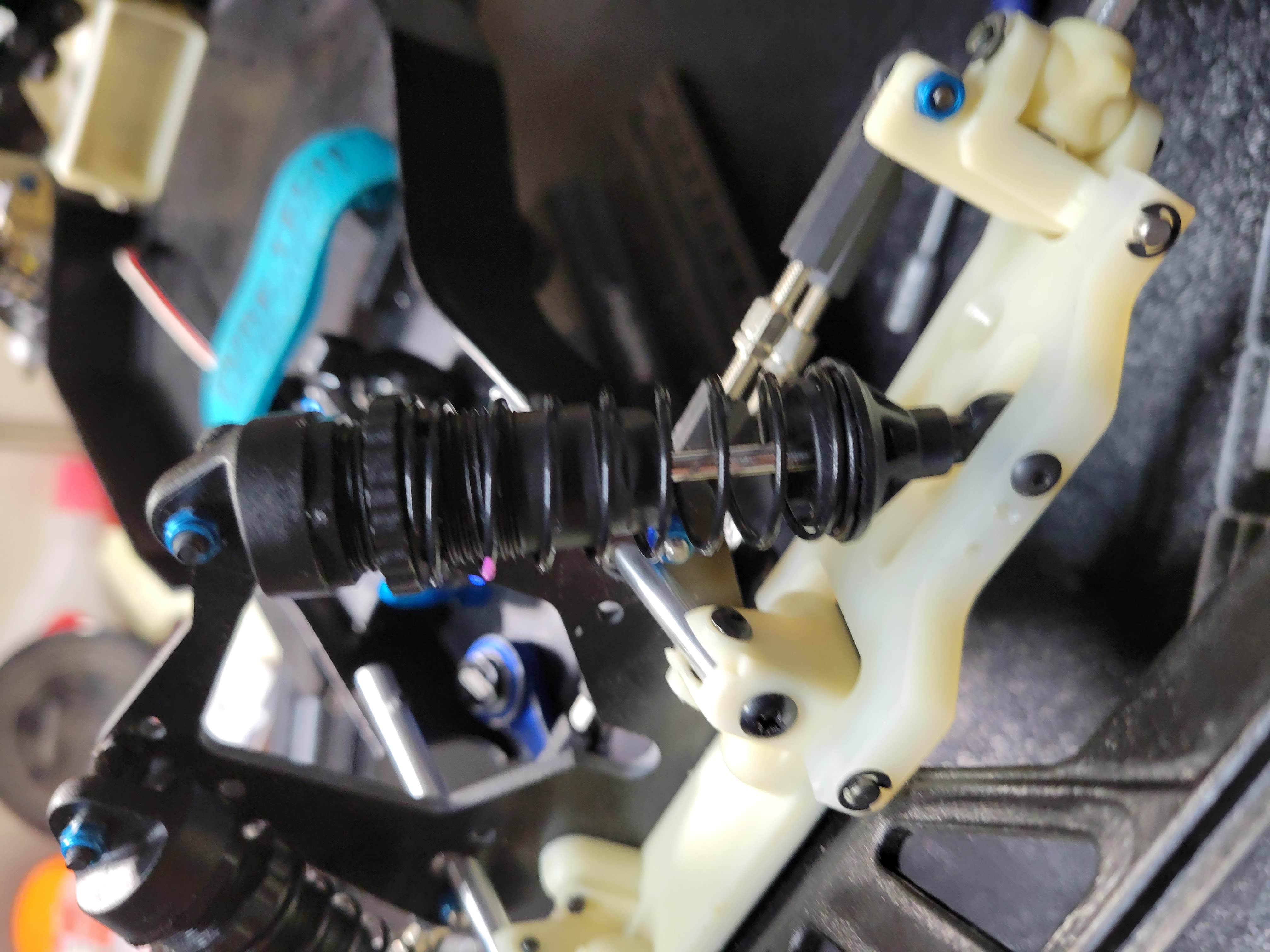

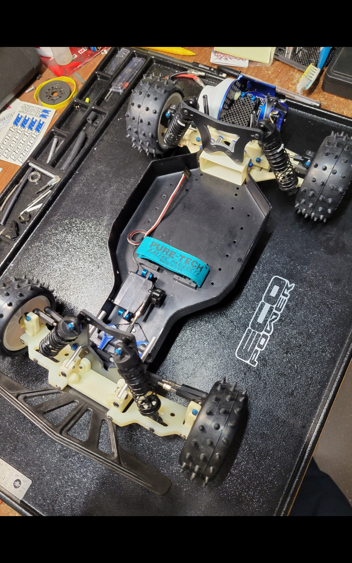

This is a long term project. It has actually been sitting mocked up in semi-complete form for a while. I had to partially disassemble it to fix some things, so I took a few pics.
The basic lowdown:
- B stamp pan with shortened truck nose plate and bulkhead. JConcepts honeycomb motor plate and wing tubes.
- Dynotech front arms and Andy's rears, with Factory Works towers.

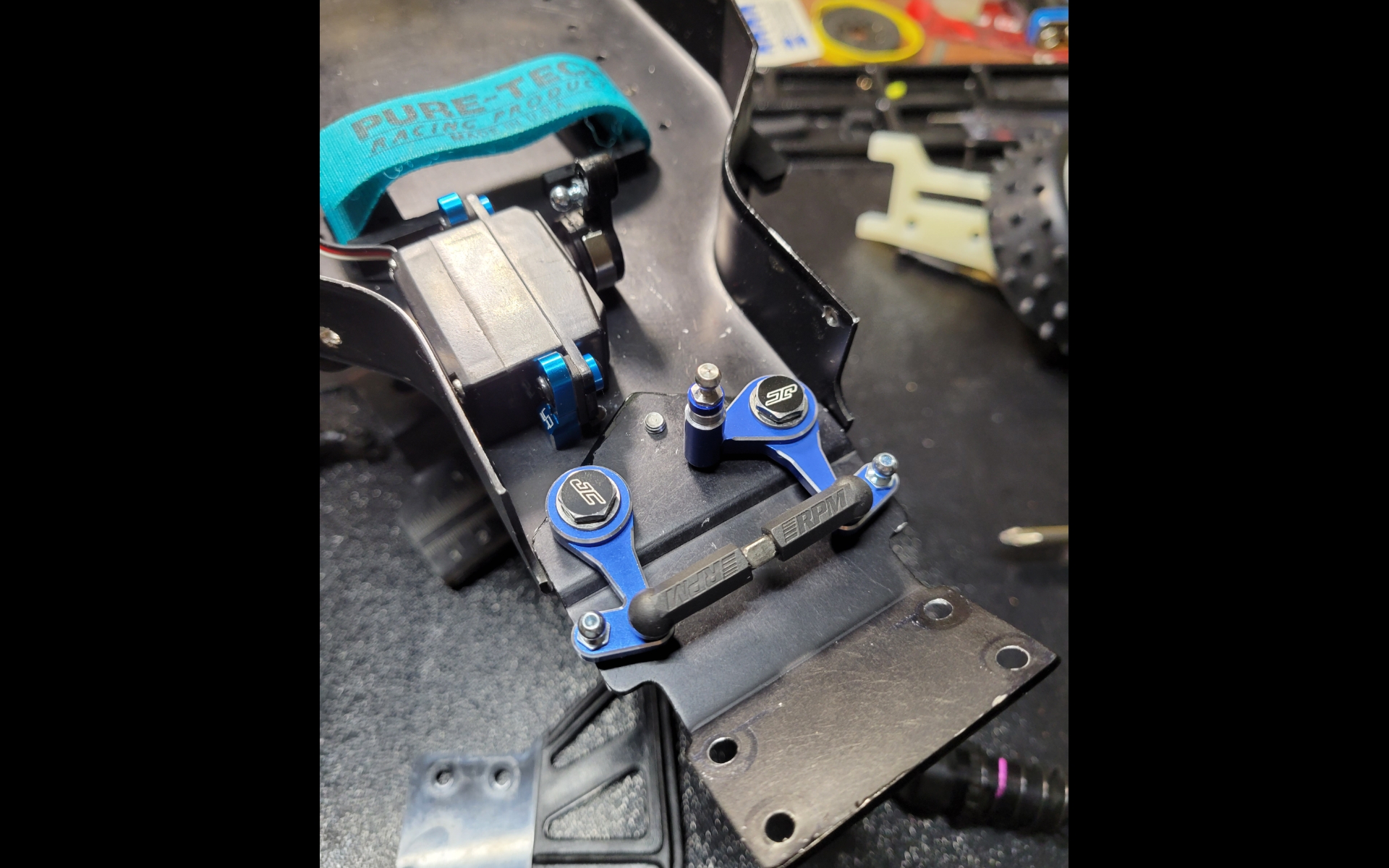

- Stealth transmission with a T4 shaft and slipper. Titanium dogbones.
- JConcepts bellcranks and a Futaba S132.
- Associated MT10 big bore shock bodies with shorter shafts and buggy springs. B5 spring cups.
- JConcepts from wheels and Traxxas rears, with Schumacher full spikes.
- Tamiya Super Stock TZ, 23T motor (it matches).
- JConcepts Worlds Dominator body, cleared to fit the RPM/truck front end. Andy's front bumper.

While I was at it, I decided to go ahead and mount the electronics and wire it up.
I went with a Novak Polaris receiver and Hobbywing 1080 esc. I swapped out the original XT60 connector for a EC3 and crimped some bullets on.
Made some new motor leads as well. I prefer for them to come from behind.

I really like what you did with mounting the rear tower on standoffs to get it in front of the big bore shocks. 8)

MarkyDents wrote: Sat Jul 24, 2021 3:46 pm I really like what you did with mounting the rear tower on standoffs to get it in front of the big bore shocks. 8)
I can't claim the idea. I seen it on some other cars here.
Otherwise, the shocks would have to be at a foreword angle.

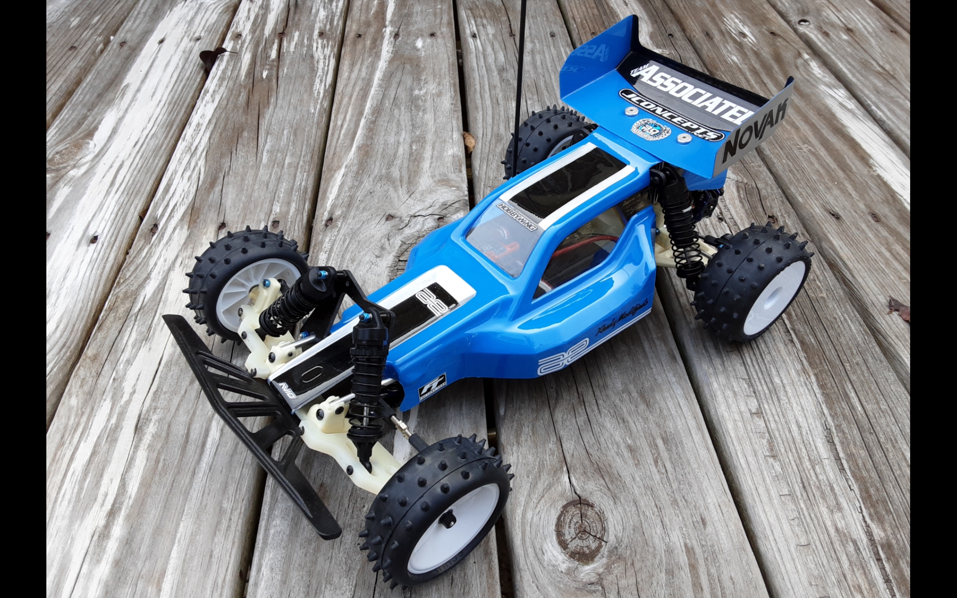

Finally got a little paint on this one. The primary color is Tamiya brilliant blue with Duratrax metallic black and silver streak.
I also did some mixing of modern and vintage decals, seemed appropriate.
I still need to add some velcro for the front body mounts but I'll give the paint some more time to cure.
