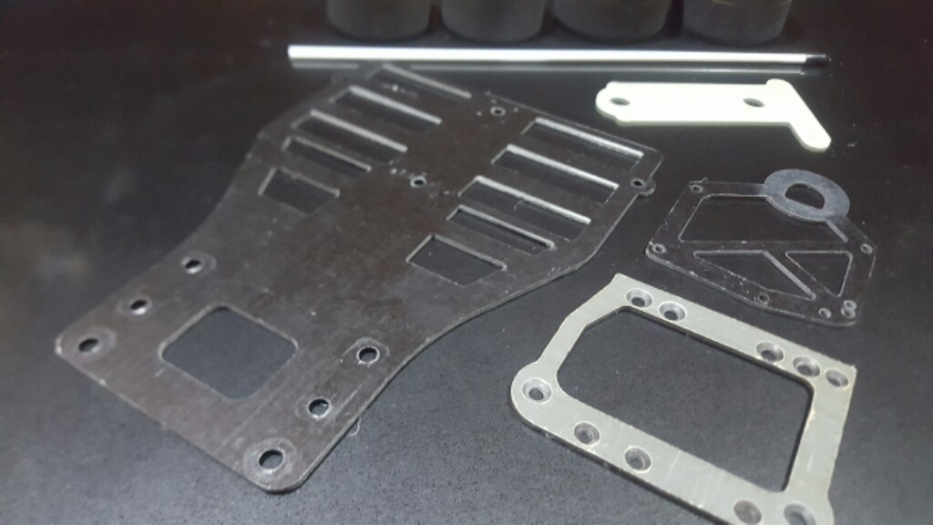

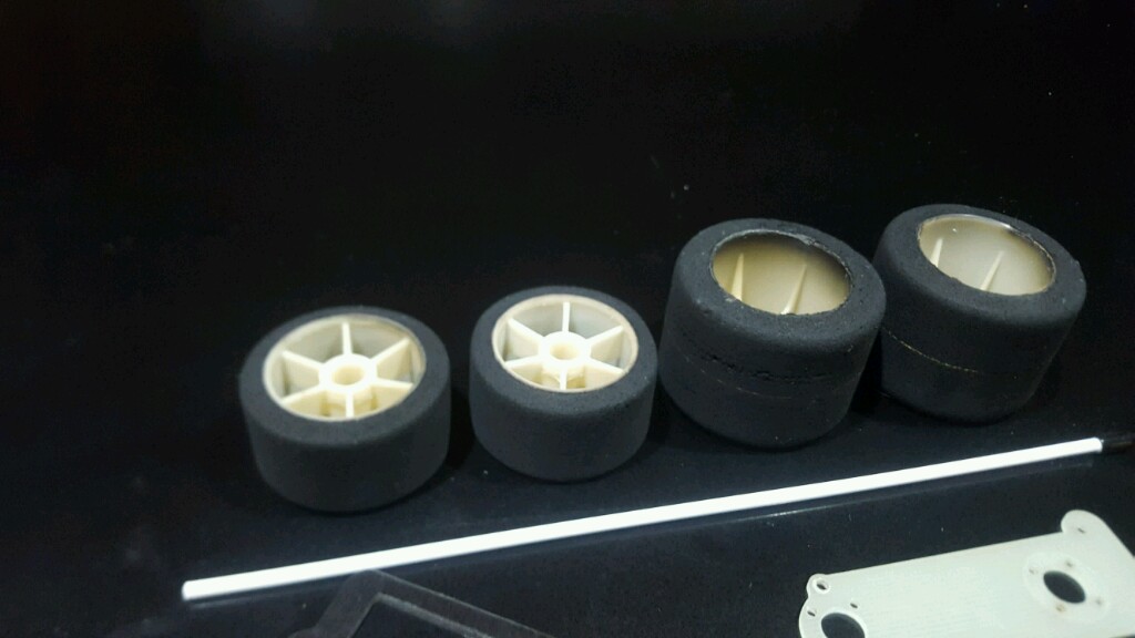

Ì received this 12L the other day from LurkingCAT which was in pretty good shape for its age. It will be a tennis court runner since that's about the only place that I'll be able to use it. The surface of the moon is smoother than Astralian parking lots and roads.
I will likely do an 80's themed stock car complete with vintage radio and fiberglass roll over antenna to compliment the vintage theme. I'm actually really looking forward to it......
Here's how I received it.

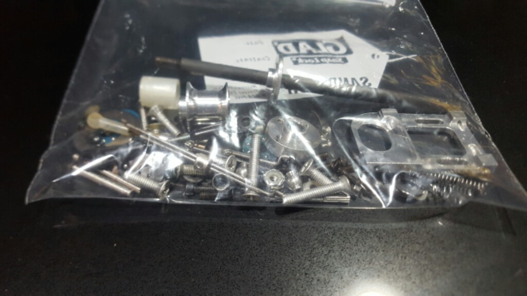

I couldn't help myself
Nearly ready for reassembly already

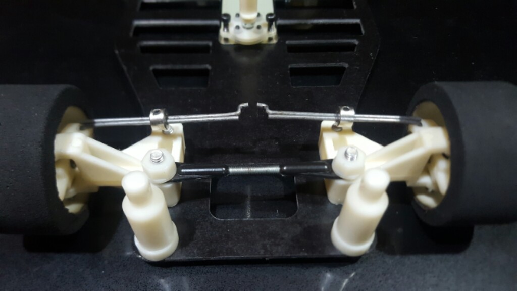

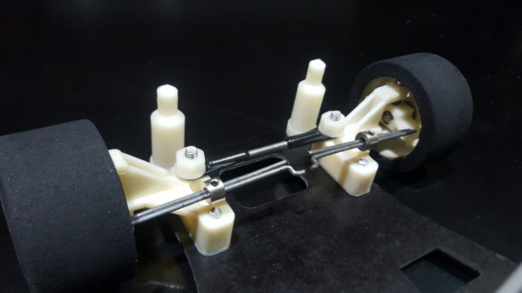

Not that there's much exciting about the front end of a 12L but here it is assembled on the car..... complete with high performance spring steel turnbuckles
