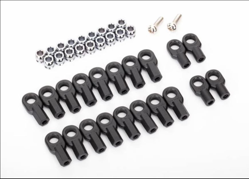

I only find one reference to the size of the 7028's and they call them a 4.5mm ball making them too small. I use the 1942 rod end set, they are replacements for the old school ends. That part number goes back to the Eagle.

I have a 1942 set in front of me. The pivot balls measured 5.75mm.

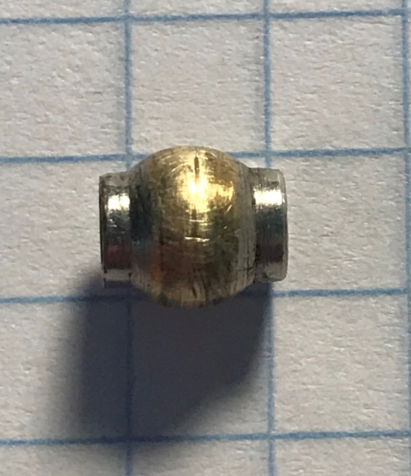

Thanks everyone. The original balls look to be 5.7mm in diameter and 6.33mm (1/4") in length. While they are similar in style to the 7028's it appears they are too small.

I measured 6.3mm.gtrgeo wrote: ↑Wed May 19, 2021 5:22 pm Thanks everyone. The original balls look to be 5.7mm in diameter and 6.33mm (1/4") in length. While they are similar in style to the 7028's it appears they are too small.

I believe the 1942 set has the four round shank ends for the shock rods as well. They fit the underside of the spring cup and are slightly shorter as well. The balls in the 1942 kit fit the older style white and gen2 black rod ends. As previously discussed, they are a direct replacement save for the flared and ground flat ends that serve stabilize the ball and distribute the pressure when tightend against the nylon parts.

This makes sense from what I am seeing. It looks like I would have enough to fit the whole car and have a couple of spares. I like the idea of the flat ends on the pivot balls as the straight cut ends on the vintage balls tend to cut into the arms making for a finicky fit especially in the front arms.TRX-1-3 wrote: ↑Wed May 19, 2021 6:15 pm I believe the 1942 set has the four round shank ends for the shock rods as well. They fit the underside of the spring cup and are slightly shorter as well. The balls in the 1942 kit fit the older style white and gen2 black rod ends. As previously discussed, they are a direct replacement save for the flared and ground flat ends that serve stabilize the ball and distribute the pressure when tightend against the nylon parts.
