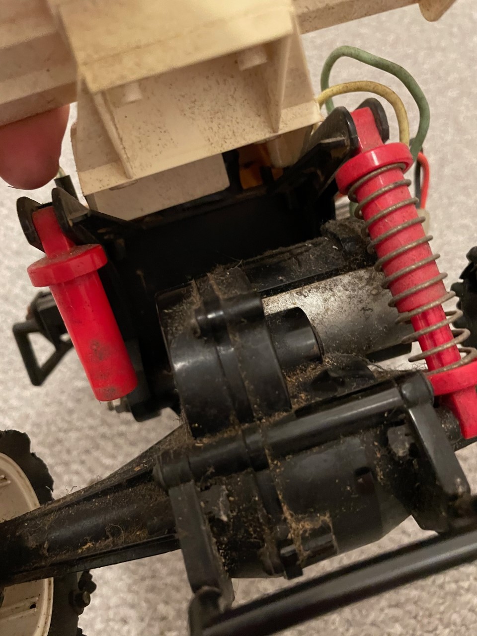

I was given this Nikko F10 Rhino in 1987, one outing a rear suspension was broken (I was a small child) and never repaired, put into storage only for me to dig it out a few days ago.

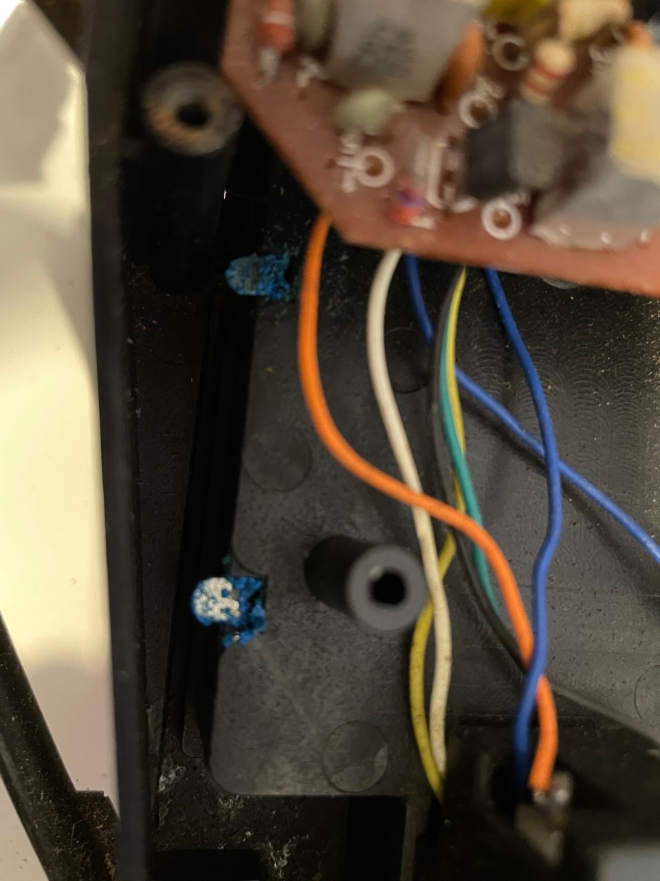

- I have no idea where the transmitter is, battery, box or chargers so I assume it is straight forward enough to replace the entire electronics system for new?

- Need the rear shock, one is broken. My first thoughts, I can 3D print a replica of my undamaged one? Any potential off the shelf replacements?

Converting the buggy to hobby grade is cheaper and will drive better.
* Rhino electronics are compatible with 27Mhz hobby grade transmitter. Clean the electronics with window cleaner. If it doesn't work, you can buy a transmitter / receiver (27Mhz or 2.4Ghz), Esc (speed controller) and 3 wires servo.

Started to design suspension parts to print.
