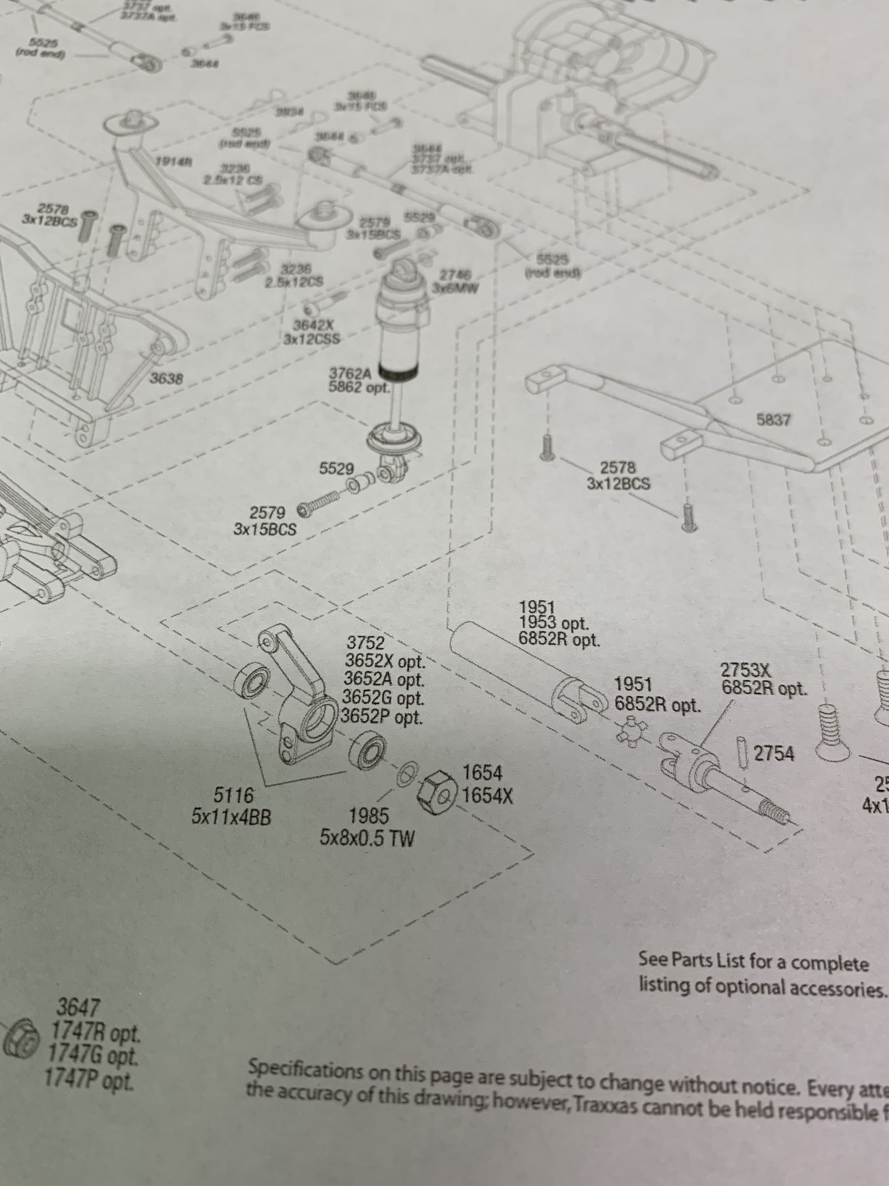

Thanks Matt and Todd. I chased down the Traxxas part option as I had a Slash at home. Turns out it works with minor modifications. I like this approach because these parts are available everywhere. I was able to use the Traxxas Slash caster blocks (3632), steering blocks (3736) and axles (3637) for the front end. The only modification that was necessary was removing a small amount of material from the caster blocks to make them fit into the XXT arms. For the wheel hex I used a thin ~2mm hex which allowed me enough thread on the axle to run wheels intended for the TLR 22T.
Had to remove a small amount of material from the caster block to make it fit into the arm.
For the rear, it was more of the same. The axle carriers (3752) and axles (2753) are from the Slash. I also used the metal u-joints which you get with the half-shafts (1951). Those fit right into the Losi yokes. I had to use the upper hole on the axle carrier when installing the hinge pin to carrier to allow the assembly to fit into the wheel. Again I went with the thin (~2mm) hex but on the rear I didn't get as much thread engagement with the wheel installed. It'll do for now but I may look to find an alternate option with longer axles. I could also just run Traxxas wheels which would fit just fine.
One final note, I did have to move the location of some of my ball studs at both the front and rear to accommodate the Traxxas parts. Overall it was a pretty easy conversion which will allow me to run contemporary wheels and more specifically, the same wheels that I run on my TLR 22T which for me is very convenient.

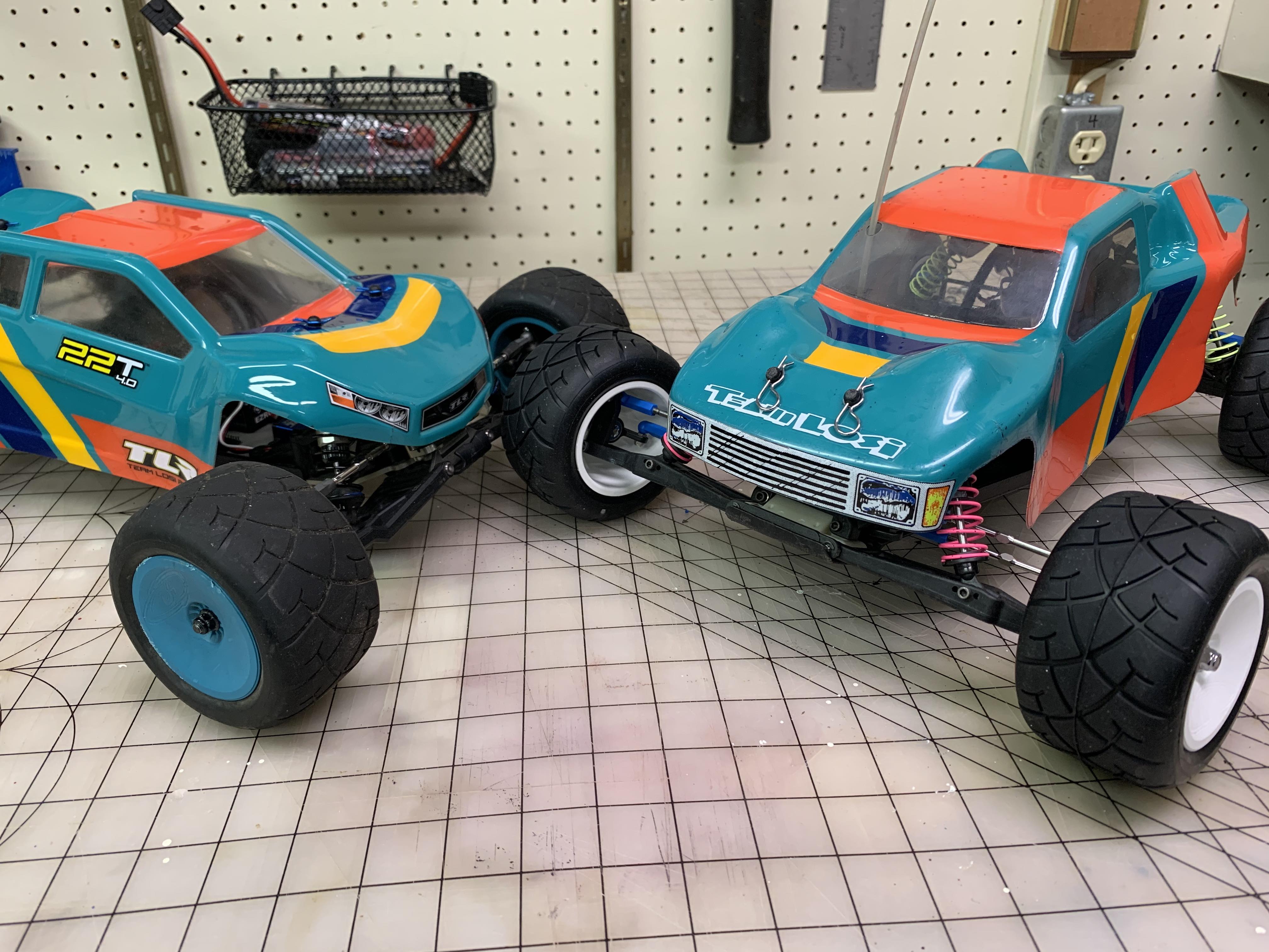

Posted: Wed Aug 26, 2020 7:18 pm
by kzeppelin2
Finished painting the shell. Chose to match the theme of my 22T. Just need some stickers to finish the job. I didn't care much for the mid-90's colors on the original XXT stickers so I'll likely order another set but with different colors.
