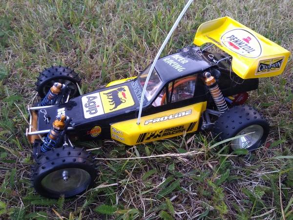

I wanted to post a couple of updated pics to show where things are at (thanks all for your help so far). I don't have a before pic but I am guessing I have gained about 3/4 of an inch of clearance, the front in particular is sitting a lot higher and I can at least get it moving through the grass now, before it would be too much work
That said, I also decided that my 35 year old brushed motor is probably past its prime, so I also ordered this https://www.amainhobbies.com/hobbywing-xr10-justock-sensored-brushless-esc-sd-g2.1-motor-combo-17.5t-hwa38020241/p784984
I am hoping that with that motor and the small pinions (9t or 11t) that I can drive around without over heating everything. Although as you can see from the pics there is going to be grass brushing the underside.
