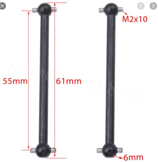

I have used 02003 HSP dogbones as replacement. The length is just about right, and they are much easier to find.
Re: RC 10 Stamped A #6370 Dogbone Replacement
Posted: Tue Jan 07, 2020 2:49 pm
by XLR8
Well, how about that! You're right.
The 02003 is slightly shorter pin to pin than 6370 (55mm vs 57.25mm) and the pins are slightly smaller (2mm vs 2.38mm ) but it's certainly close enough. The ball diameter is about spot on.
Also, they sell a 08061 that's 3mm longer than 02003.
And they're cheap as chips on ebay. That's awesome! Thank you for posting this info, I've learned something useful today.
