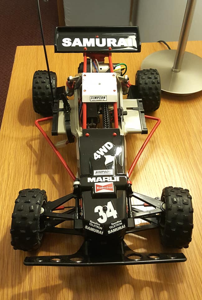

Another car which has always been on my wish list has somehow come to me.... purchased on a bit of a whim to take away to work with me to ponder over during the festive season.
I have always wanted a Samurai and spent hours and hours watching the promo video spool around again and again in my local model shop as a kid.
I asked a few questions and the seller was suitably vague, and as a result i have spotted a few (common) issues but i will work through it and hopefully come up with something tidy in the end. We always modify our cars so hopefully i can add some strength wherever I can to make something I can actually use. I would love to be able to put it out onto the track eventually, so that is my final aim point.
The car came with the usual red shell, plus another one in black. I actually prefer the black but will do another anyway to add my own twist to the car.

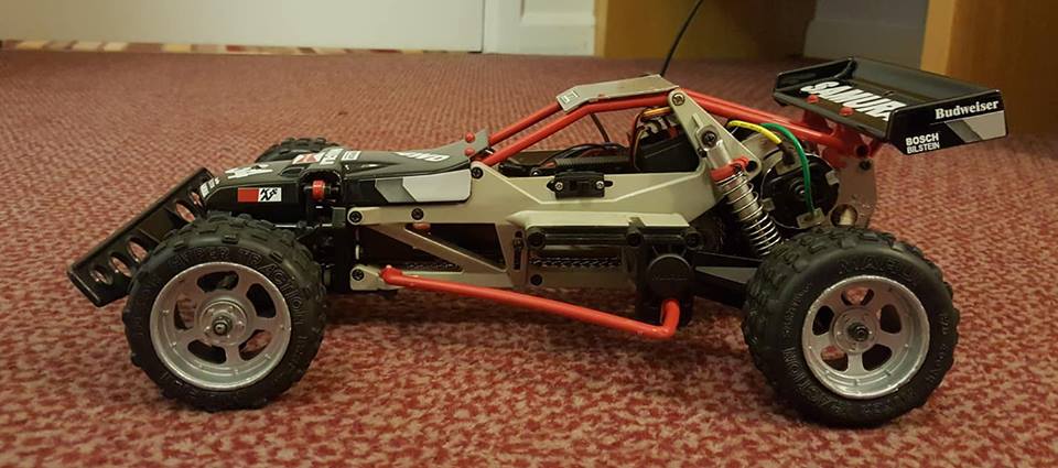

If I think 'Samurai' the first thing i can picture is those stunning wheels, so i will most likely try to keep the originals on for the shelf, but on the track i will go for something a little different to enable me to run some more common tyre choices.
So here it is as delivered - they always did look great :-
Not too bad on first sight..... however upon closer inspection the very rear point on one of the grey chassis side ladders has cracked and been glue-repaired, and the rear gearbox also has a little crack damage. Both will require replacement if i intend to use this in anger.

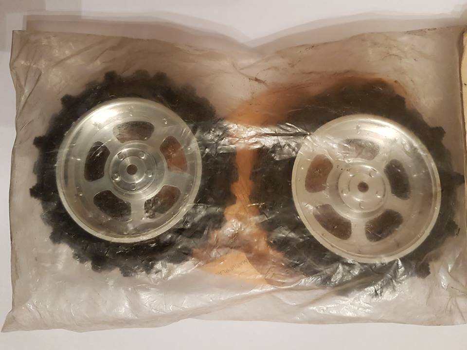

Having posted up a couple of pictures on the book of face i stumbled across a guy who had made some adapters to allow him to fit alternative rims, and a short message later he offered to make me a set and send them over in true festive spirit, for just the shipping cost. Excellent - one box ticked.
I then saw a brand new pair of front rims and tyres pop up, so they came my way too.

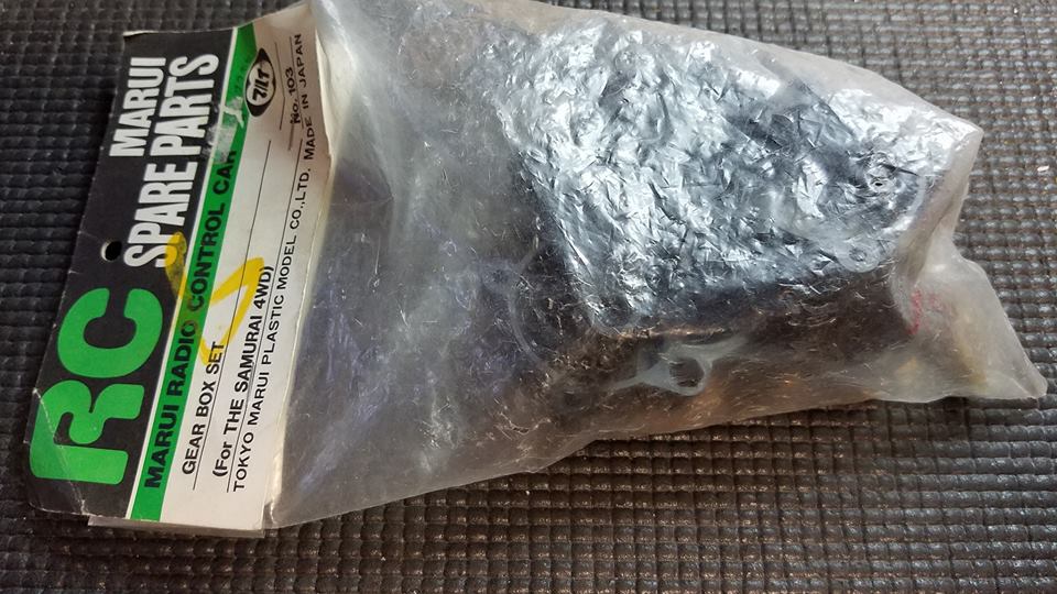

So...... now on to the rear gearbox. Firstly, can anybody help on here? I have heard reports that somebody has had the rear gearbox casing 3D printed, which would be pretty epic.... if anybody has one going spare it would be massively appreciated so please get in touch.

Well that didn't take very long.... the lesser spotted rear gearbox!!

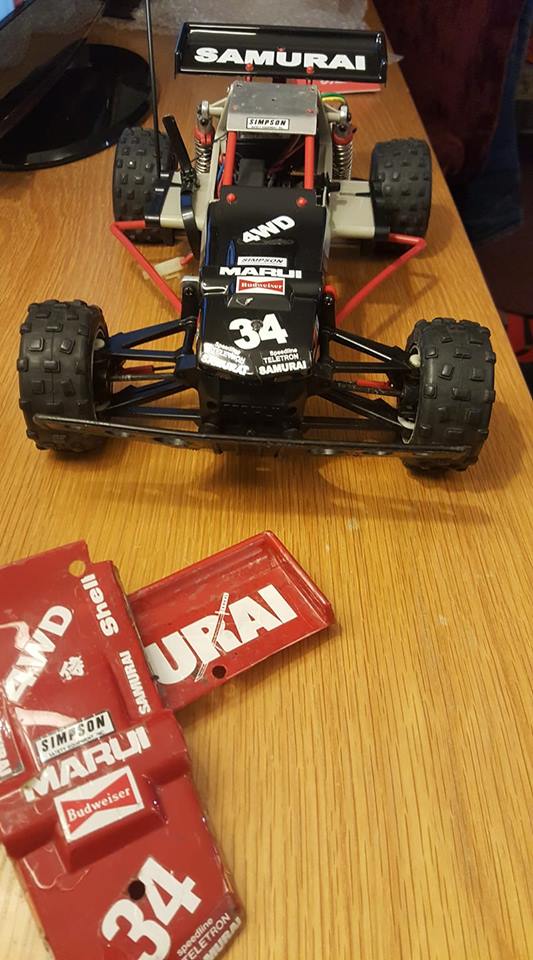

Today is just getting better and better! All three Unicorn pieces sourced in 48hours 8)
The elusive rears.

Mad thin:fat tyre combo on these as standard.... i wonder what that was all about bitd? It's the total opposite of the fat:thin 80's BMX tyre combo :lol:
