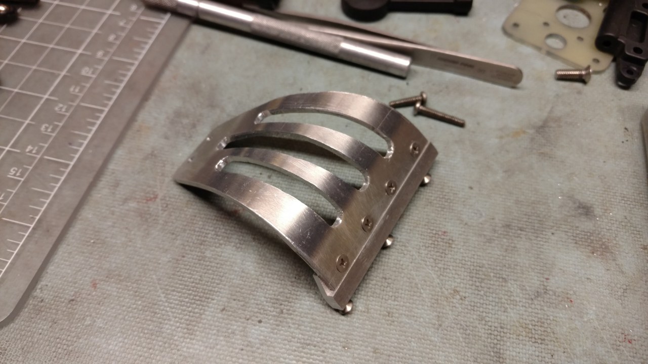

studied a bunch of mid motor stuff and decided that a waterfall type brace makes the most sense, so again to the aluminum sheet stock, transferred from some mockup cardboard, bent and mounted with a machined lower bracket:

Looking awesome so far!!!
That waterfall is, like, wow :shock:
