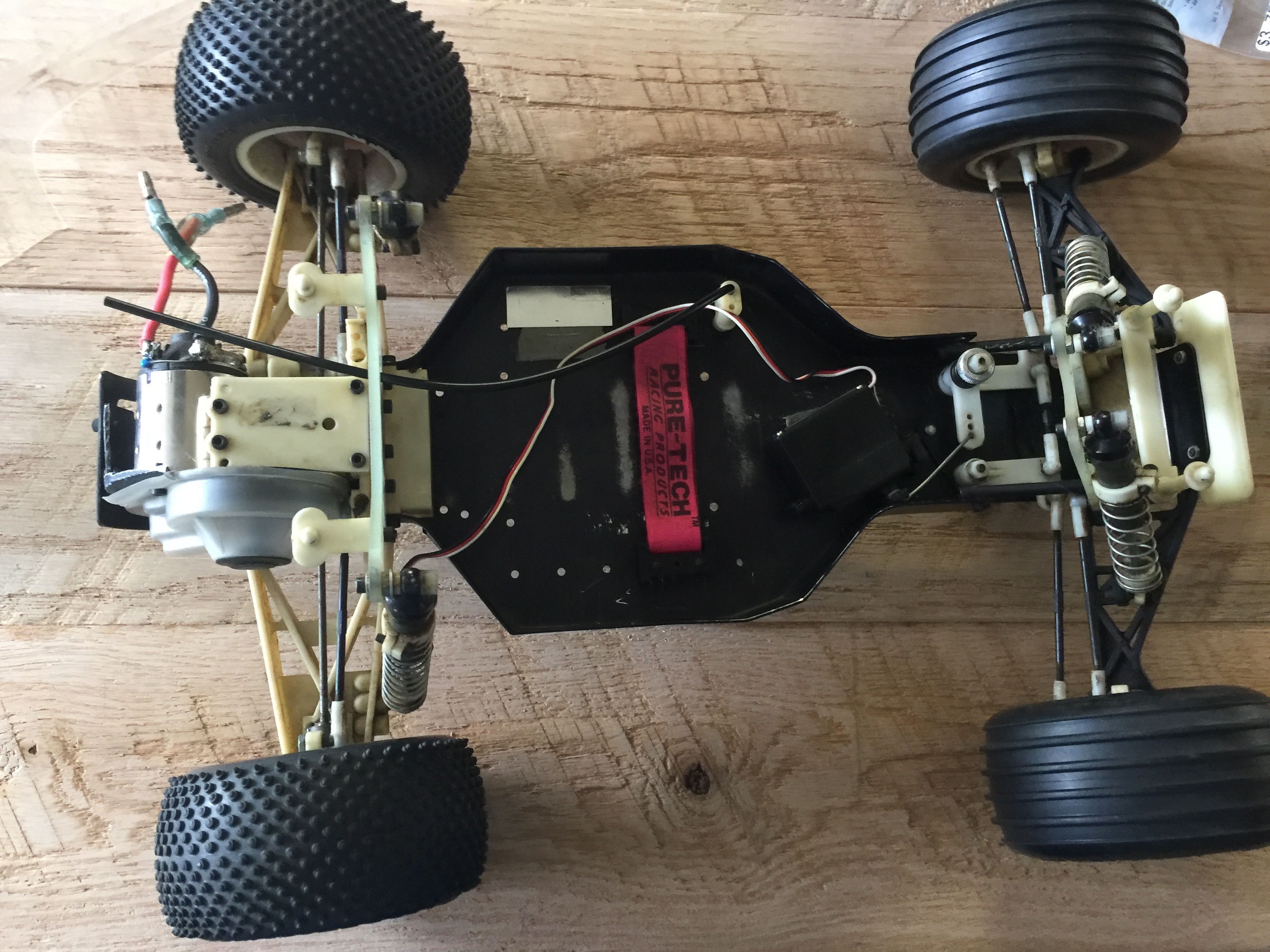

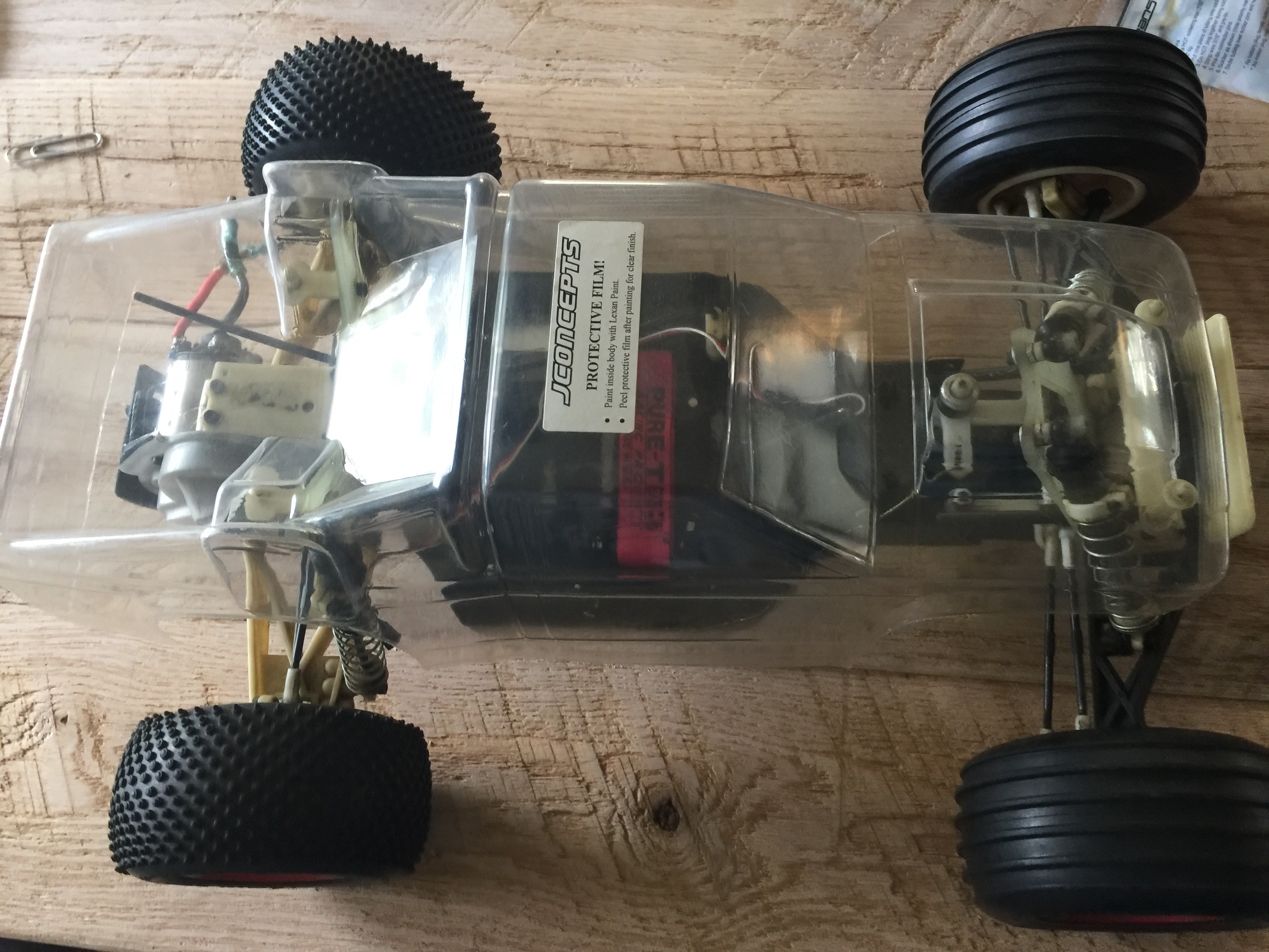

I always wanted the RC10T. So, I made a rash decision and picked one up on Ebay. I didn't want to really mess to much with my childhood RC10 as it is almost new. This just seemed like a better way to have an RC10 to go drive and let my kids run. I would like to run lipo and brushless if I can make it work so I need to figure out the best way to make that happen. Nothing crazy powerful, but I would love the longer run times.

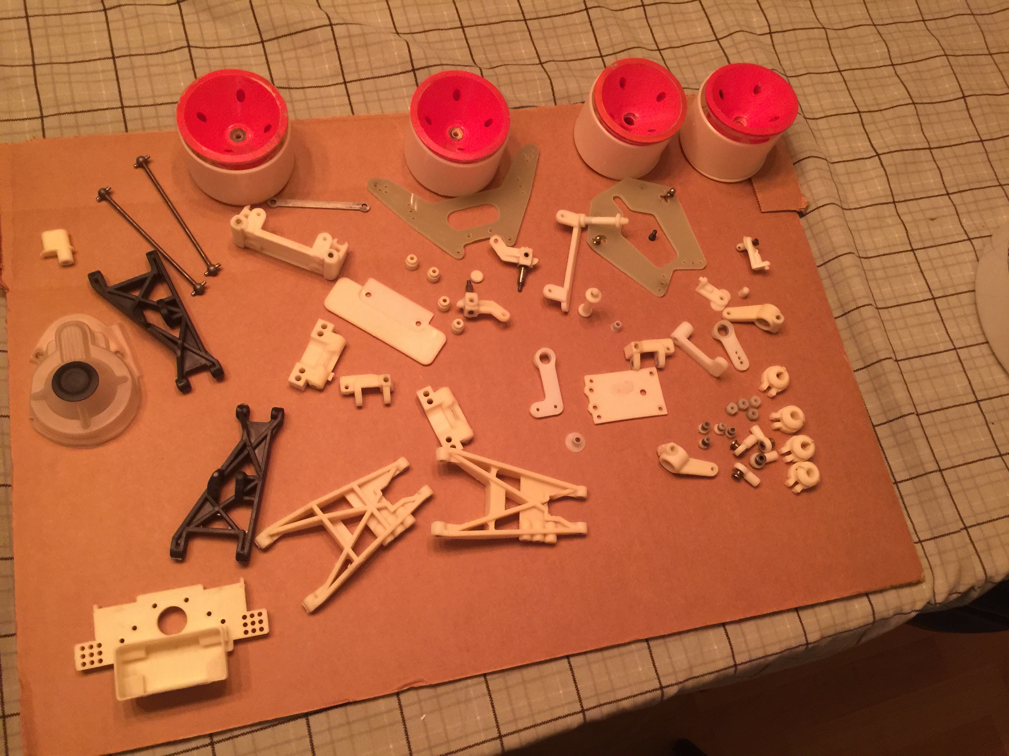

It has clearly been raced. There are a fair number of worn out parts, and a few bent turnbuckles. The best part, is the repaired gold RC10 motor plate. It was welded, ground down and painted at some point! However, the Red wheels have to go.
A couple question for the experts... What options do I have for upgrading the rear axles. I have spent several hours searching the forums and haven't found a clear answer that is still available for purchase. It seems like T4 axles might be the most likely available option?
Second, any suggestions on straightening the tub? It has a nice little kick up in the front.
Third, any suggestions on cleaning the old parts? The plan is a bath in simple green, and maybe peroxide?
Fourth, are there threaded shock bodies that would work?

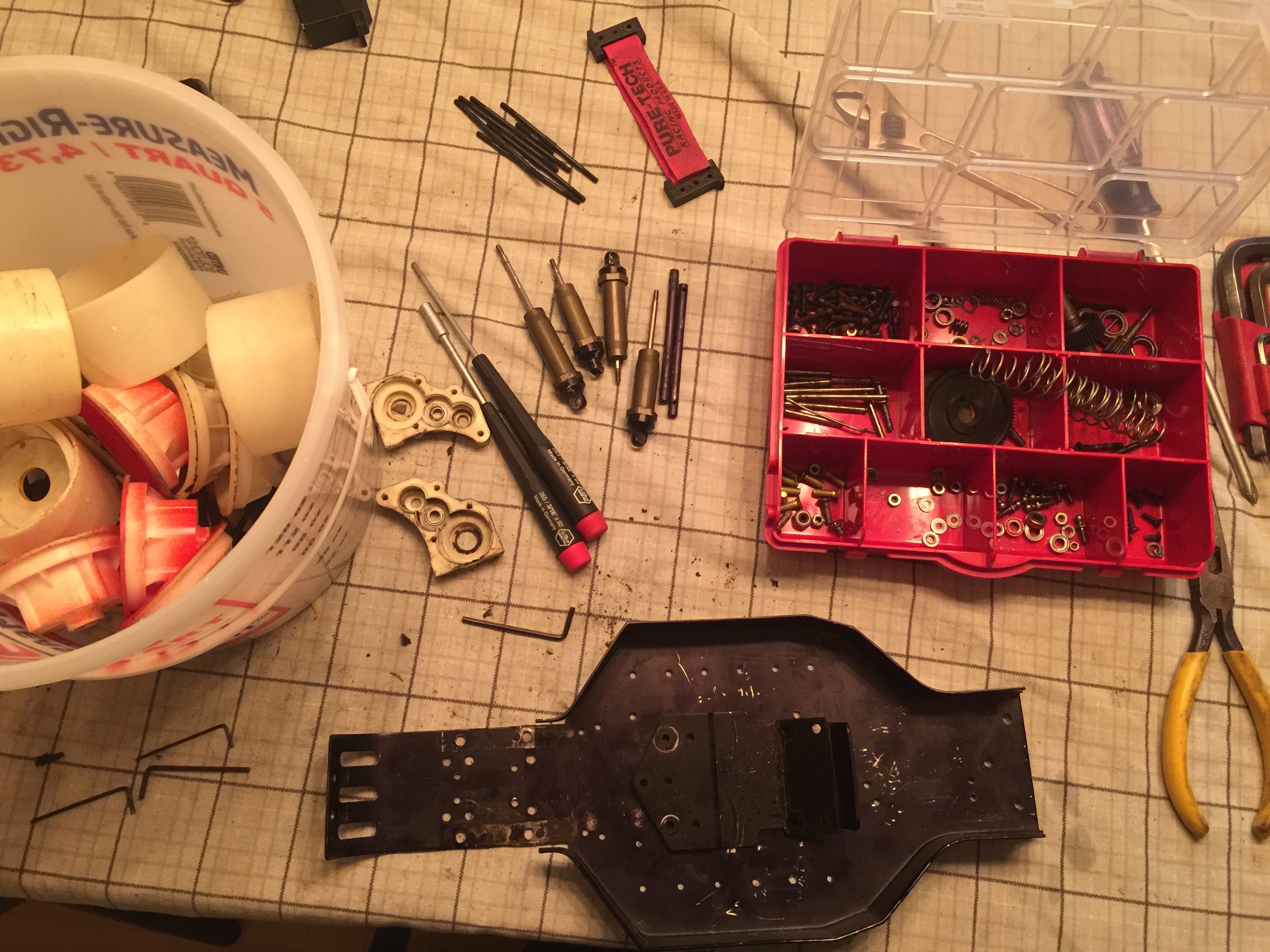

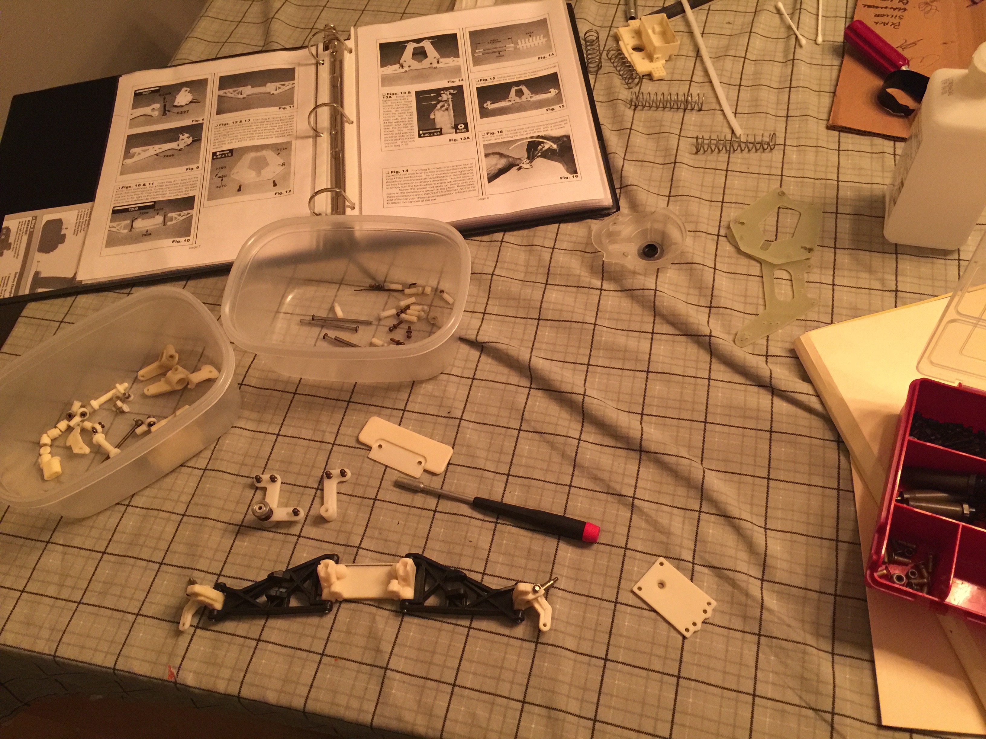

Spent some time cleaning most of the plastic parts and taking inventory. The turnbuckles are mostly bent. The ball cups are toast. And one or two of the hinge pins are bent... And a fair amount of the hardware is gone. But all the parts are there other than the dust gasket, and I straightened out the tub... So its a start. There is some weird glue substance under the rear bulkhead. The red wheels will get stripped and dyed black I think.

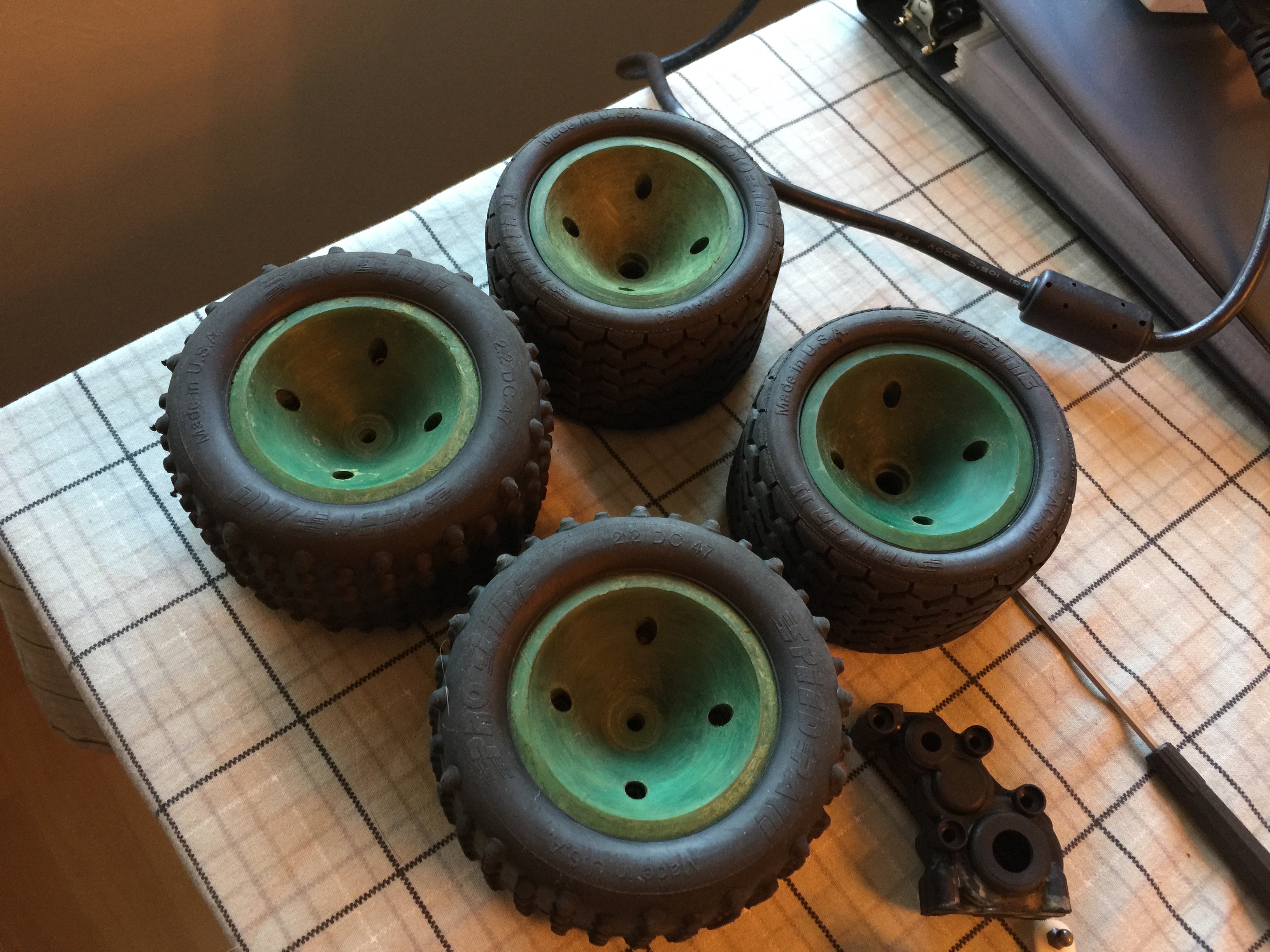

Went with my favorite color... Green for this set. They were poorly painted, and are pretty scuffed up. Now they are dyed green and will be good for the old proline strikers I have for parking lot duty.
All the parts are cleaned up and going back together. Most of the new parts are ordered. Still not sure about the T4 setup in the back... I think the Stealth will be the last thing I rebuild. This takes me back more that 25 years!

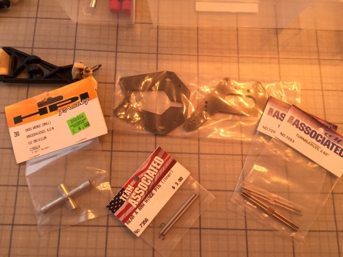

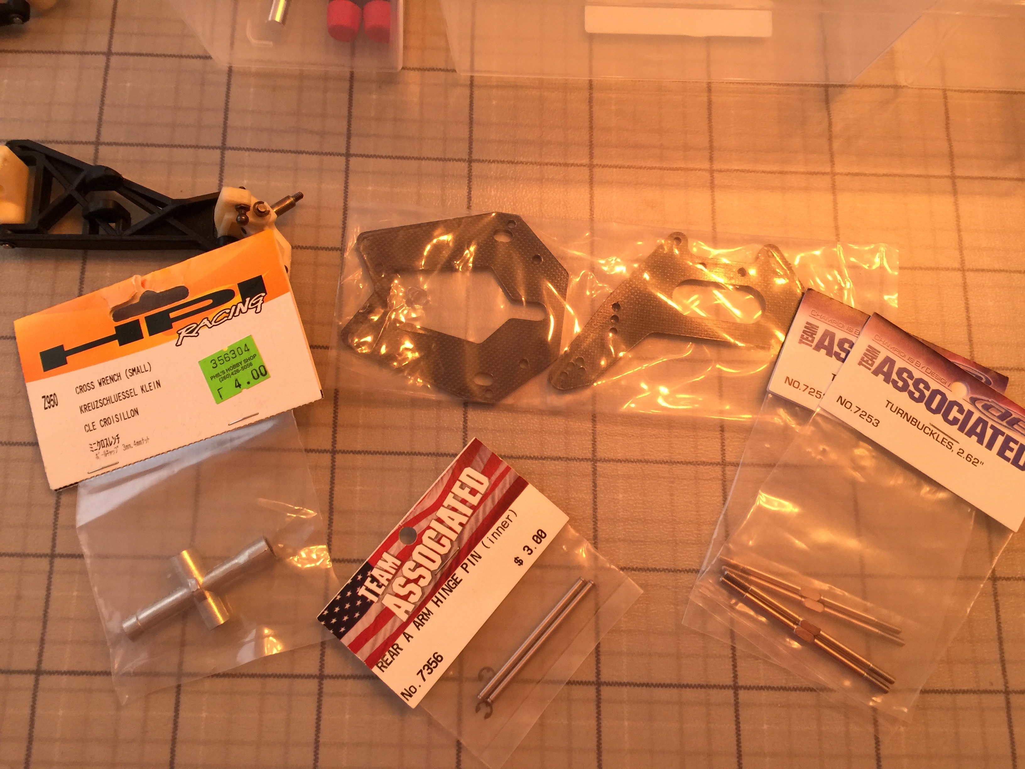

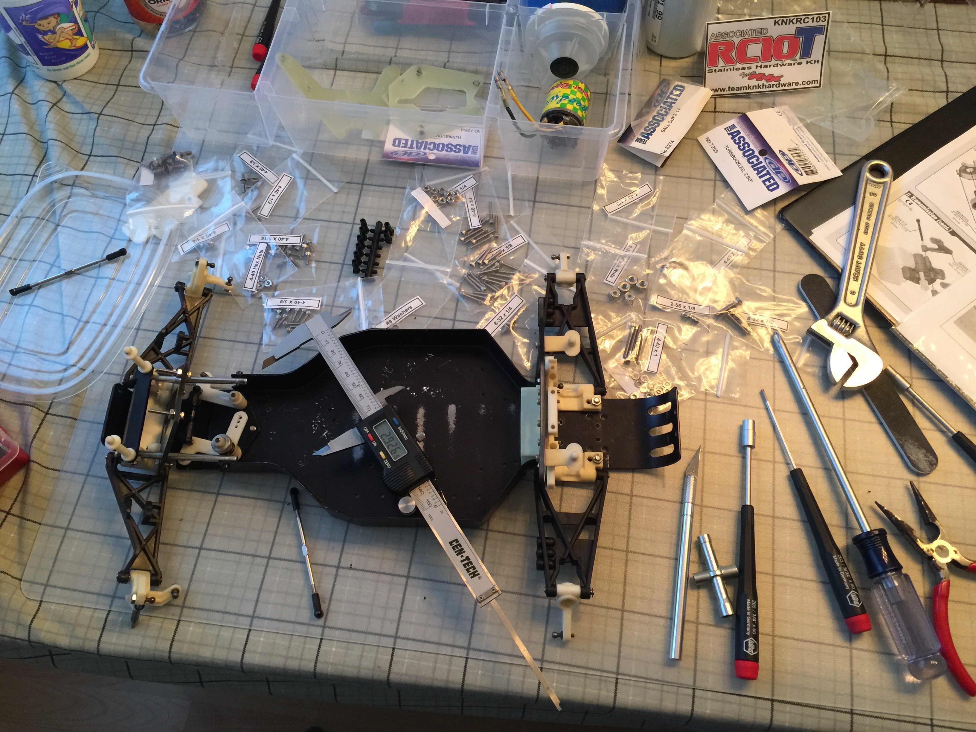

Parts are starting to show up... Still waiting on my KNK stainless hardware to get here. Just about ready to get my T4 upper and slipper, and Avid bearings are next. New motor mount is on its way too.
I had to get the carbon shock towers...
I think they came from a members company? Vintage RC
The hinge pins I reused spent some time in my drill press are are now more or less polished. I had to replace the bent rear pins.
Oh and a bunch of new tools. Picked up a cross wrench with the ball end slot, and a several whia hex and nut drivers. Love german made tools....

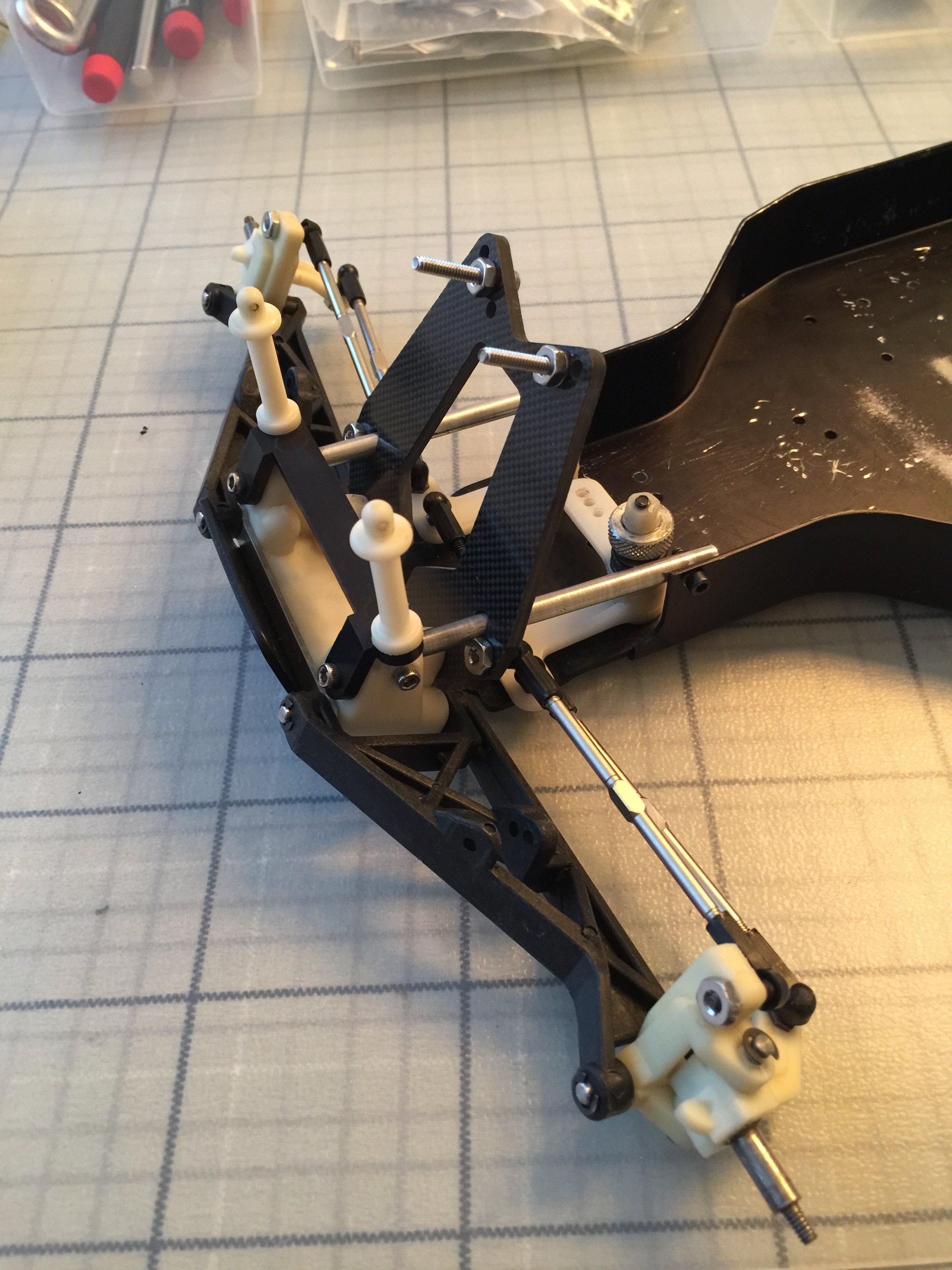

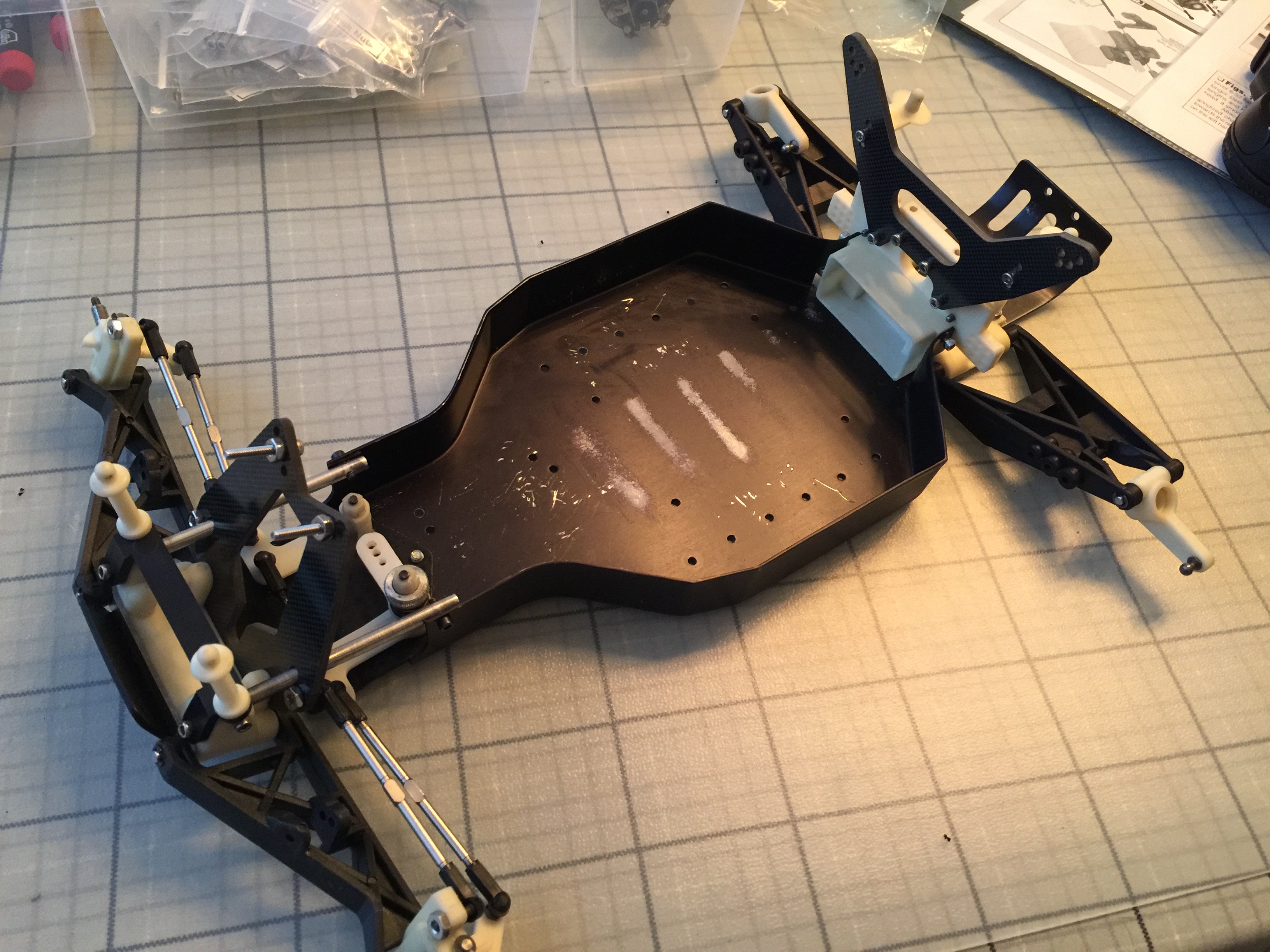

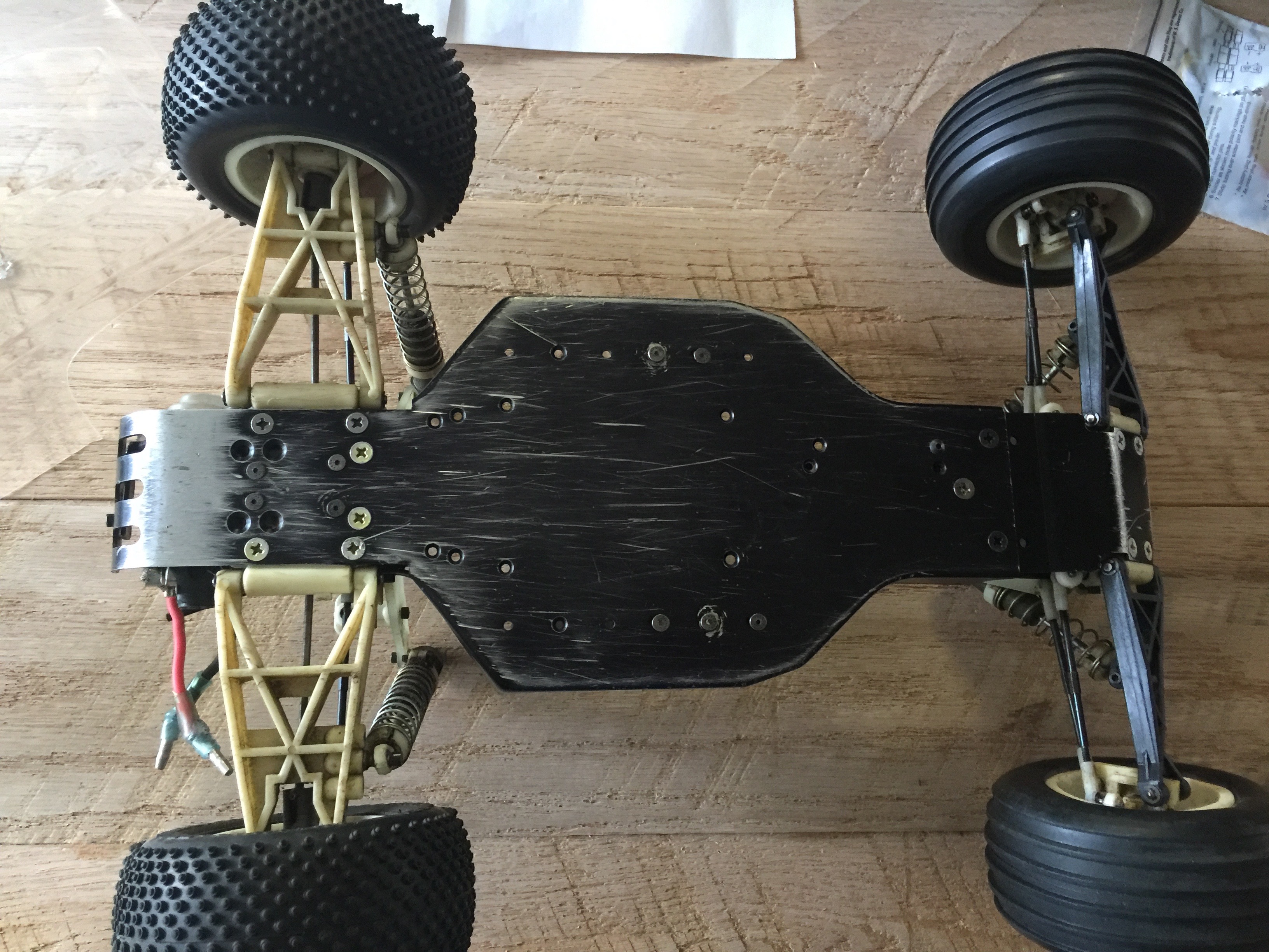

Put things together until I ran out of parts. I forgot how much fun it is to build these things. Im already looking for another one for my kids. I wish the tub was in better shape, but oh well... T4 upper shaft and slipper ordered up. Turns out one my mine was stripped so it made sense to get the slipper. It was fun trying to find my metric hex bits...
