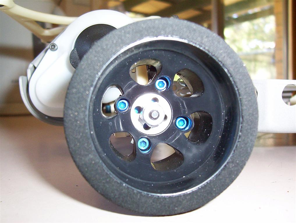

THANKS! Any change you can post more detailed pics of the wheels/adapters and how they mount? On and off the car please?
Much appreciated!

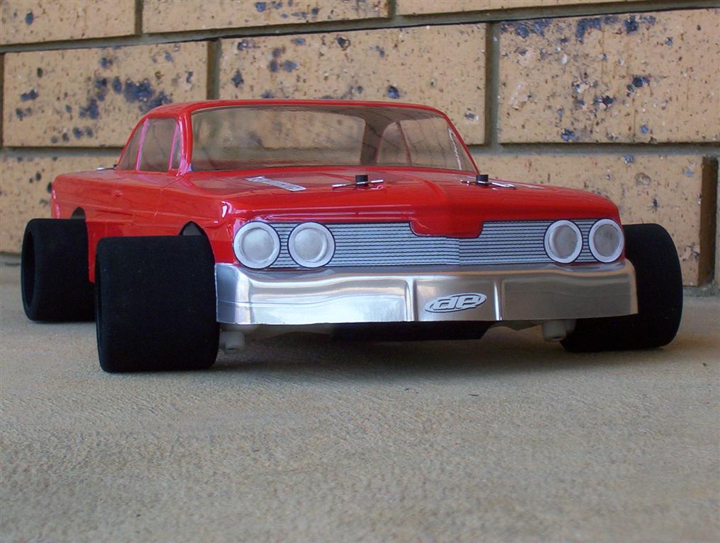

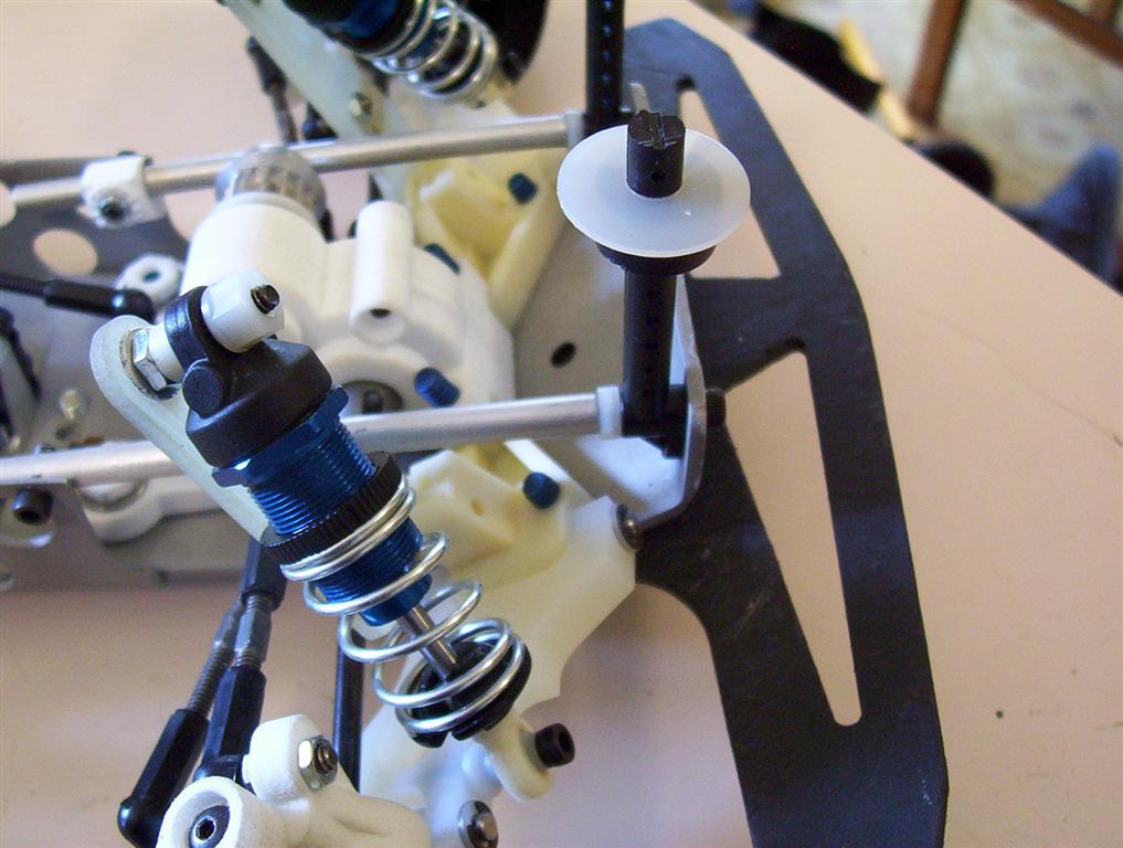

I have some more pics,
Wheel mounting and front body mounts and bumper.
The bumper I flipped over, then shortened the ends by 20mm, and re-drilled the mounting
holes to tuck it in further.
I can't remember who made the body mounts, they were from when I first put this car together.
Cheers, Dave.

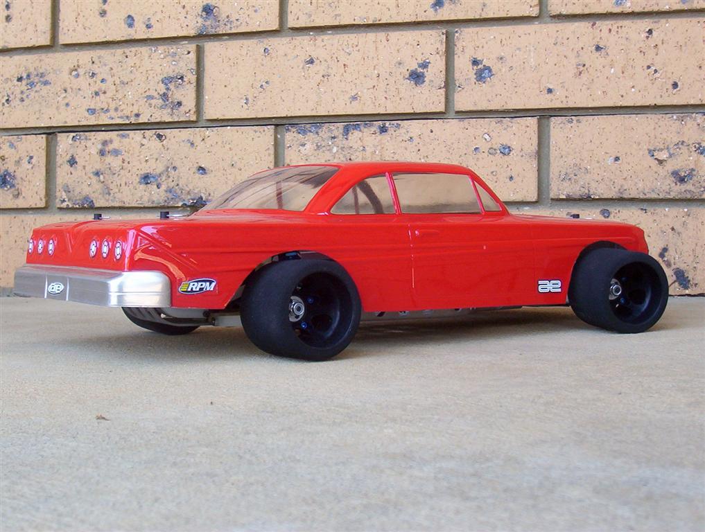

Hi Alien3t,
Thank you,
Yep, you're right Parma 61 Chevy Impala #10196.
http://www3.towerhobbies.com/cgi-bin/wti0001p?&I=LXDA46&P=7
Cheers, Dave.
