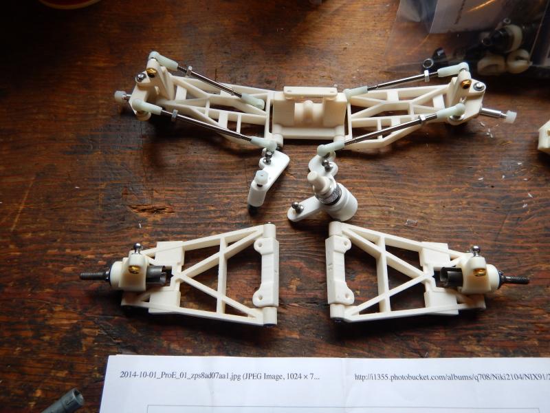

Showing the assembled suspension. The parts we dyed using boiling tea until the correct tone is reached . The steering was kept bright white. The Lunsford retro turnbuckles can still be purchased direct from Lunsford as well as Ti hinge pins but I have yet to get mine.
The center bellcrank turnbuckle calls for a 1 inch but very few threads are holding the ball cup on, so I suggest a longer turnbuckle. EDIT: 1 inch is perfect with Bellcrank link = 38.5mm centre of ball cup to centre of ball cup.

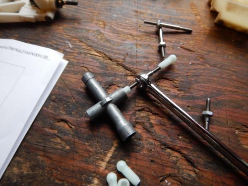

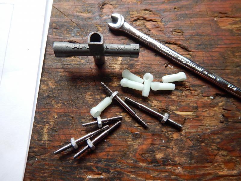

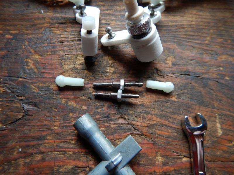

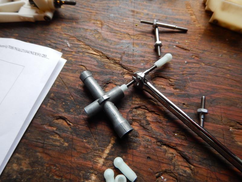

I am just using rere ballcups and they look great, but a trick that I have never seen posted on how to put small ballcups on turnbuckles, is to use the HPI 4 way wrench. It has a ballcup holder on one side and makes it easy to install without marring the cup with a pair of pliers.

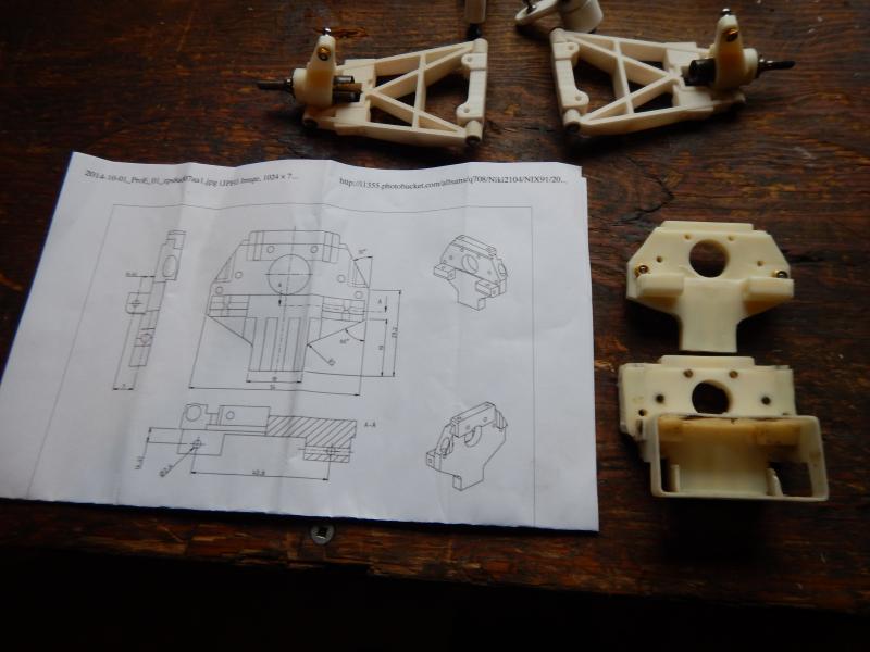

Modifying the rear bulkhead to Masami spec took quite a bit of careful cutting and grinding with a Dremel, but Cliff had a different cut than Masami.
Shown is a Masami cut rere bulkhead and a badly cut original that will make a perfect candidate for a Cliff version.

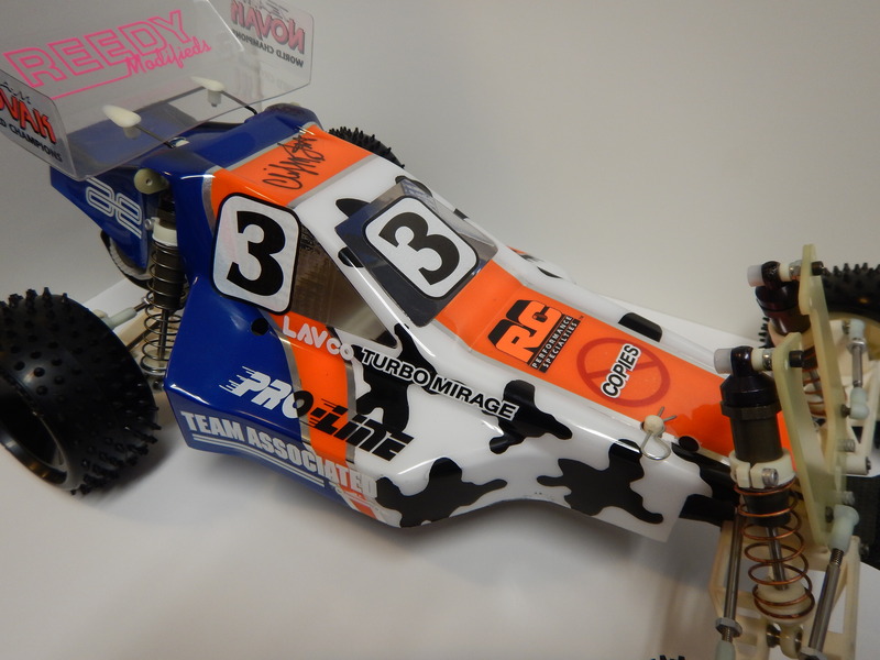

Anthony, I have enough shots of the body to get a good replica.
