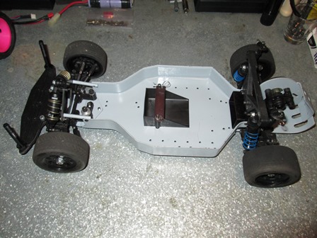

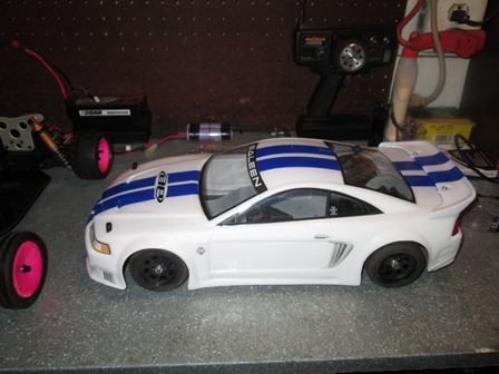

I traded a member for this DS nearly one year ago. The car appears exactly as I received it as I have not touched it since the trade. I am also working with a member on another DS trade which should arrive very soon.
I plan to make one runner and keep the other for spare parts. I have a truck load of RC10s, CEs, RC10Ts and 10Ls but this is my first DS. Fred the cat does not appear nearly as excited as I am about the build :lol:

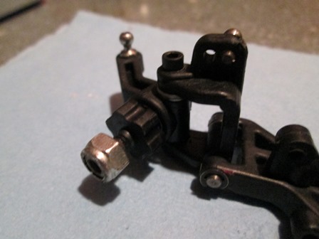

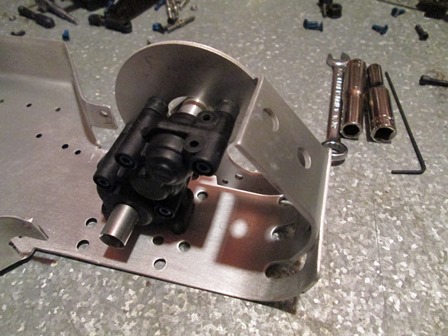

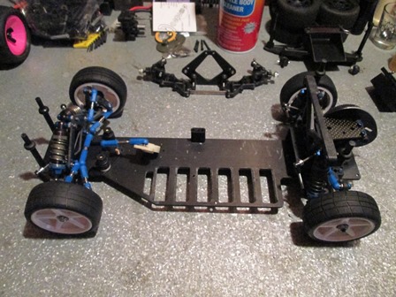

I received the second DS on trade with szac. Pretty stoked on the condition... thanks bro!
Lobo, both cars had the carriers and blocks updated to allow for HPI rims. I believe one is the SC10, not sure on the other set up. I made some progress on the chassis and will start the rebuild.
What weight oil does AE recommend? Springs? I am probably going with black all around, or black front silver back.

That's great the carriers are there, having extra choice of wheels and rubber is great. As far as the oil...i start with what associated uses in there kits...30WT...then you move from there. Springs? i like the NTC3 Silver springs, which are stiffer, but thats just personal preference.

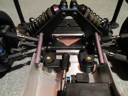

Lobo, thanks for the info re oil and springs. The shocks seemed a bit firm on the oval DS but I realized all four shocks had bladders installed. The bladders, coupled with the RPM spring retainers loading the springs made for a very stiff suspension. I will remove the bladder and probably return the original AE spring retainers if the suspension is too stiff.
I decided to sand out some scuffs on the bottom of the chassis before reassembly. I pulled out the jitterbug sander (recently returned after being on loan) and learned that it was barely functional. The pad was all but gone and the motor was trying to tear itself loose. Last time that guy borrows my tools :roll:

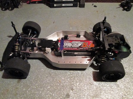

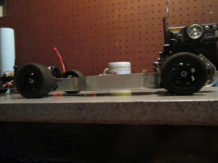

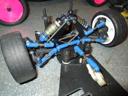

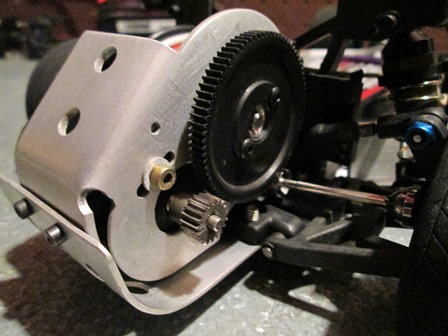

I began to reassemble the car now sitting as a roller. Not much work to do between the two cars except cleaning up the chassis.
I removed the shock bladders and the RPM shock retainers. The old style have about 1mm of clearance below the shock body when the chassis bottoms out. The suspension feels right with 30 weight oil, black front/gold rear springs.
I need to pick up crush tubes for the rear carriers. I may also try the T4 hex adapters for the rear as they appear to have a flange that rests on the bearing race. I am in the process of stealing electronics off another car and will be running soon :D

Lookin good!
but dont forget to flip your spur gear!
