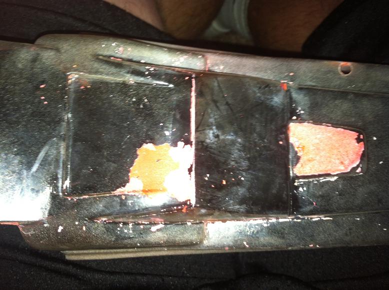

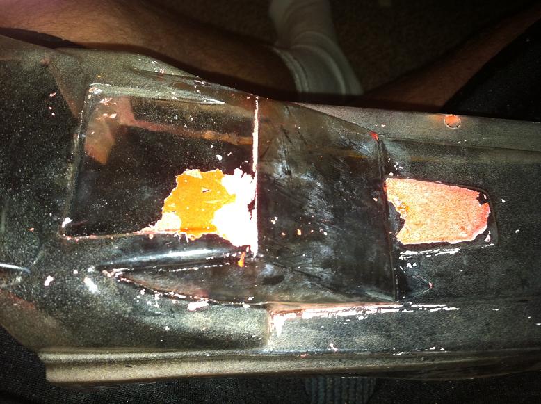

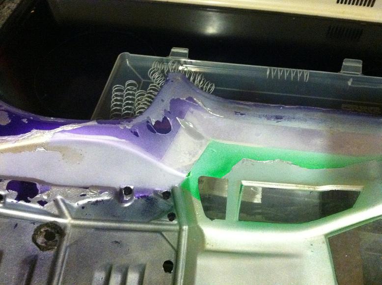

Ok I know a lot of guys have tried various methods and have come up with very mixed results. Well I wanted to try on a couple worn out bodies I was planning on throwing away.
I tried it on the body from the Rad2 that I just got, and old outrage body, and on a Short course body on my daughters slash. The trick worked on both, but worked best on the old paint on the rad2 body.
I tried easy off, brake cleaner, and dot3. Yes I know these have been tried.
The first two didn't work. The dot3 didn't work...........at First.
I coated the rad2 body with dot3 brake fluid (just cheap generic stuff) and I used a foam brush to spread it evenly on the entire body both inside and out. I spread new on every hour for half a day and didn't see any progress. I got busy with other stuff and set the body in a tupperware box with a lid half on and set it outside on the back deck and forgot about it. I went and grabbed it tonight (6 days later) and to my surprise I could peel the pain off with my fingers. I pulled several layers of paint off and then used my nail to scrap more off. To my surprise there wasn't any hazing of the body. It looks hazy, but it's overspray on the inside which I verified by scraping it off with my nail.
Anyway I tried it on the short course body and it did the same trick although didn't work quite as well. It didn't damage the body at all, but it will take a litle bit more effort to get it off. The body will be saved though which is great.
I also was cleaning my race truck body today with some simple green straight out of the bottle without diluting it. I had too leave and go help my wife when her car broke down. Came home about an hour later and the paint had peeled on the inside of the body. I know the paint was Parma Faskolor and it was about two years old. Came up easy. I tried it on another body that I screwed up painting and it did the same thing.
So if you use faskolor paint, simple green works amazing. If an older body, dot3 that soaks for a week works pretty well also.

I let the brake fluid soak for 6 days. I used dot3 since dot4 seems too leave things very hazy and brittle.
I was very surprised by the simple clean. I've always used simple green to clean my tires and the truck in general. I was trying to clean the body on my Blitz that I had just sold and wanted too make sure it was all clean.
I am trying my daughters slash body now. It has new tamiya paint backed with pactra that was for the flames. We will see how that one goes.

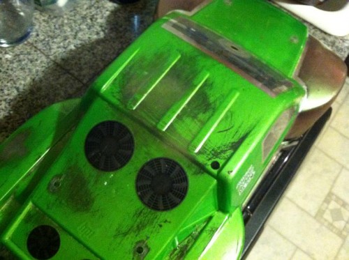

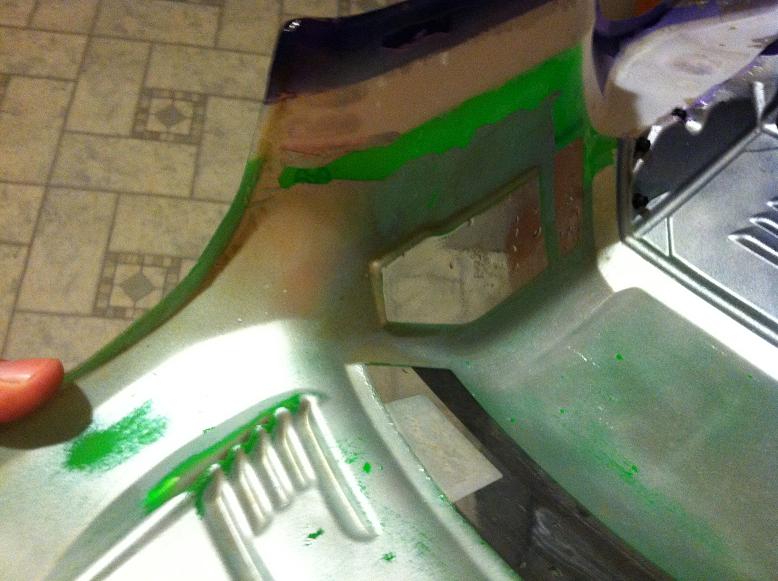

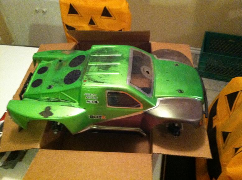

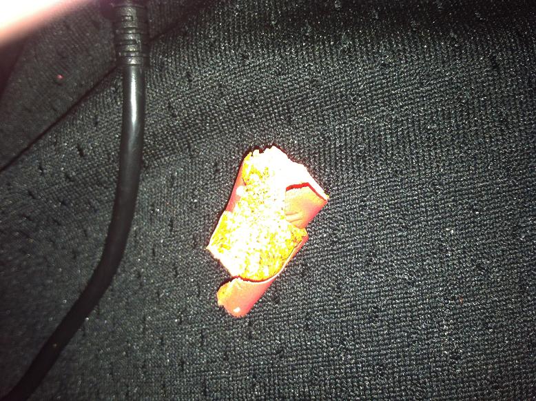

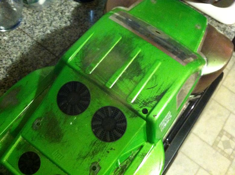

Well I can tell you that simple green straight from the bottle without being diluted will strip it with ease a couple years later.
I don't know what paint was used with this body, but it looks like the same shade of pactra that I use too use. Simple green allowed to soak for an hour and a plastic bristle brush used for cleaning and it started coming off. This is my blitz body with all faskolor and faslucent paints that is two years old.
You can see the paint peeling off.
