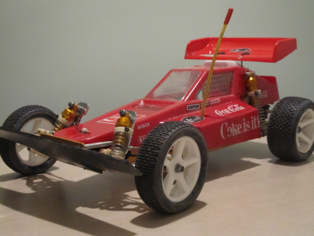

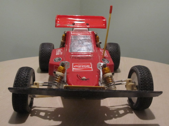

I have a Cadillac circa 1984 that I used to race back in the day while my dad raced an Optima Mid.
We raced for a few years and collected some trophies and had a lot of fun.
It was well used as can be seen in the pics.
I finally got it running again and now it's time to decide what to do with it.
To get it running again here is what i did.
Complete dis-assembly and cleaning (maybe not as clean as it should be)
Rebuilt shocks
Rebuilt tranny
New aluminum shock towers
New speedgems ruby motor (19t I think?)
new 4600 mah NIMH batteries
JC Racing wheels with JConcepts bar codes
2.4ghz transmitter/receiver
I really can't gauge how competitive this setup would be today. I am considering going to a brushless setup but I am very confused as to what I need to do to get there. For every post that says I can use the 6 gear tranny there is another one that says no. I am also having a hard time figuring out what speed motor to get...9T, 10T, 13T...3000kv, 3900kv, 4300kv and on and on.
I'm not sure yet what the classes are at the track I'll be going to. It seems like you pick either buggy or short course truck and start racing. It is an indoor hard packed clay surface with some pretty big jumps. One is a double where you better clear the second or slow down for the first.
Given the condition of the car I don't mind making modifications, although I'm not into machining parts to get them to work. They must be bolt on and at the very worst simply drilling holes in the chassis.
I would appreciate any help i can get.
Thanks,
Bill
