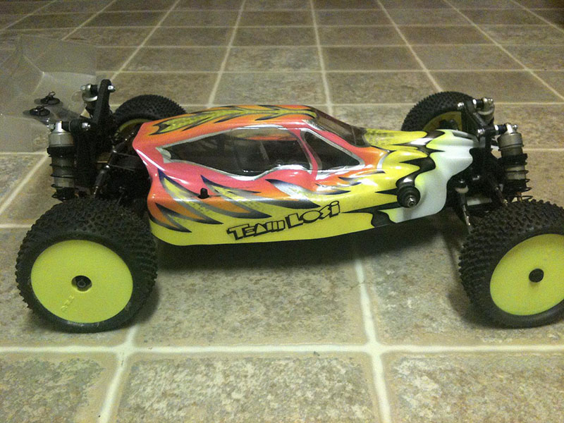

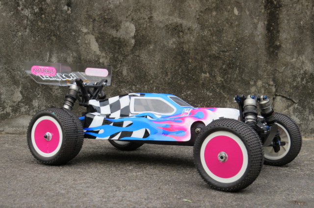

This XX4 is what I intend on being my "runner" - using a 1st gen chassis - pretty happy with it - it will get a tekin rs pro combo - maybe 7.5 ?

very trick lookin xx4, always a fan of 2-tone wheels as well!

Thanks Proffesso - this is a work in progress mate - it has been tinkered with abit - and hopefully with imput from fellow members - sort this buggy out into a good runner.
I am by no means a racer - I had a hotshot in 87 ( bought 2nd hand from the neighbourhood rich kid ) - drove it into the ground - shelved it and got into bmx and surfing . I got back into rc by chance - went to a rc shop with my brother in law - he's big on planes - spotted a rere hotshot and had to have it - that was 2007 I think .
I've built this to do the odd club night with , should be fun !

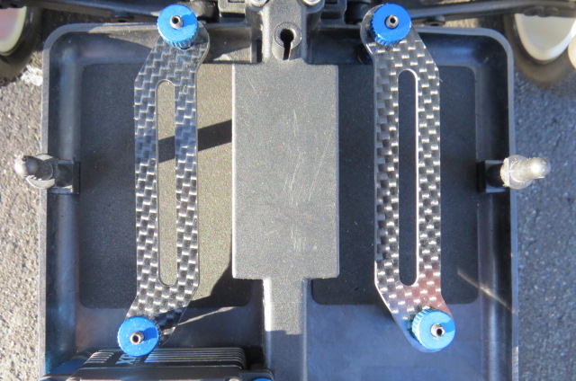

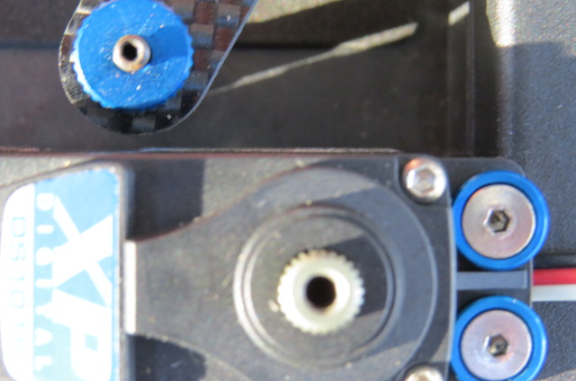

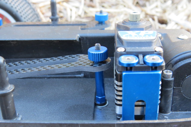

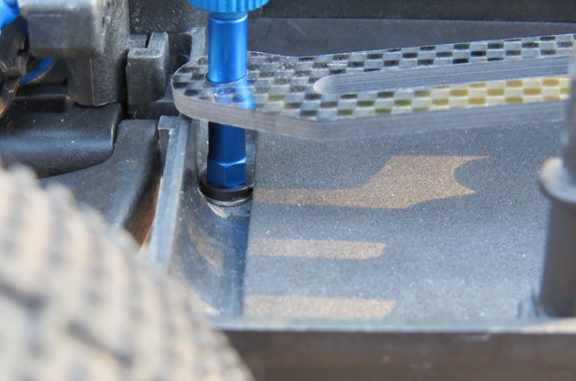

Here are a couple pics of my saddlepack lipo conversion - I recessed the rear post into the curve of the chassis , to gain as much space between the battery brace and the steering servo which ended up being only approx 2mm . Under each post is a stainless steel washer and a cr hub spacer - with new battery pads fitted.
The conv. was done without a dremel - never again! Promptly went and bought 1 .

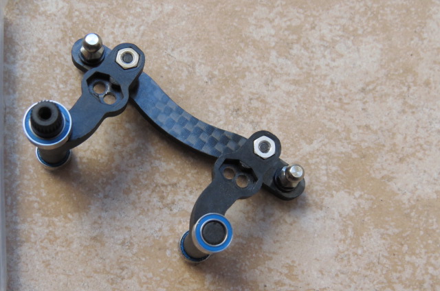

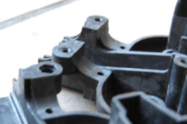

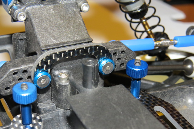

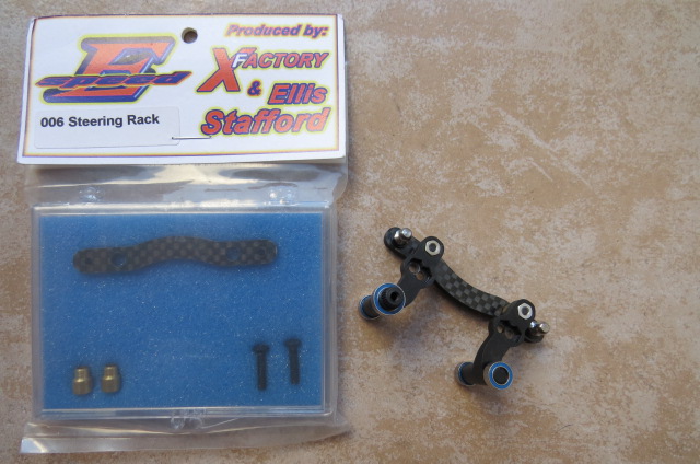

Glad I bought the dremel , fitting the Espeed steering rack required cleaning up around the steering tunnel - the rack was catching on the chassis slightly. You can see from the pics how much material was needed for removal - very happy with this mod - HG ballstuds are fitted

Nice rack!!Cra$h wrote:Glad I bought the dremel , fitting the Espeed steering rack required cleaning up around the steering tunnel - the rack was catching on the chassis slightly. You can see from the pics how much material was needed for removal - very happy with this mod - HG ballstuds are fitted

Great to see another XX4 being put into action,love the battery mod you did,too-super clean,man.

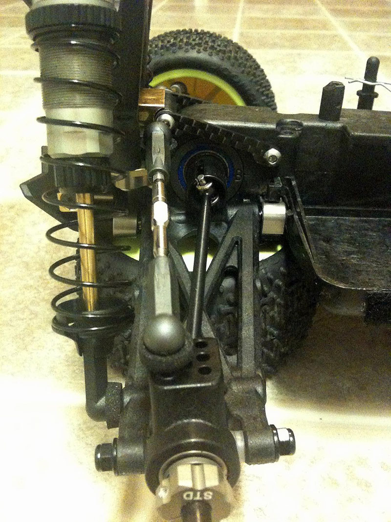

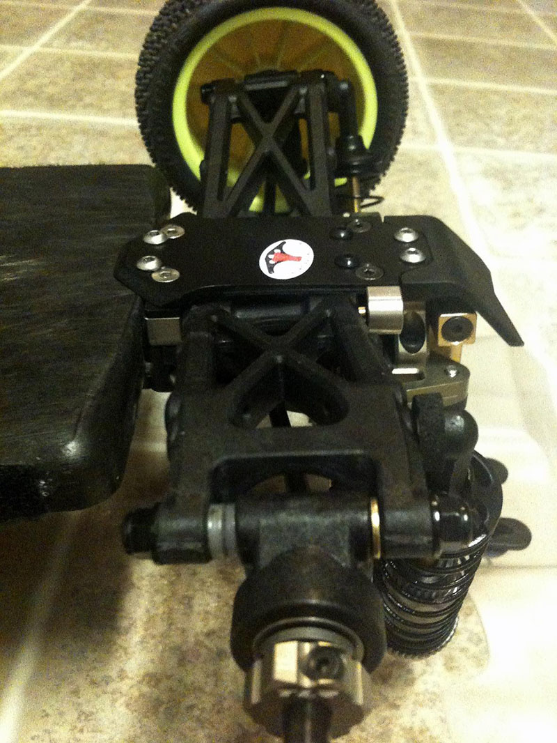

Anyone see the guy who fitted an entire Twenty Two rear end to his XX4?
(I hope he doesn't mind me posting these photos
Best handling buggy ever,I've vowed to never be without a XX4 runner and a shelfer...or two.
Let us know how she drives with the mods!

That is 1 super cool mod there !

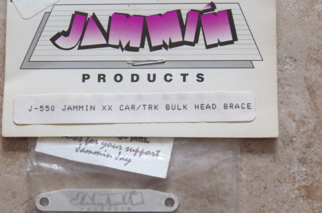

Found this in the parts bin at my lhs - asked the owner what else he had hidden - he reckon's some alloy versions as well - going for a dig next week. Very happy just finding these .

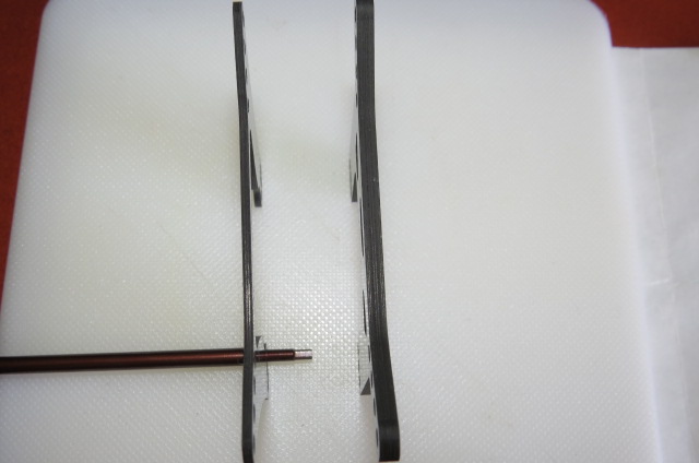

I'm using the E speed carbon shock tower and chassis braces on my runner XX4 .
There much thicker than the penguin items . I don't know if there still available - but I did purchase the penguin rc kit direct from them only a few months ago.

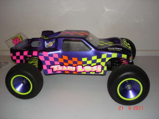

Just to mix it up abit . Here's a pic of a new built XXT CR that I sold to my mate .
Checks and side motif are painted - jammin towers , mip , trinity etc .
Shouldn't of sold it - but it's gone to a good home
