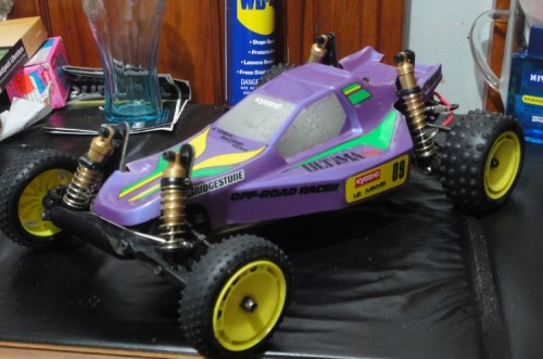

Well since i'm waiting on parts for my Mid & others I decided to finish my Ultima Pro.
A set of CRP front axles to accept Tamiya wheels have added along with a set of Yokomo adaptors at the rear. I found a set of Tamiya spoke wheels that compliment the rear J.C 5 spoke wheels. I quickly dyed the wheels too match up in color. Added a few stickers that were missing to make it almost box art. Li po saddle packs fitted with the original 14X2 mega motor.
Seems to be going really well & will give it a run at Boondal next.

Its looks real nice, a real contender! 8)

I don't think I 've ever seen those front wheels. Real good of you finding something distinctive AND matching

Looking Sharp
