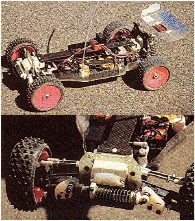

Hi, guys,
I present you a new replica car, I'm at the beginning:
Handmade parts: chassis carbon,upper deck carbon,front monoshock mount
front and rear shock tower.
RCPS parts are on: turnbuckle, servo saver brace.
I must place the receiver with the small battery, the novak esc and the Reedy motor.
Now I search the cotation of the blue rear arm from the World.and the material used any idea ?
For this one, I search again a PS 87 Fet KO servo, and the 330S front tires, and the 8185 white RC10L body mount.
For the green shock (gold anodized in green) I don't know, maybe some one have try ?

Really nice start! I have always thought that front monoshock mounts were fiberglass but obviously that can not even be possible, since there needs to be so much offset from front arms.
What are those front wheel adapetrs?
Is the rear end going to be similar than there was in Masami's car with e.g. RC10 rear hubs?

Hi ,
The front hub are machined.
The carbon chassis have the 4 cells more in the center of the car and a bit forward.
For the rear arm I need sheet of PA6 blue Nylon Nylatron, and use with the RC10 rear hubs.
Below the pic from the world:
