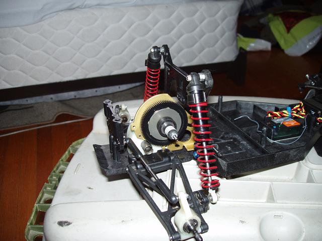

Re: RPM 2.65 trans using B4 slipper.
Here's a pic of what I've done to make it work. IIRC, I used that Losi thrust "cup" thingamajig just to take up space on the top shaft. The thicker Losi slipper spacer has a shoulder that prevents it from sliding all the way down to the slipper hub.... I think... I don't have the transmission in front of me and it's been a few years since I assembled it. I had also roughly machined down the flats to allow the slipper hubs to slide back to the same position on the top shaft as the B4 top shaft. Mine was a bit of a hack job since I think I may have done that when I was a bit younger and didn't have the steady hand I do now. I'm sure you'd be able to make a good job of it with some time and patience.
Hope that helps!
Hope that helps!
Thanks Adam! I did discover this:
http://www.ebay.com/itm/LOSA3124-Losi-Spring-Cup-Spacer-and-Washer-/320766654354?pt=Radio_Control_Parts_Accessories&hash=item4aaf2eb792
What outer slipper plate is that?
It might be a Losi plate but it could also be an Associated plate, I'm pretty sure they're almost identical except for the shade of anodizing. That link has exactly the parts I used minus an actual thrust bearing (not needed, not even sure why I used it in the first place...). LTO Dave's got that set for sale in the BST too
likw this, i think the owner is also a member here ( sorry just posted ot just for reference).
THAT'S where that picture is! I couldn't find it on my computer for some reason, thanks slow jun!slow_jun wrote:likw this, i think the owner is also a member here ( sorry just posted ot just for reference).
