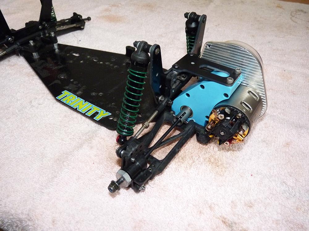

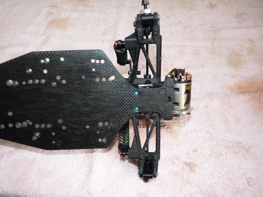

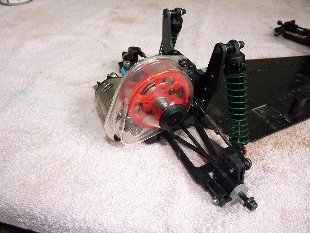

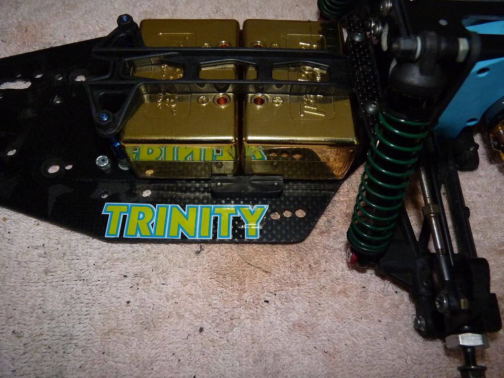

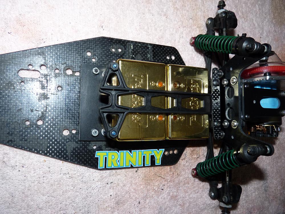

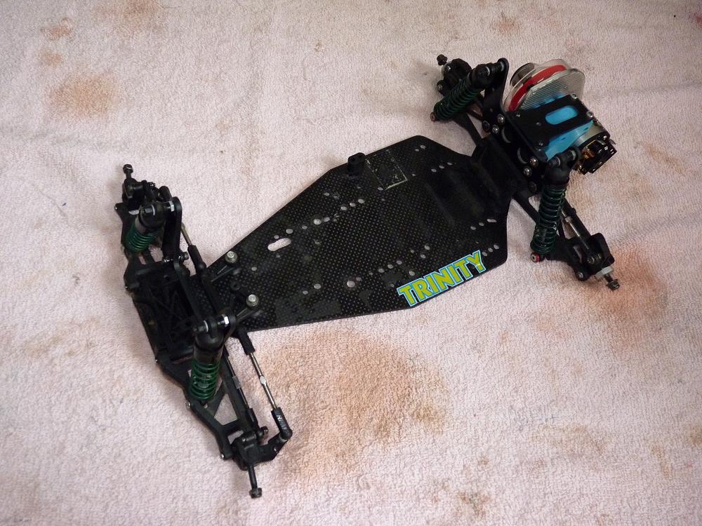

I've had this chassis for more than 15 years. I bought it from a fellow racer who had upgraded the gears to 48p as well as Pro XL front arms and Triumph rear arms. I forget exactly how it looked back then but here is how it looks now. I finally got my hands on a Lethal Weapon II from Daryl (thanks for finally giving me the option to have a great differential in my Ultima!), I came across the shock towers at some point in the last 10 years, don't ask me where or how though :lol: MIP hard shock bodies (.71 up front, 1.32 in the rear), MIP ballcranks are on there now but I've got a set of the blue Kyosho bellcranks on the way (thanks jamin!). Not only did I steal RC10 shocks for my build, I also stole the rear chassis shape to mimic Masami's worlds chassis. That part of the chassis is totally unused and gets in the way of the arms when you run more than normal droop. I forget who makes the spur, I put it on because it just looks right for the time frame. I secured the LiPo's with a left over T4 battery strap (shortened), a chunk of 3mm Team Cobra graphite plate and a broken then cut-in-half Kyosho Lazer shock tower mount. Strangely enough the conglomerate of parts worked out really well.
Anyhow, here are the pics :mrgreen: 8)

Your spur is a parma item. The one I got came with a little tree with neon green spur-adapters for the JRx-2, optima mid and ??? I've seen some recntly in a LHS, but think they were 64dp and didn't seem to contain those adapters anymore.
Personally I find the slipper unit on the A&L a larger advantage than it's ball-diff. Probably 'cause I prefer geardiffs :mrgreen:

The advantage of the slipper goes without saying! I'm not the biggest fan of gears diffs that can't be sealed in order to fill them with silicone, I just find them tricky to work with.
