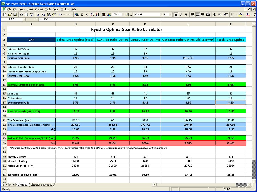

I found some useful RC gear ratio/rollout ratio calculators and even a speed estimator on this website:
http://www.scriptasylum.com/rc_speed/rollout_ratio.html
When I enter 3.0 as my internal gear ratio and my other knowns (3.425" tire diameter, 11T pinion, 41T spur), I got a rollout ratio of 0.96--which is apparently almost perfect (1.0 being ideal).
I re-calculated with the smaller 2.52" tire diameter, blanked the pinion box, the resulting pinion calculation was 14.92...so my half-assed guess using percentage of height difference was pretty close. A 16T pinion gives a rollout ratio of 1.03.

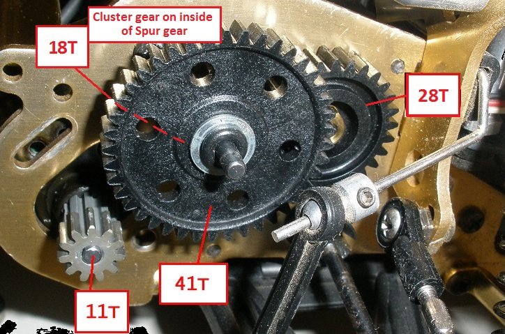

This is an old topic but the question was never answered as to how the Optima 3.03 internal gear ratio is calculated. I've since figured it out and will update this topic in case anybody else has the same question. Here's the math:
Gearbox gear ratio = 37T diff gear / 19T final pinion = 1.555
External gear ratio = 28T counter or limiter gear / 18T cluster* gear = 1.947
The smaller gear on the inside of the stock Optima spur gear is the cluster gear, which meshes with the counter gear; a.k.a. the limiter gear if it's a Turbo Optima.
1.555 x 1.947 = 3.03 (rounded up from 3.0276)
The Optima was sold with 12T and 15T pinion gears. Final gear ratios (as shown right on the Optima box) are as follows:
(Spur gear / Pinion gear) x 3.03
12T pinion: 41 / 12 = 3.42 x 3.03 = 10.35
15T pinion: 41 / 15 = 2.73 x 3.03 = 8.28
Those 2 numbers match what's printed on the Optima box. Updated my image for clarification. (Note that the pic shows an 11T pinion, not the stock 12T or 15T.)

Yes Brian, that's about it. For most people, knowing your FDR and rollout ratio isn't really important, but when you're custom-building a car that's a long way from stock--i.e. CYANide or Barney--the different sizes of the tires, much higher power of the modern electrics, and so forth make these calculations very important. You want to end up with a rollout and FDR that are close to 1:1, ideally. I'm putting together a spreadsheet to make the calculations as easy as inputting some numbers, I can then take a screenshot of it and if anybody wants it, I'll email them the spreadsheet. It would work for any car, as long as you know the variables. It will help you choose the best pinion and/or spur gear just by playing with some numbers. I've seen some online calculators but the explanations are unnecessarily confusing and you can't usually tell what the formulas are behind the results.

Anybody here have the stock Optima Mid internal gears and can update me on exactly how many teeth they have? I'd appreciate that, and update my spreadsheet I've been working on the past few days.
