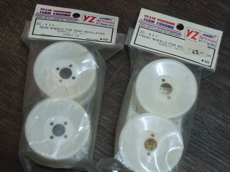

yokomo made ZC-835 2.2" deep offset wheels and ZC-831 front 2.2" as well.
I'm using them on my 834B. but it was not easy to find them.
and you can try 2.15" ROAR wheels ZC-821 and deep offset ZC-825
870C needs deep offset wheels on the front too. but your 870C has thick wheel hubs in the picture. so you don't care about the offset. 8)

59burst wrote:yokomo made ZC-835 2.2" deep offset wheels and ZC-831 front 2.2" as well.
Thank you Sir but like you say difficult wheel to find.

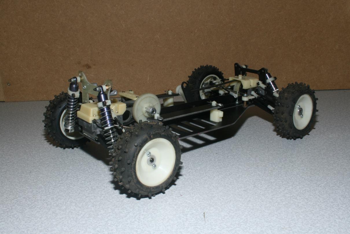

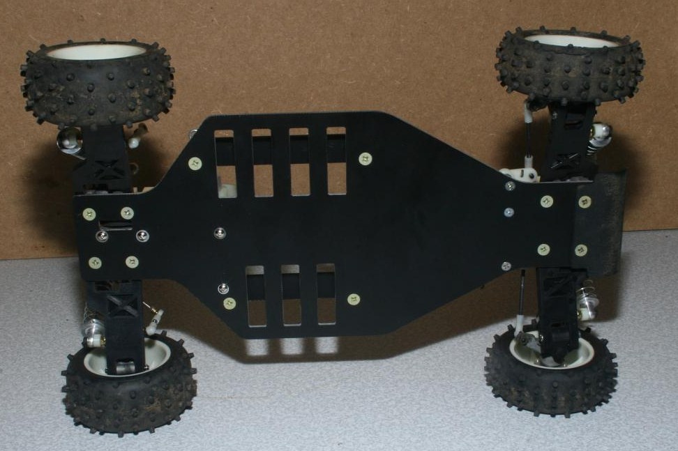

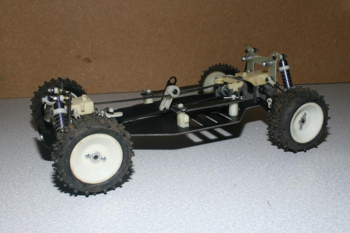

So this is what landed, great condition and seems to be hardly used, anyway it's going to make a great UK Vonats style racer 8)
So is this the answer, I don't want to be dropping $120 if there's a better/easier/cheaper way :wink:

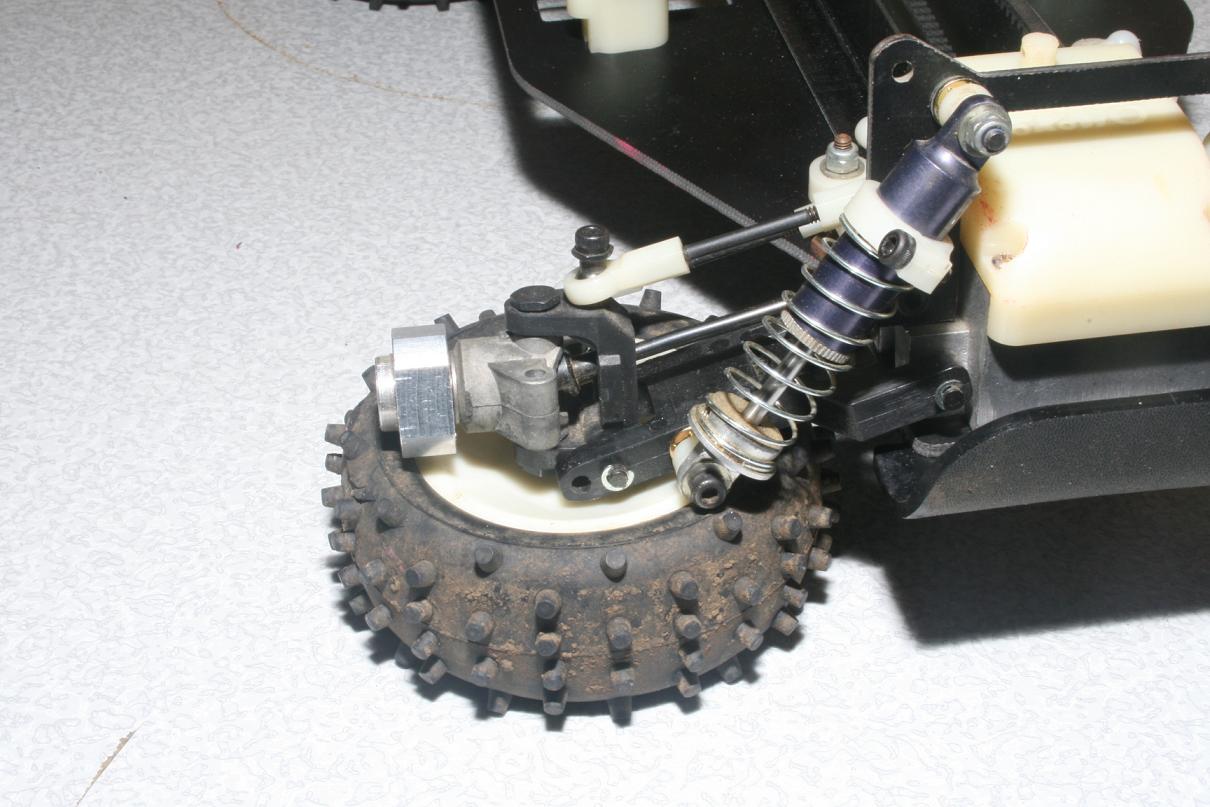

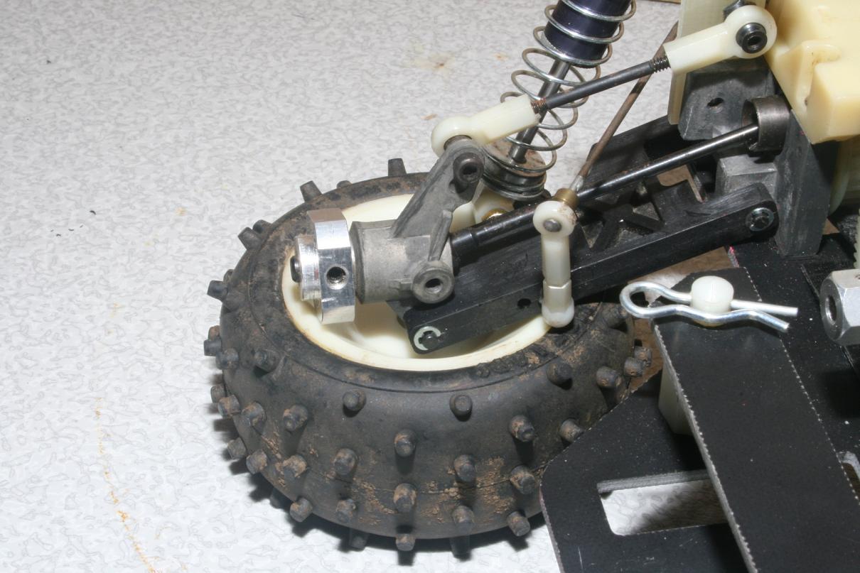

widening the front end is is easy if you have the wide front suspension kit. you move the castor block to the outer hole to make room for longer universal, then use the 6mm hub from the original setup instead of the 2mm hub that comes in the wide suspension kit.
the rear is a different story. i was lucky enough to get a pair of the 30 series 2.2 rear rims with the deep offset. but i was planning on having longer rear arms made so i could use the long universals on the back. i still would've had to make some sort of spacer to push the rim out, put it wouldn't have had to be as wide.
