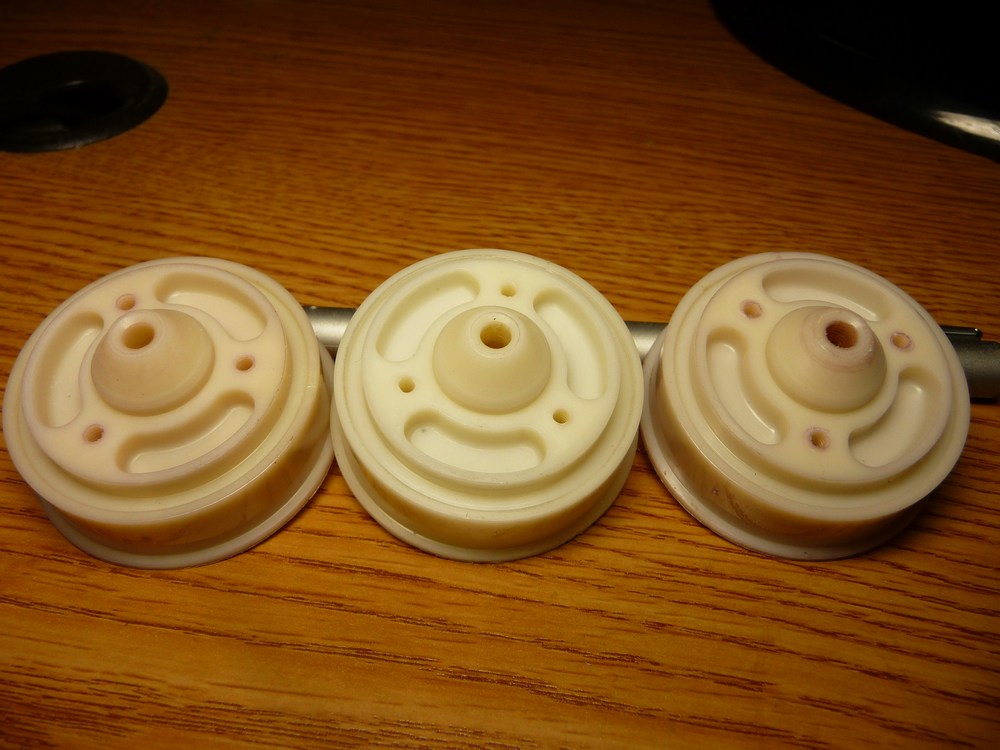

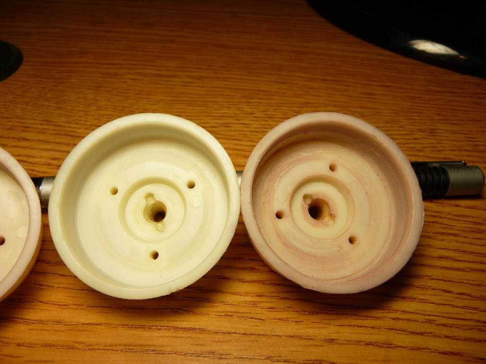

One quick comment on Purple Power. I cleaned some rc10 rims in it an it did a fantasticc job of removing the paint. What I didn't expect was that it also actually impregnated the nylon with the purple dye to some extent. These wheels were pretty beat up so no great loss. Here's what they look like next to a "white" wheel.
Gary

that rim was dyed the super clean wont change the color. I soaked this whole car in it. everything is nice and white
